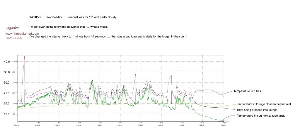

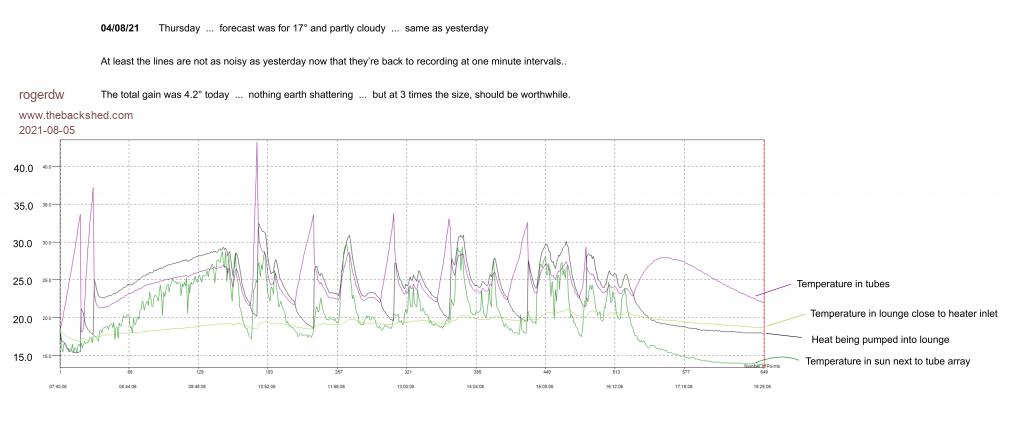

Looks like it was a bad idea to change the recording interval from 1 minute to 10 seconds  ...  so I've changed it back for tomorrow.
The logger in the sun chops and changes so much that there's an awful lot of noise and it's hard to make any sense of the rest.
Otherwise it wasn't a bad day.
This was the idea I suggested the other day to get the air to swirl around as it exits the tube. Probably not worthwhile but at least not too hard to do.

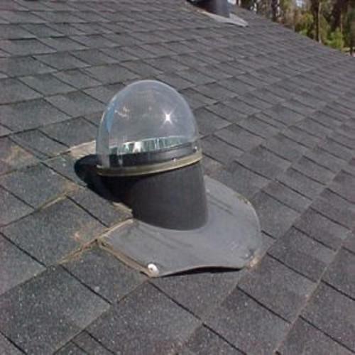

  Quote  The only thing I haven't worked out yet are what I'll use to feed the duct through the roof.
I think you should be able to buy a kit to feed a flue from a wood heater through a tiled roof. The outer most skin of that may be large enough.
Another random thought, I have seen small round skylights advertised that pipe sunlight down through a reflective tube. Some of the hardware for that might work.

More results from today.
Certainly better with one minute recording intervals rather than 10 second.
Cheers,  Roger
