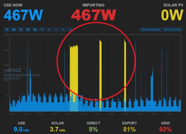

so what else can we tell from the boring ol data.
Well quite a lot as it happens.
As you will recall the yellow is measuring the water heater and no hot water was used this day. we can see a 2.4 kwh charge followed by two 700 watt boosts EXACTLY 210 minutes after the first one finishes.
some simple arithmetic tells me this heater is losing 9 degrees C over a 24 hour period and it is losing 200 watts per hour from midnight til morning and less than 100 watts per hour during the day.
so how are we going to improve it.
first item is distribution, there is a 24 meter uninsulated copper pipe going to the bathroom, the temperature of the water drops massively.
The second is to insulate the inlet pipe there is about 1.5 meters of pipe that is exposed and it feels like it is 60+ degrees. The tank has already had the original insulation replaced with rockwool and it sits on an insulated plinth that saved around 2.3 kwh when we did that upgrade. We have got some polyurethane insulating sheets we may even box the heater in with that as the rockwool is a little tight for perfect insulation value.
We done some decanting of hot water at the kitchen and at the bathroom and measured a few temperatures
At the kitchen tap it takes 0.67kwh to deliver 25 litres of hot water and at the shower it takes 2kwh to deliver the same amount at the same temperature.
If we can get the bathroom water temperature high enough then it might be possible to wind the thermostat back, that would save a lot of energy because the temperature differential inside and outside the tank would be lower.Edited by yahoo2 2018-05-01
Ummm.....
Midnight to 6 ? Am = 1200W, 6-6 = 1200W so your heater would be loosing 2.4Kw of heat just sitting there?
Substantial!
When I put the water heater on the Voltage monitor so it heats through the day the rest of the family said the water got hotter. I dismissed this at first although realised they were right. Your figures would seem to bear it out. We all tend to shower at night so the water may have been heating n hour or 2 before we used it.
With the off peak, it would have stopped heating closer to 18 hours before. that could have made a significant enough difference to notice as we did.
Does not change the losses or the energy input, just the water is used soon after it has been heated reducing the cooling in the tank.
As thermal losses are larger with more temp differential, it may turn out to be fractional more efficient this way. The water in the tank after we shower is cooler so the differential and the amount of heat loss may be less with the cooler water.
Wow. If you weighed what that pipe and then looked at the BTU required to heat it to the temp of the water, I think you'd see some substantial heat loss.
My heater is no where near that far from the kitchen sink but it still takes a good while to get to the tap. I was wanting to install a little 25L heater under the sink but everyone told me wouldn't be worth it. Maybe not but all that cold water irritates me. I'd do it but Mrs does not want to loose her cupboard space. Of course in summer, wherever the pipe runs, the cold water is that hot for a while you have to be careful to let it run to cool so you don't burn yourself.
I'll never forget years ago I was on a maniacal green washed forum. These guys were over the top about everything.
One of the most ridiculous posts I ever saw was from this guy that wanted to Circulate the hot water through the pipes all the time so he wouldn't waste the less than 2L of water that was cold when he turned on his taps.
So hell bent on saving water they couldn't see what I was saying about the energy losses in pumping the water around the pipes which would act like radiators.
Guy was still hell bent on saving that water.
I suggested he run it into a jug, let it sti till it cooled, put it in the fridge and there was his drinking water. Genius!
  Quote  The second is to insulate the inlet pipe
Mine are bare and clearly radiating heat all the time. Going to get some of that split foam from my fridgy mate and enclose it. I know on AC they are particular to insulate the pipes because the thermal losses can be significant.
  Quote   We have got some polyurethane insulating sheets we may even box the heater in with that as the rockwool is a little tight for perfect insulation value.
I was thinking when you mentioned cool room panels before, the way to really insulate a heater would be to box it in with the panel then fill the cavity with that expanding foam. Cut out the foam for the valve, heater element and anode and you'd have a heater that lost 2o in 24 hours or even less. I hate to think of the cost of that much foam though. I don't think it's cheap stuff.
Plastic pipe instead of copper coming from the heater may also make bit of a thermal break but I'll bet some of the heat travels in the water in the pipe itself.

comically, from dead cold this heater would take more than 18 hours to reach full temperature and it would consume 36 kwh.
