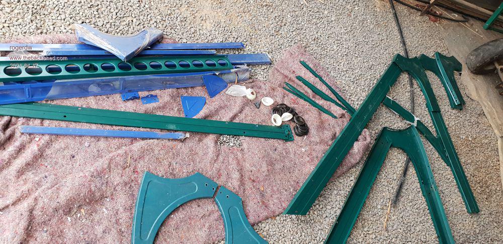

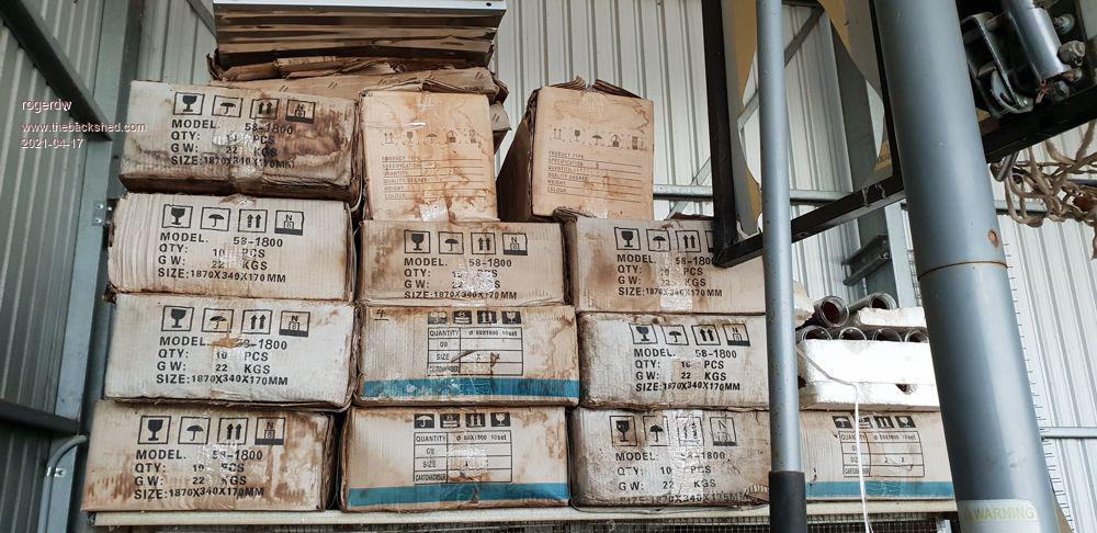

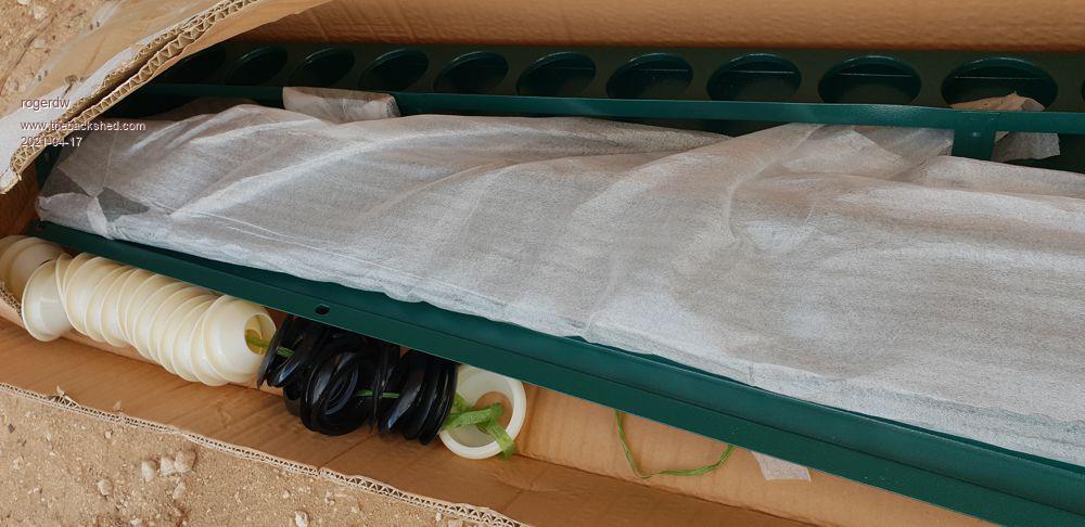

Finally picked up all the tubes and frames today.
10 tubes per box for most and 12 in two boxes. A couple with broken glass sound, so a few fatalities.
But still about 140 tubes.
Were also 4 complete frames. Bit like an Ikea project except no instructions  ...  and a handful of reflector panels that I assume go behind the tubes for a bit of reflective light.
Biggest surprise was that the frames are designed for 18 tubes. Most of the ones I've ever seen were either 10, 20 or 30 tube sets.
I'm especially happy that there's some sets of rubber seals for the top of the tubes and the plastic inserts to protect the nipple on the bottom of the tubes.
And I'm sure I can make use of some of the other bits.

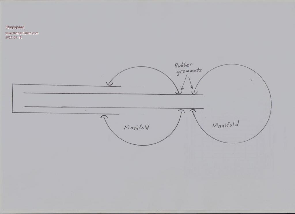

  Quote  Probably the most difficult task I can see is to have to fit 30 short pieces of tube (to fit the centre pipes into)  ...  onto a 7 or 8 inch thin wall inner metal tube, the inner cold air manifold.
This is how I would do it (not to scale):
The grommets could be home made from standard soft rubber extrusion, cut, and superglued into a circle.
The outer tube would be painted black, and the glass vacuum tubes would slip over the outside of the larger tube.
Edited 2021-04-18 12:54 by Warpspeed
Cheers,  Tony.
That is cool, I like it.
And so much easier too. No welding.
Clearly more than one way to skin a cat.
Actually the more I think about it the more I like it.
Thanks very much Tony.
Cheers,  Roger

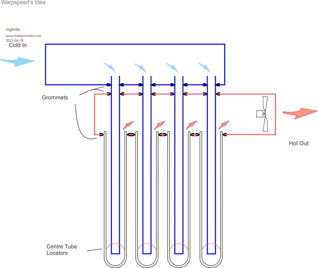

So I drew it out to help with my understanding of how it might physically go together and have a few questions.
What are your ideas on the fan  ...  should it push or pull?
And would it matter if the inlet and outlet were at the same end?
And any thoughts on summer time  ...  I guess it'll need to be covered or it will be sitting on the roof getting red hot but not going anywhere.
Edit: Reduced size of graphic.
Edited 2021-04-18 14:32 by rogerdw
Cheers,  Roger

Your drawing looks a lot better than mine !!
Fans should always push if you have a choice. Fans that pull work in less dense air, especially if its hot, and may cavitate more easily.
Usually a reversed return is the best engineering solution, especially if the manifolds are small or excessively long. But if most of the pressure drop is in the pickup tubes, and the manifolds are a decent flow size, air distribution should be pretty even.
The outside of the pickup tubes should be dull black for max heat absorption.
I would use VHT exhaust pipe paint, its dull black and works to 1,500 Celsius.
Should last for years.
https://www.ebay.com.au/itm/VHT-Flame-Proof-Flat-Black-Header-Exhaust-Paint-SP102/254517145459?epid=244328521&hash=item3b42676f73:g:cLQAAOSwrSpemFKG
Don't know about summer, but beware of thermal expansion. Anything rubber may have a short life, may need to rethink that part.
Cheers,  Tony.

Posted: 07:21am 18 Apr 2021
  Warpspeed said  Your drawing looks a lot better than mine !!
Haha, thanks.
Okay that is easily fixed. Done.
  Quote  Usually a reversed return is the best engineering solution, especially if the manifolds are small or excessively long. But if most of the pressure drop is in the pickup tubes, and the manifolds are a decent flow size, air distribution should be pretty even.
Had to google 'reversed return' to work out what it was. Never heard of it before.
So if I understood it correctly, it would still pay to have the inlet one side and outlet on the other  ...  last in, first out.

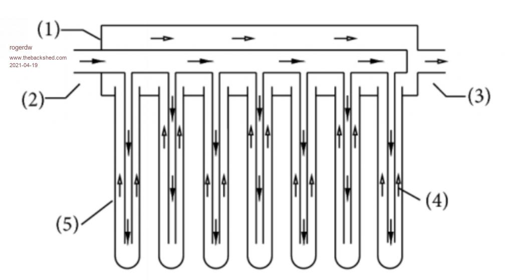

Sorry about the "reversed return" its a bit of engineering jargon.
But as you know it just means the "to" manifold goes one way, and the "return" manifold reverses back to the starting place, so in and out are at the same end.
Should work fine with inlet and outlet at the same end, providing the manifold is generous, and not too long.

  Warpspeed said  Sorry about the "reversed return" its a bit of engineering jargon.
Mmm  ...  now I'm confused.
I read up on it and was left with the impression that a reversed return was  ...
  Quote  "A reverse return system is a type of closed loop system where the return header is connected to the most hydraulically remote load, as shown in Image 1. Compared to the direct return system in Image 2 where the return header is connected to the load closest to the pump,"
So from that explanation it would be best with in and out at opposite ends? Unless I'm still reading it wrong.
  Quote  When I was involved with State Government solar thermal projects many years ago, the rule of thumb there with PVC pipework is that anything that runs continuously at 80 Celsius, and the pipework turns into flaccid spaghetti. Sags like a limp noodle.

Here you go, Google image, reverse return.
Lots of pictures:
https://www.google.com/search?q=reverse+return&hl=en&gl=ar&tbm=isch&source=hp&biw=1637&bih=920&ei=sSR8YKStFpeQ4-EPrI-E8Ao&oq=reverse+return&gs_lcp=CgNpbWcQAzICCAAyAggAMgIIADICCAAyAggAMgIIADICCAAyAggAMgIIADICCAA6CAgAELEDEIMBOgUIABCxA1D0HVizPGDyP2gAcAB4AIABwQGIAfUOkgEEMC4xNJgBAKABAaoBC2d3cy13aXotaW1n&sclient=img&ved=0ahUKEwjkyY235IfwAhUXyDgGHawHAa4Q4dUDCAY&uact=5
This is the classic layout, two manifolds and the inlet and outlet are at opposite ends.
Edited 2021-04-18 22:36 by Warpspeed
Cheers,  Tony.

Thanks Tony, the pictures help. I can be a little slow at times.
Still, better to ask than carry on the wrong way.
And thanks Mike as well.
Cheers,  Roger

I know I said I am building an air heater and not a water heater  ...  but bear with me.
I came across this image this morning and it looks very familiar.
It comes from a paper  where experiments were made comparing this 'down tube' method with the very basic (no heat tubes) system  ...
...  where the evac tubes just plug in the bottom of a tank full of water and thermocycle as best they can.
Turns out in their conclusion  ...  that with down pipes, they get a whopping 5% extra heat output!!!
Also interesting to see that for an internal diameter of 47mm  ...  the best down tube size turned out to be 32mm
Very close to Tony's suggested 70% diameter  ...  which provides the same cross sectional area in as out.
So the point of bringing this up, is that with air being very similar to water  ...  is it possible that I may not need downpipes for my air heating system either?
I'll paste an extract below to save trying to find it  ...
  Quote  Copyright 2015 Jichun Yang et al. This is an open access article distributed under the Creative Commons Attribution License, which permits unrestricted use, distribution, and reproduction in any medium, provided the original work is properly cited.
A novel all-glass evacuated tube collector manifold header with an inserted tube is proposed in this paper which makes water in all glass evacuated solar collector tube be forced circulated to improve the performance of solar collector.
And a dynamic numerical model was presented for the novel all-glass evacuated tube collector manifold header water heater system.
Also, a test rig was built for model validation and comparison with traditional all-glass evacuated tube collector. The experiment results show that the efficiency of solar water heater with a novel collector manifold header is higher than traditional all-glass evacuated tube collector by about 5% and the heat transfer model of water heater system is valid.
Based on the model, the relationship between the average temperature of water tank and inserted tube diameter (water mass flow) has been studied. The results show that the optimized diameter of inserted tube is 32 mm for the inner glass with the diameter of 47 mm and the water flow mass should be less than 1.6 Kg/s.
Cheers,  Roger
