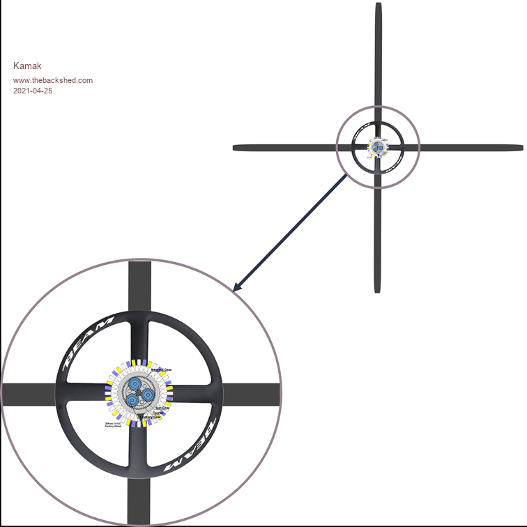

High RPM, high voltage turbine using a 10:1 ratio planetary gearbox @100 rpm prop speed = 1000rpm rotor speed, 240V 3x 1phase AC outputs.

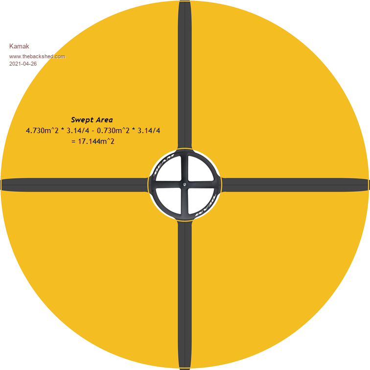

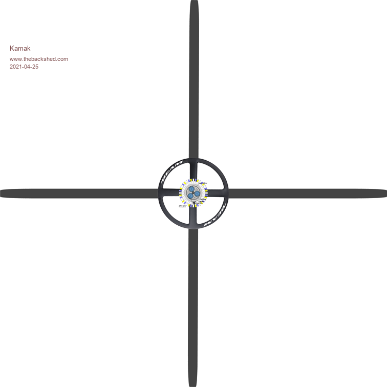

4730mm Dia 4 blade prop. High torque @ low rpm. This is just a guestimate at this point, but I think I'm in the ballpark.
Edited 2021-04-26 04:11 by Kamak

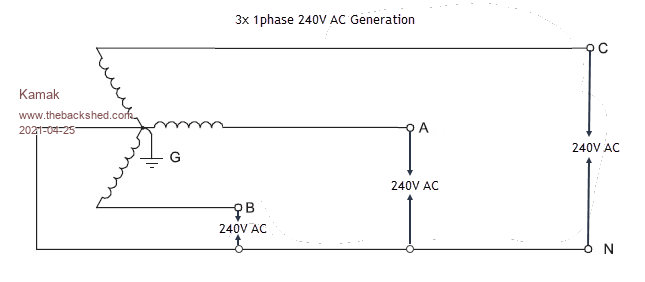

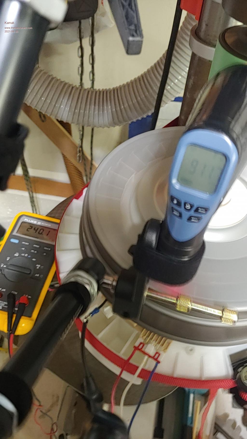

910 RPM on a Samsung Wf210anw produces 240V AC across neutral and any one winding.

Generator:    P=1200W
Gear unit:    10:1 (>95%)
RPM:          n=910
M = 1200/910 * 30/3.14
M=12.598Nm
@ 91 RPM,  MD = 125.98 Nm (10x) Applied(required) by the Wind Tubine Blades
@ 910 RPM, MD = 12.60  Nm (1x) Applied to the Generator
The equation for Wind Power(P) is given by P= 0.5 x p x A x Cp x V^3 x Ng x Nb
Where:
p = Air density in kg/m^3
A = Rotor swept area m^2
Cp = Coefficient of performance, 35%
V = wind velocity (m/s)
Ng = generator efficiency, Unknown
Nb = gear box bearing efficiency >95%
p  = 1.22527
A  = 17.144m^2
Cp = 0.35
V  = 1.666m/s (6kph), V = 5.55m/s (20kph)
Ng = 1
Nb = 0.95
Wind Power(P) is given by P= 0.5 x 1.22527 x 17.144 x 0.35 x 1.666^3 x 1 x 0.95
Produced Power P = 16.148 W
Wind Power(P) is given by P= 0.5 x 1.22527 x 17.144 x 0.35 x 5.55^3 x 1 x 0.95
Produced Power P = 1,706 W
Edited 2021-04-26 14:29 by Kamak

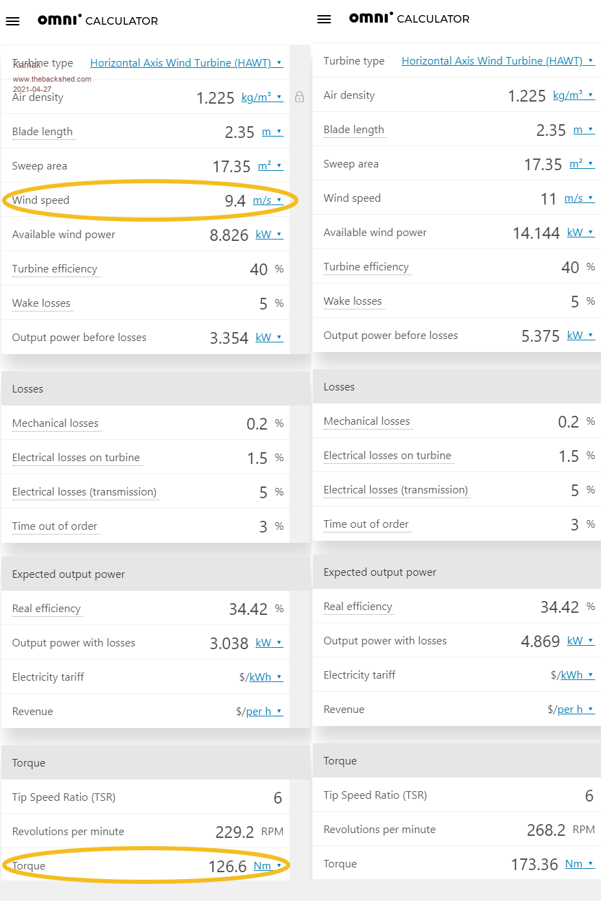

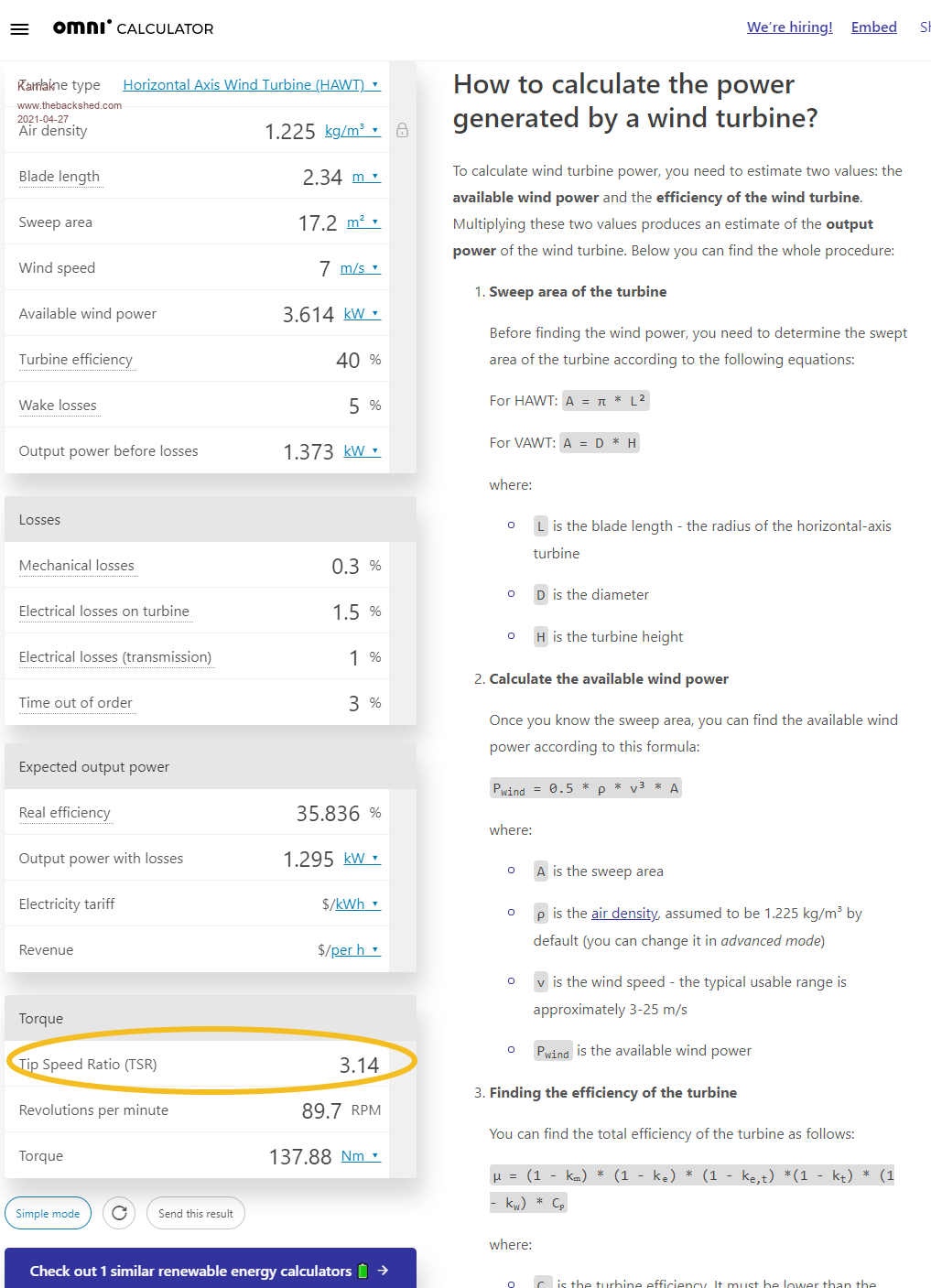

Well, first, I see some glaring discrepancies in my calculation vs an online calculator, like this one. https://www.omnicalculator.com/ecology/wind-turbine This is, most likely more realistic, but there must also be some glaring issues with my manual calculation that has not accounted for something, that I can not see right now.
For one thing, my use of the power and torque required to produce the required rpm at the generator is messed up. Firstly, power in is power out, all-be-it with losses, so that's an obvious one there. There's no such thing as a free lunch, right? We can't "amplify power" through a mechanism, we can only capture as much as possible and transfer it, transform it, with as little losses as possible.
So, therefore, yes the gearbox will amplify the rpm, but at a power loss of less than equal to its output. So I have to calculate the power required, just to start and maintain velocity, of just the gearbox alone, and the power to overcome its inherent inertia against accelerate.
Wind Turbine Blade Efficiency and Power Calculation
with Electrical Analogy
Therefore, I'll need the rotor's power output of approx 1.7 x 1200W (as per standard practice for wind turbine calculated losses), plus, the power loss through the gearbox.

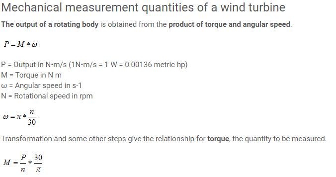

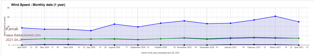

If this calculator is correct, then the minimum rotor power required to deliver the minimum torque to the gearbox to maintain 1200W at 910rpm, 240V ac @5A single phase per winding, is: 3.038KW to make 1.200KW, 2.5:1 reduction. 34Kph. Not including startup and acceleration torque.
how-to-calculate-the-power-generated-by-a-wind-turbine
The second chart is the local monthly avg. wind speed.
Obviously, the rotational speed would not be correct due to the minimum torque required to spin the gearbox at 91rpm @ the ring gear to produce 910rpm at the sun gear.
https://www.hbm.com/en/3108/torque-measurement-in-wind-turbines/

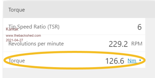

Well, this is actually starting to look more sensible and realistic.
I had to recalculate for a 4 blade rotor. 4 x pi/4 = 3.14 TSR
More torque at less speed.

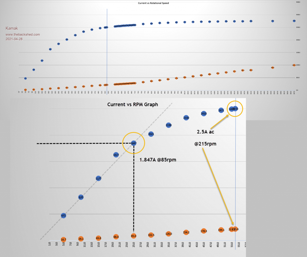

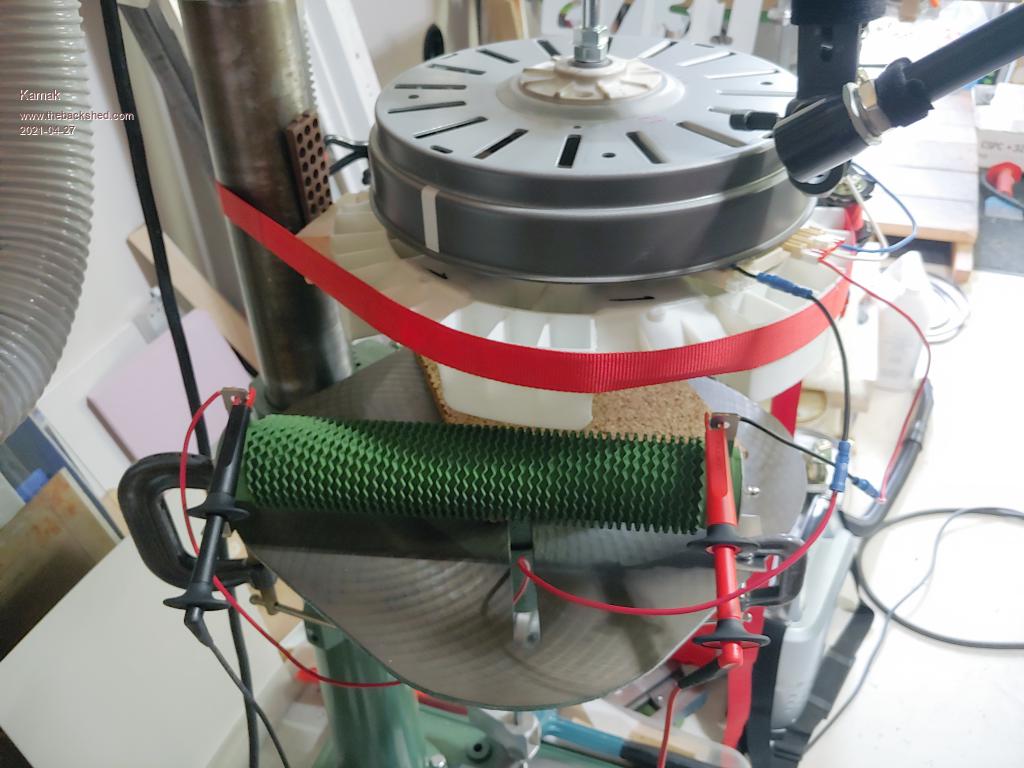

At the moment, I'm only getting 7.7V max. at 2.7A max. ac (20.79W) maximum through a 2.7 ohm 750W resistor across one winding and neutral at 1000RPM. There must be such a minimal ability for the generator, with its combination of existing stock magnets with low magnetic flux density and the number of wire wraps per stock star leg, that it can not produce many amps through such a low resistive load. The three winding each have 6.2 ohms of internal resistance. The light bulb I used, the other day, was 10ohms - cold. it was only a 100W capable device and I was able to put approx 120V at approx 0.919A through it at 500RPM. 120x0.919 = 110.28W. 120/0.919 = 130ohms - hot. I need a higher resistive load capable of higher wattage with a minimum of 2.7A capability, but I can't exceed the RPM of 1000.
Open circuit voltage across any winding and neutral is 240V @910RPM
@500RPM, the voltage across one winding and neutral was 120V and 0.9A with a 130ohm dynamic resistor, a bulb, temp dependant.
32ohms = 240W/2.7A^2
88ohms = 240V/2.7A, P = 240x2.7 = 648W, Maybe that's the one, 88ohm resistor capable of 750W
I found an off the shelf resistor
82ohms, 750W max, V = 82 x 2.7 = 221.4V, 221.4V^2/82ohms = 597.78W, If at 240V^2/82 = 702.439W but that suggests an amperage greater than 2.7A, which I don't think it will produce. That would be 240V/82ohms = 2.927A.
240.5V/916RPM = 0.26255V/1rpm open circuit.
Check: 0.26255 x 500rpm = 131V open circuit.
366.5Hz = 366.5/24poles x 60sec = 916.25RPM
Edited 2021-04-27 16:12 by Kamak

Star Winding, Single phase to Neutral
Conclusion: approx. 200RPM @ 2.5A, Maximum Return vs Cost-Benefit Point, really starts to taper off.
Edited 2021-04-28 06:17 by Kamak

  Kamak said  At the moment, I'm only getting 7.7V max. at 2.7A max. ac (20.79W) maximum through a 2.7 ohm 750W resistor across one winding and neutral at 1000RPM.
My understanding is you are getting this using your bench drill press? It might be interesting to measure the bench drill torque, which will be a function of the current / power its (the drill press motor) pulling / drawing when you are driving the dump load at a notional 20.79W - and how much energy is going elsewhere? 20W running a generator at a proven 1000 rpm seems unexpectedly low to me.
One back yard way of getting more resistance would be to use long runs of cable in series with your resister.

You have to see the other post I've made, with regards to my suspected reasons for the 2.7ohm resistor, the 100W light bulb, and the graph above. The resistor is too low, compared to the resistance of the internal windings, I believe. It's just like shorting the two ends of the windings (neutral and #1, say) through the meter, nearly no voltage. It's capable of producing lots of voltage, with a max of 2.7A. The light bulb proves that it can produce at least 120W. I demonstrated it. I just need 88ohms at 700W. So I'm getting 11x 8ohm resistors capable of 100W each (88ohms @1100W).
2.7A^2 x 88ohms = 641.5W through one winding @ approx. 240V.
But the graph says that gains after 2.5A are negligible. and that occurs way down in the rpm range. approx 200rpm. This makes it more practical to use a 2:1 ratio planetary, at 100rpm input.
So maybe at around 2.5A, 2.5A^2 x 88ohm = 550W per winding = 1650W @ 220V (x 3 windings), 2.5A x 88ohms = 220V. Proven with test hopefully.
approx. 0.26255V/1rpm (open circuit). 220/0.26255 = 837.9rpm
Maybe back up to an 8:1 planetary
I'm not sure at what rpm it will reach 2.5A with an 88ohm load
Three step down transformers, one for each winding.
