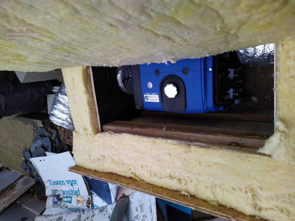

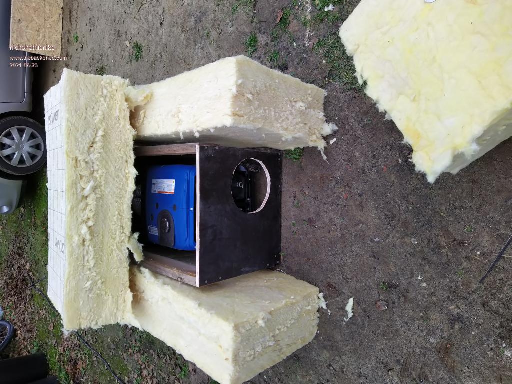

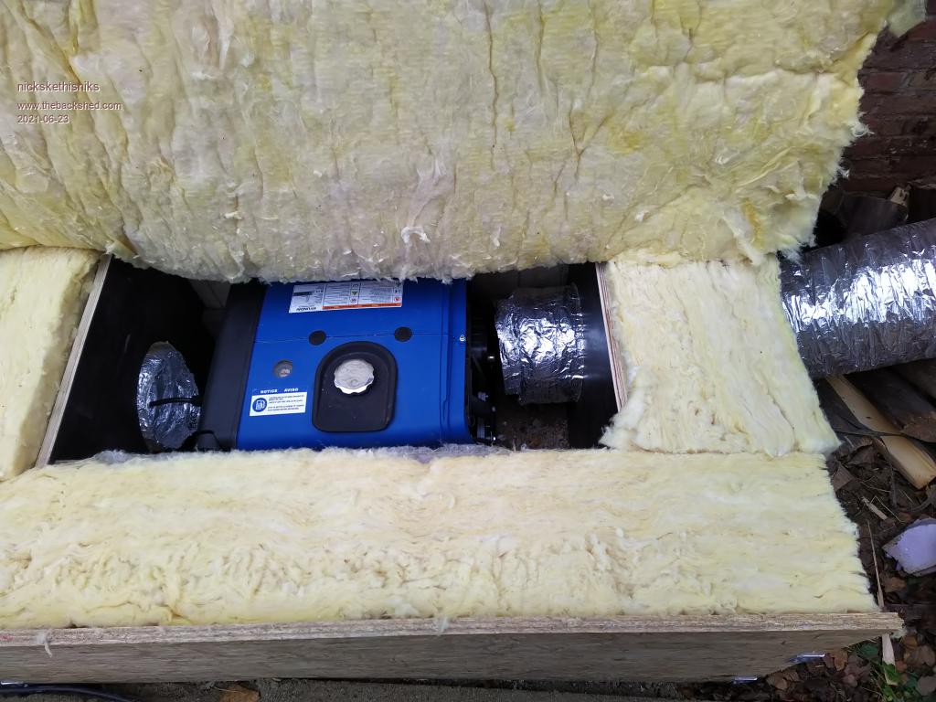

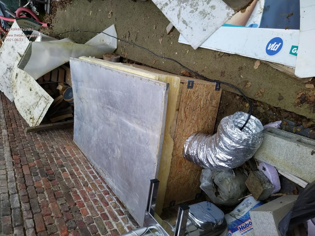

Hi, I need to read up yet, but this is how I did:
I used 2 wooden compartments mechanically decoupled by 22cm thick isolation. I used 20cm in and outlet noise reducing hose used in ventilation systems.
I think I had a 10db reduction, it was quite impressive actually. It's already a "silent" inverter but still loud.
But now I don't hesitate using it during the day, only concern now is the smell when there's not much wind.
The unit Hyundai unit is capable of doing 3.2kva but I'm only using it at 1000va most of the time, max 1.6kVA. So no heat concerns, and probably better for long term use. It has a remote for turning it on or off, so if I'm on the right spot I can start it in the house. With about 7liters I can run around 8h, and let it shut off itself on heavy clouded days. The generator is selfcooling so I did screw the side off for a better fit, but no extra fan was needed for the power level I'm using.

Good day Nick, Well done
It sure is a lot of insulation 22cm, but 10 db noise reduction is also impressive.

That looks pretty efficient Nick, very neat and compact too.
Some of the "silent" portable generators now available are very quiet.
