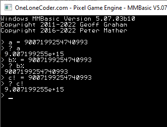

Posted: 06:27pm 03 Aug 2022
  Quote  CONSTANTS
If the decimal constant contains a decimal point or an exponent, it will be treated as a floating point constant; otherwise it will be treated as a 64-bit integer constant.
You will have to excuse me if I am misunderstanding the "controversy", but the fact that you are assigning an integer constant to an undeclared variable does not effect its initial type, e.g.
a and c! are floats, b% is an integer.
Edited 2022-08-04 04:28 by thwill
