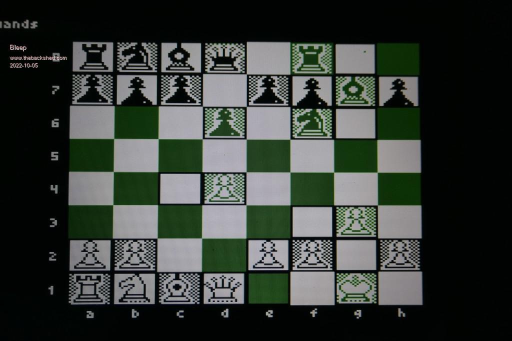

Posted: 04:12pm 04 Oct 2022
First attempt, not sure why the green colour is showing on the pieces, I thought they should be just black and white?

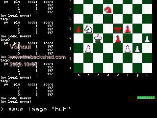

Posts: 6184
Posted: 04:31pm 04 Oct 2022
Kevin,
I am not sure TSCP will finalize a game with itself.
Who ever is to play, a pawn can be taken....
No valid moves...hah...

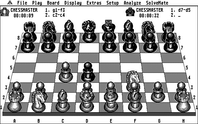

the Supreme discipline would be a 3D(like) view  but for this I have to draw all Figures as Sprites .. that will Take some time.
It would also have to user Framebuffer and Layer ...
(just for Inspiration)
Something like Chessmaster on the old Atari ST:
