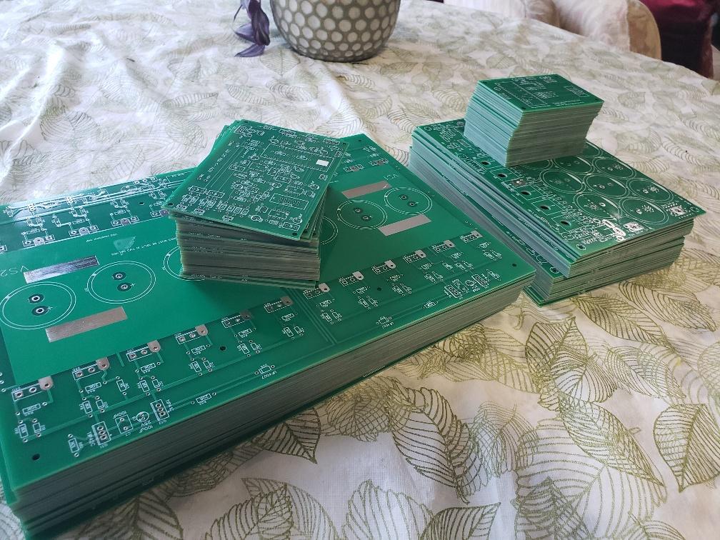

so the next step is for you all to please PM me with
your real name and address.
Then I post what you ordered and send you a PM with the total cost including
Australia Post costs. I will select an AusPost box or padded envelope
as needed and this will be added to the cost. These things are not very expensive
but they protect the PCBs quite well.
I better get to Officeworks to get some packaging tape and stuff.
I want to repeat that I will support all builds with any requested information and
firmware. Let's build some good stuff!

I just posted boards off to
Cobbler
RFburns
mab1
Mrracerhacker
bret76
disco4now
pd--
I need postal addresses for
Nicks
noneya
AndyMc, maybe I will visit or something. We could have a bit to catch up with.

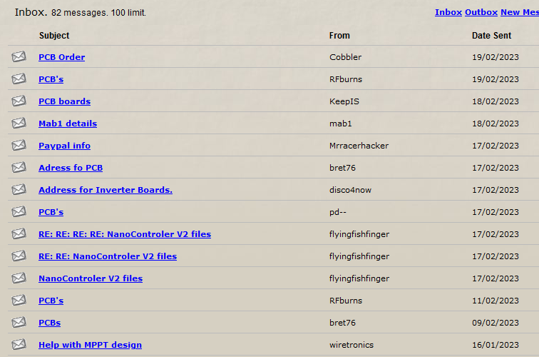

hey poida,  I did PM you with my details,  would another way be better ??
Posted: 03:46am 20 Feb 2023
I didn't get it if you sent it recently.
This is my inbox
Posted: 07:47am 20 Feb 2023
Just sent you a PM poida   after seeing this last post

no worries,  unsure on what happened,  I sent it on the 17th... but I just sent through the details again .. let me know if you have any dramas..
thanks again

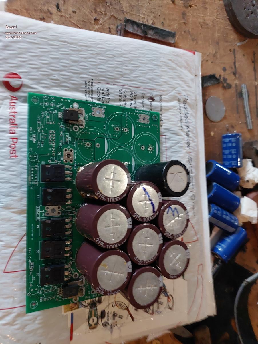

Posted: 04:35am 05 Mar 2023
G'Day Guy's,
            This morning I got out that grid tie inverter and found a few goodies like 8 off 315 volt 1,000uf caps and 5 off IR 123P fets. I have 4 off ACS754-150 current sensors here.
So currently I have 8,470uf with the 9 caps also enough 400 volt 220uf caps but then again what is the right capacitance to aim for.
Now I need the info on the rest of the parts and a link to the right arduino would be great as there are some clones and rip offs on the net best to get the right one.
Cheers Bryan

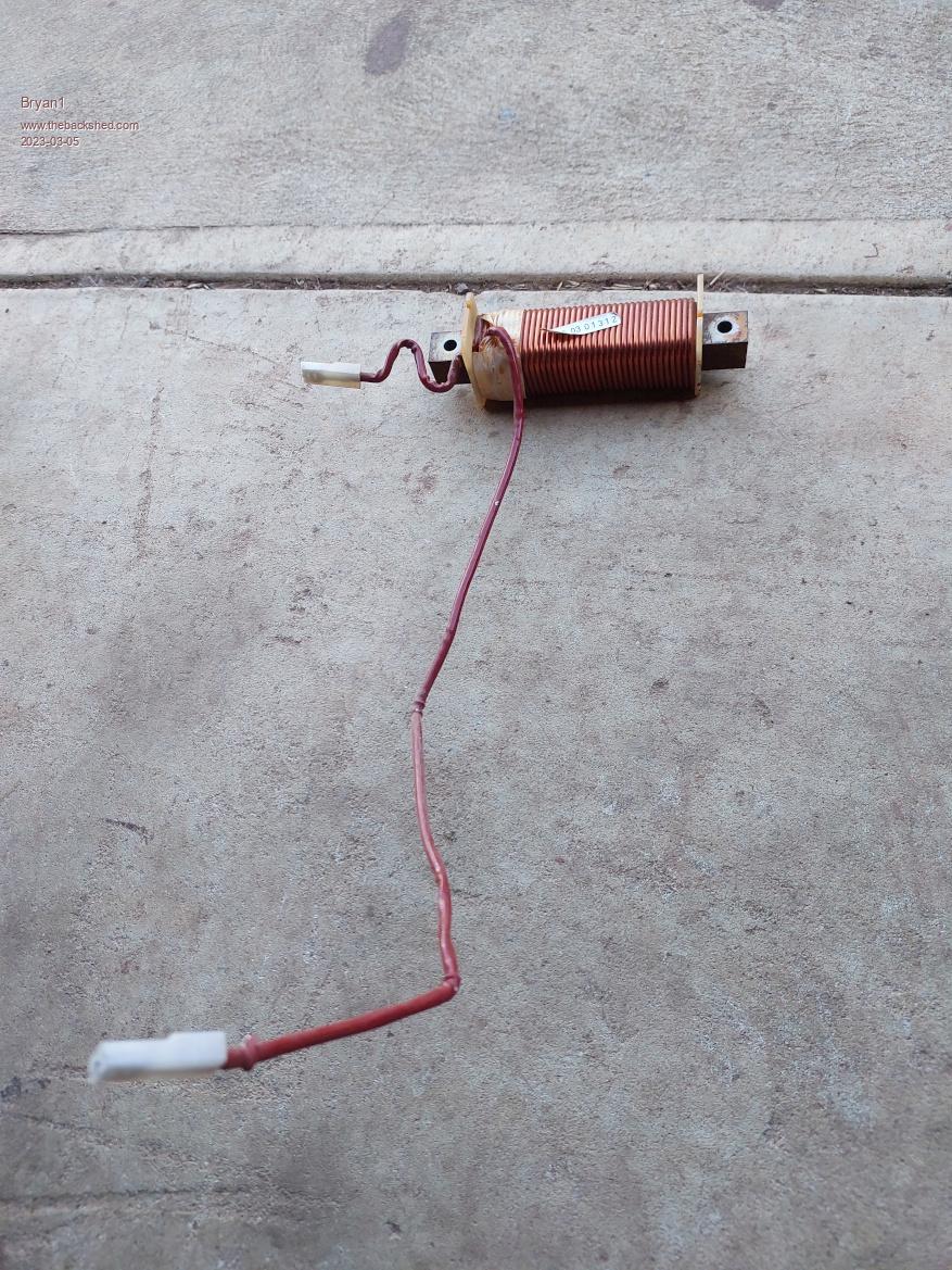

Edit: also found this
2.5mm wire 35 turns each over 2 pass's with a 16.mm square core so hopefully it will work.

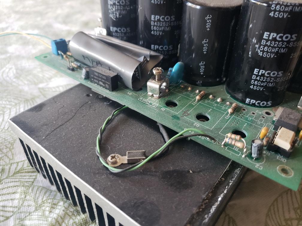

Posted: 07:37am 06 Mar 2023
you have a desoldering tool?
I think you have put the FETs and diodes in the wrong way.
you need to get them to mount on a heatsink
This is how I did mine:
see how the devices are on the other side of the PCB.
