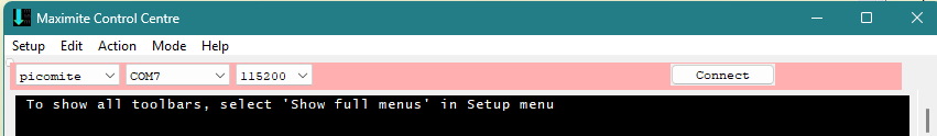

MMCC will start up in 'Lite' mode next time you start it.
Lite mode hides most of the options that seen to confuse the beginner.
Don't panic, select Show full menus in Setup and things go back to normal.
If you have any 'favorites' set, the Presets menu will be shown in Lite mode.

Not sure if this is the best way but it works.
Open MMCC, select the device and com: port then click connect. If successful a green "connected" sign appears.
From action menu select "Clear local screen" then
From action menu select "List All" to list the file, then
From edit menu select "Copy All" to copy it all to the clipboard.
Go back to MMEdit, open a new window then type Ctrl-V to paste the clipboard into the window. (or right click in the middle of the window and select "Paste").

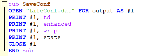

Posted: 05:38am 13 Feb 2024
Hi Jim,
MMEdit seems to have a blind spot for SUB. I'm using the latest version. Working on MMB4W:
The tkn file does contain "sub" and if I change the syntax to CMM2 or some other the result is the same SUB is not recognised.
MMEdit knows internally that it is a sub as you can see by the collapsible thingy but the syntax is not highlighted and capitalized.
