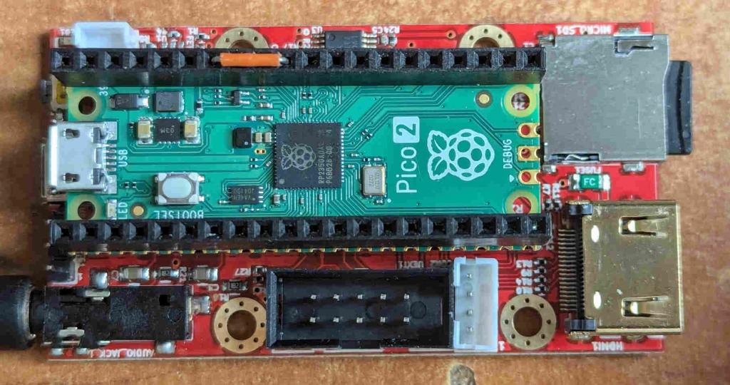

I ordered olimex, £16.90 . mmy pico2 I solered pin headers, not like the photo
should I have used long lead female headers like https://www.ebay.co.uk/itm/121744167815
like in your photo?

It makes things easier if you want to connect other things, but it's not essential otherwise. It will still produce HDMI. The 10-pin socket gives you a few IO options. You will need to solder the link shown on Peter's photo to get stereo audio though. That can be on the bottom of the board if you like.
Available on the connector are:
PIN
1       3V3
2       GND
3  GP20 COM2 TX
4  GP21 COM2 RX
5  GP9  I2C SCL (with pull up)
6  GP8  I2C SDA (with pull up)
7  GP4  SPI MISO
8  GP7  SPI MOSI
9  GP6  SPI CLOCK
10 GP5  SPI CS
Edited 2024-09-09 06:37 by Mixtel90

cool Mick. olimex thing will be so new and unknown to me. what's rgb 555 is my level.
so could use the pico2 with just pin headers.. thought about soldering female headers cos little cuts on every connection so maybe possible but rather do something else.
The frame thing is different with pico2 and 2040. it will be all new with dvi/hdmi.
do we still need the sound filter for audio as it's got 3.5 socket "audio?"

Using the stackable socket headers gives you more access to the GPIO pins, but the board will work equally well if your Pico has male pins on it. As I said though, you will need to add that link somewhere if you want stereo audio.
The video commands seem to be the same if you are using the same video modes. Obviously screen resolution can be different. Make sure you read Peter's notes.
There is a filter in the audio circuit, you don't need an external one. It looks like they've boosted the output a bit too, giving it a bit more current drive.

well i2c would be useful and if it's the usb hdmi firmware the 3  GP20 COM2 TX
4  GP21 COM2 RX to usb to ttl would work?
see when it arrives. £3.60 1st class rm. let you know, stan

Why not try GP8/GP9 for the console as usual? The pull up resistors are 2K2 but it might still work. The signals idle high so it just depends on how well they can sink 1.5mA - I suspect it will work fine. It would save having to make a special setup to move the console.
I2C SDA is also available on GP20 and I2C SCL is available on GP21, you just need to add your own pull up resistors (anything between 1K5 and 6K8 is usually fine. 10K is fine over short distances. 2K2 and 4K7 are common.)

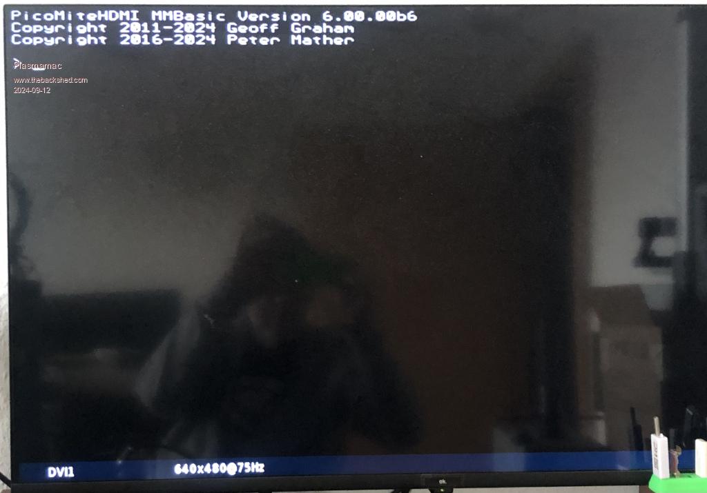

Posted: 03:03pm 11 Sep 2024
status update :
finally the package from jlcpcb is here.  check the hardware and start sending out on friday

Posted: 03:07pm 11 Sep 2024

Joined: 31/01/2019
Posts: 620
Posted: 05:03pm 11 Sep 2024
Looks like all is fine
Plasma
