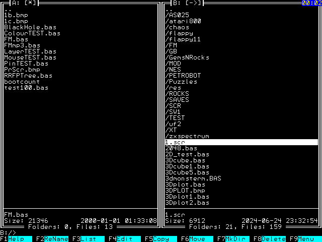

jFM v.1.7 for PicoMiteVGA/HDMI
jFM_v1.7.zip
- added MENU by F9 from which you can execute the necessary commands or run programs
> command
* program
- scrolling the list of files forward and backward with arrows or PgUp PgDn
To launch FM by pressing the F9 button (you can F5...F9)
you need to save the program in the memory slot and set it to launch by pressing the Fn button
LOAD "FM"
FLASH SAVE 2
OPTION F9 "FLASH RUN 2"+Chr$(13)

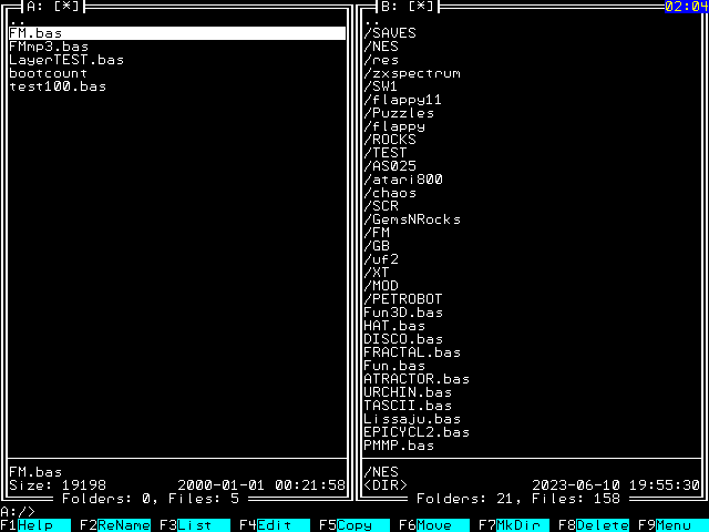

jFM v.1.8 for PicoMiteVGA/HDMI
jFM_v1.8.zip
- RAM consumption optimization
- plays mp3 files on Pico2
- displays information about the current file at the bottom of the panel (size&date)
- saves the Screenshot image by pressing the PrintScreen button
Edited 2024-10-13 21:32 by javavi

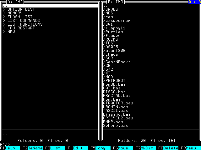

FM v.1.9 for PicoMiteVGA/HDMI
jFM v1.9.zip
File Manager updates:
- Added navigation with buttons [Home], [End]
- Added sorting of file list [Alt+F3], [Alt+F4]
- Well, and some DTMF sound :))
What are your thoughts, write here!
Regards, javavi
Edited 2024-11-10 18:32 by javavi

First off, I love your program.  It gives me what I miss from my CMM2s.
There is an issue with this version.  If you Hit F9 and then select commands list it lists them but then REBOOTS!!!  every time.
I am on RC15 on a PICOHDMIUSB board.
