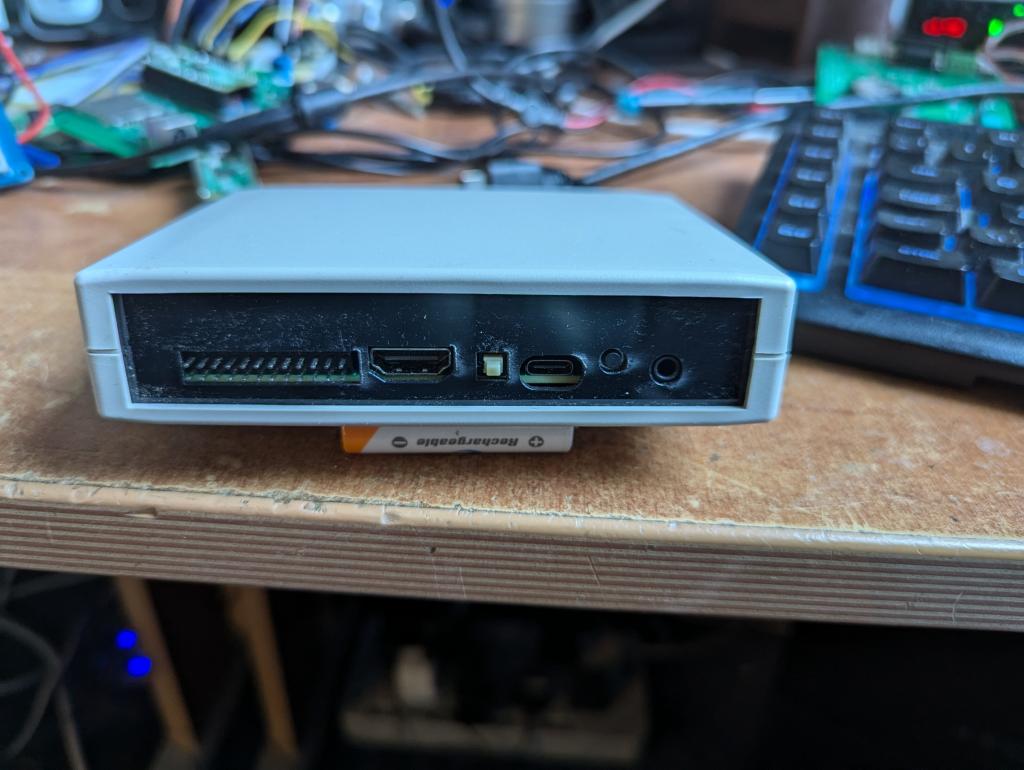

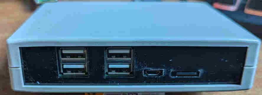

I've designed end-plates for the boxes cut out on my laser. The spacing of the USB-A ports is slightly different on the final layout so I need to just check that before I post the dxf files.
It's strange how the laser has charged the plastic such that every bit of dust has now stuck to them

Nice. :)
Do you find that these little cases are easier to design with than the CMM2 one? Those PCB mounting pillars are a right pain, even when you don't use them.
