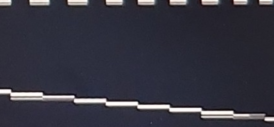

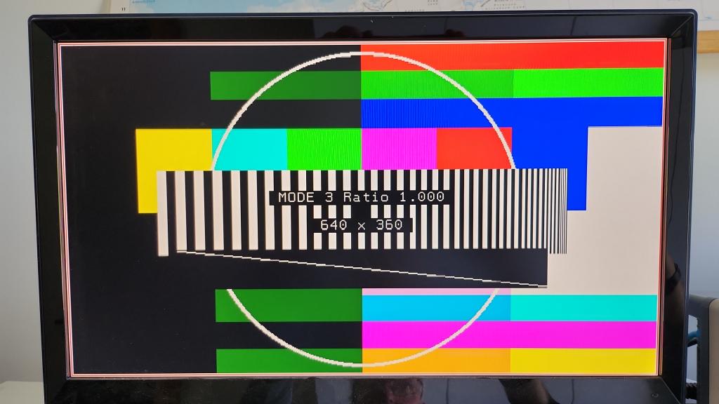

PicoMiteHDMI MMBasic Version 6.00.00RC2
With the tweo wide resolutions 1024 and 1280,
MODE 2 and 5 are very stable.
MODE 1 and 3 have what looks like interlacing gone astray.
In mode 3 there are 4 good lines then 2 lines which appear to be  alternating between correct and out of order.
Tested on 2 monitors, both native resolution 1920 x 1080
All modes are good in 640 resolution.
RC1 was good in all resolutions.

Posts: 12035
Posted: 09:25am 01 Oct 2024
The LittleFS filesystem is case sensitive. FatFS is not. Nothing I can do about this without changing the internals of LittleFS.
There are bugs in RC2 in 1024x768 and 1280x720 modes which I'm working on (Thanks Jim)
