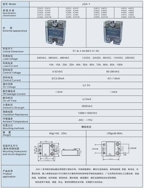

Solid State Relays SSR 24-480V AC, 25A + Heat Sink for Solid State Relay SSR
Hi Karl and Pete,
Details of the relays AC an DC
Bob

If you intend using SSRelays, then take care with the inputs. I use only 5V logic, but is you want to use 48V levels, then use a series resistor and a protection zener of say 24V across the SSRelay input.
I have found that the relays with 240VAC coil work OK at 58-65VDC. The telecomunications use 48V components. Industrial switchgear normally uses 24V.

As for the circuit a simple 08m picaxe will do the monitoring and switch the relay to the second or third or forth dump as you wish.
Its the beauty of these little buggers they can do whatever you program them to do.
Some time back i designed and built a circuit that would switch any excess load through to a 240v electric heater using the inverter as a dump.
This same circuit would work with a standard dump and would just need the triac swapped out for a solid state relay to switch the dc load to the dump.
I never costed it out but would be about 1/10 of your present investment of a controller, plus the SS relay.

Relay needs 12V -coil is 120ohms (model SY4040)
Thus need dropping resistor from 60 to 12V 60-48 =12 /0.12 =400 Ohm resistor
Going for a (part No) RR2764 390 Ohm 1W resistor and catch diode for acoss the coil on the relay and whalah can switch 30A an 2nd terminal.
I have no idea what I'm doing here so let me know if i'm wrong!
Posted: 01:29pm 23 Jan 2010
Broken caculator i think?
AS:-
12 / 0.12 = 100 not 400?
The way i would do it is
Coil = 120 ohm
volt = 12
12 / 120 = 0.100 (or 100 mA)
60 - 12 = 48 (or 48 volt you need to drop)
48 / 0.100 = 480 ohm resistor
You see!
Pete.
Ps. 12 X 0.1 = 1.2 watts
Might want to get 5 watt resistor ...RR-3269...Edited by Downwind 2010-01-25

You could always use the 240VAC coil relay 30A 2P2T from Jaycar. These work well directly on 58-62VDC, without any resistors, and lower activation current, as all power used in the relay coil. Have to still use the diode across the coil though to protectr any semi-conducter switching device.

Have a look at these solid state relays on ebay and worth the read on data for your own interest.
Sureelectronics2 on ebay
