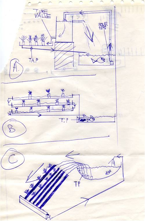

3 Examples and ideas sort of mashed together here...
Please excuse sketchy sketch and oldschool paper torn off...
And to save mega posts and questions T.P stands for Timer Pump!
A. is using a water valve on a timer. Solar pump on its own circuit fills a tank which gets to a level and cascades out into fish pond to aerate the water. Valve is situated lower than this and opens on the timer into another tank of veggies. It then floods to a point. valve shuts or runs out of water. Veg tank slow drains back to fish. Advantage of the valve is it can run dry with no damage as it just stays open. No power to the valve & its closed. Issue is the tank the plants are in. If you expand on it, you may need to expand the water tank (With the valve on also) or hope its a sunny day so the solar pump keeps transfering water.
B. is a gravity pipe version. Pump pumps water up to top pipe vetically. Gravity carries water back to pond via each pipe by falling. Not what I want to do but idea for piping came from that. Usually people push a constant flow of water through this, slow pumping all the time. This will drain the battery in this design. Not good!
C. Simmilar to B but instead of stacking upwards the pipes are level next to each other horizontally. Although the pipes flood simmilar to A.'s plant bed. Slow return to the pond held up by an irrigation tap. I think...1 pump per pipe... as manifolding equal amounts to each pipe may be an issue to regulate.
Long as its the same pump for each pipe I think its safe so say they would pump approximatly the same volume (in theory). Pumps activated by timer. Could probably still have a solar pump on seperate circuit to run water filter/aerate water on the fall also.
SO... A or C I think so far. none of this is the actual idea I will go with but this is as close as it gets as a current idea.

Your pictures are worth 1000 words. Now I see what you're doing.
Here is a thought.
You said a manifold would not be any good as the flow in each pipe may not be equal.
If you had a trough as drawn, the head for each pipe would be equal, so the flows should be about equal.
However, I don't know how high the trough would have to be above the vegies to provide enough head.

Yep, your onto it!
That drawing is simmilar to my A. Diagram ( if you call it a diagram!)
Either a pump or valve would work in this situation.
Thought about a trough, definatly would have to be spirit level straight to equaly distribute evenly. All holes would need to be drilled level also. Tricky but do-able. Valve could just dump into the trough and solar pump just fills a vat behind it.
Also like the idea of a ball valve but maybe not needed. Thought also a ball valve could replace the timer if somehow triggered at the right time. Not looked into at all though... might end up more expensive, but really unsure on that one. I need to research what's available.
Instead of pipe I did think to use the secondary pond dish usually used as a waterfall, as the actual veggie tray. Trouble is expanding on it. Much easier to add another line rather than adjusting half the setup to cater for it. Then again, I could drill and add plumbing to it, but it probably passes the point of no return as part of the pond then. I feel there's no need to make more work, just keeping it simple is the go.

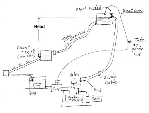

When I said "Float Switch" I meant an electrical float switch not a toilet cystern type Float Valve.
See the attachment below for an variant of what I posted last time.
This idea provides more head than the previous.
I don't know how much head you will need, you will have to experiment.
I'll post another variant later in the day. I have other things to do ATM.
Len

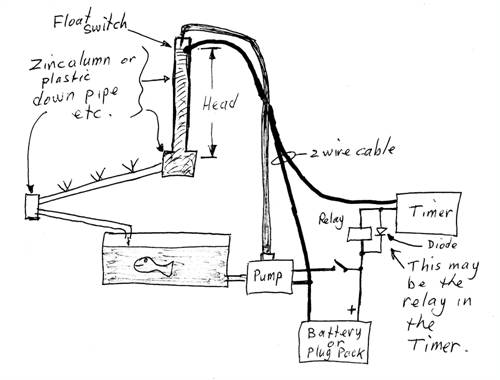

Here is the promised next suggestion.
It is a variant on the previous.
Note that the relay & diode may be the ones in the Timer, it depends on the starting current of the pump motor.
The point of the Float Switch is to turn the pump on when the water level in the column drops & to switch it off when the level reaches the limit.
Alternatively, you could simply have an overflow that goes back to the pond so the pump runs continuously while the relay is operated by the Timer.
JayCar sell a suitable Float Switch.
However, they may be available from irrigation parts suppliers.
Len

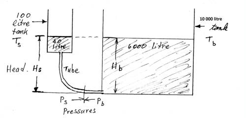

This should help you to visualise the “head” of water and its relationship to the water pressure.
The diagram shows a 100 litre tank connected via a tube to a 10,000 litre tank.
Obviously, when water is poured into one tank or the other, water will flow through the tube until the levels are equal.
At this point the head of Ts is equal to the head of Tb, i.e. Hs = Hb.
Therefore the pressures are equal and opposite, i.e. Ps = Pb. Thus there is no flow in the tube.
Now suppose someone pours 50 litre of water into Ts quickly.
Initially, the level in Ts will be higher than that in Tb, so Ps > Pb.
Therefore water will flow from Ts to Tb until the levels are again equal.
Len

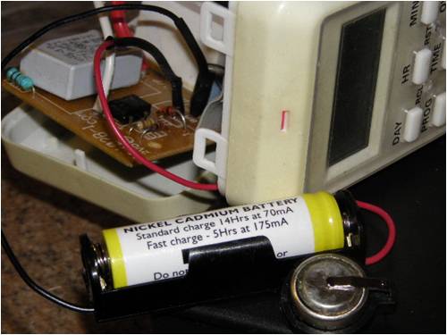

Also got a slight mod update... got round to soldering a AA battery clip into the timer.
LCD is lit and functioning unfaded, so plenty of juice there. Plugged into mains, AA seems to be charging nicely, batterys not feeling warm so seems steady.
In the pic you can see the old coin cell I took out. I had that charging overnight but woke to no LCD display so thats over with. AA is Nicad which was the original type in the timer. The replacement coin battery shown was obtained from Battery World. The NiMh and was nowhere near as good as the original, they charged me something like $8 many years back, and were the only people I could find to supply a replacement. See how this runs in meantime for timer recovery.

I presume the reason that the NiMh battery did not work well is because they need a different charger to NiCADs.
As you probably know, the disadvantage with NiCADs is they have "memory" so they need to go through full charge/dicharge cycles.
Len

Yep, I think it may have done the job but I think the Milliamp hour rating was weak compared to the stock battery. Seemed to hold up if used on an appliance that was on most of the time or 50/50. Anything less and I notice it becomes inactive and you would have to leave it on again full time just to give it a decent charge to hold the time in it's later days. Fish tank after a few weeks would not turn on as scheduled. The timer just drops out.
Anyways... see how this goes... could have used 1 X AAA and maybe get it all back inside the case but that would have been a squeeze. I think from memory the mAhr is not as good as a AA so.... ah well done already.
Will see how the battery holds up over the next few days & proceed from there. Was near flat when inserted. Had a faded LCD display but been on for a few hours running on mains, turned it off and its looking sweet so far. Interested to see how long it can last without power running through. Battery is old but never got used much. Bought in a pair. Lost one of them, might have got thrown by accident or lost at some stage. Thought to keep it as I would find a use for it one day! There is it!
Probably about 5 years old but only had about 10 charges in its lifetime. About 6 months ago a friend charged it in a charger that handled batts individually and it got the all clear as still useable, no damage to the cell. Now back in use.

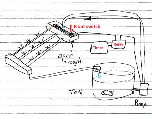

Another quick update... Been thinking about the float method & I have a design that seems simpler than my last few designs. I will do another masterpiece drawing to gawk at in awe in the next few days. I think the float is the way to go for cost!
The jaycar float switch is $20. Have researched online and found a place in asia that sells a mini version of these (or it could be the same one...?) for about $3.50 delivered! Might order 1 or 2 to check the quality.
So currently the price I have got this down to for main parts/spares is looking like $3.50 for the float switch, and about $8 for a 12v pump (which would kick in off the float, pumps cheaper than a gravity valve). Looking alright there for the price! Shaved some $$$ off the cost for sure this way if all goes to plan. I will check it out a little more over the next few days. I want to recommend the company who sells the cheap float switches, but wait till I have ordered & if the quality is decent I shall recommend on here for all. We all know what ordering from China can be like! Bit hit and miss at best.
