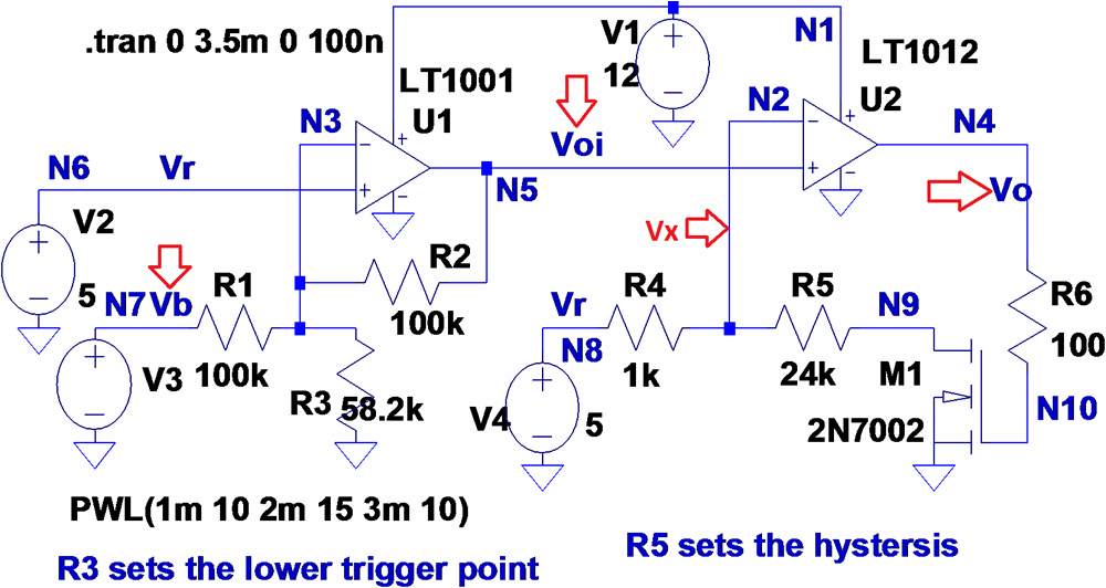

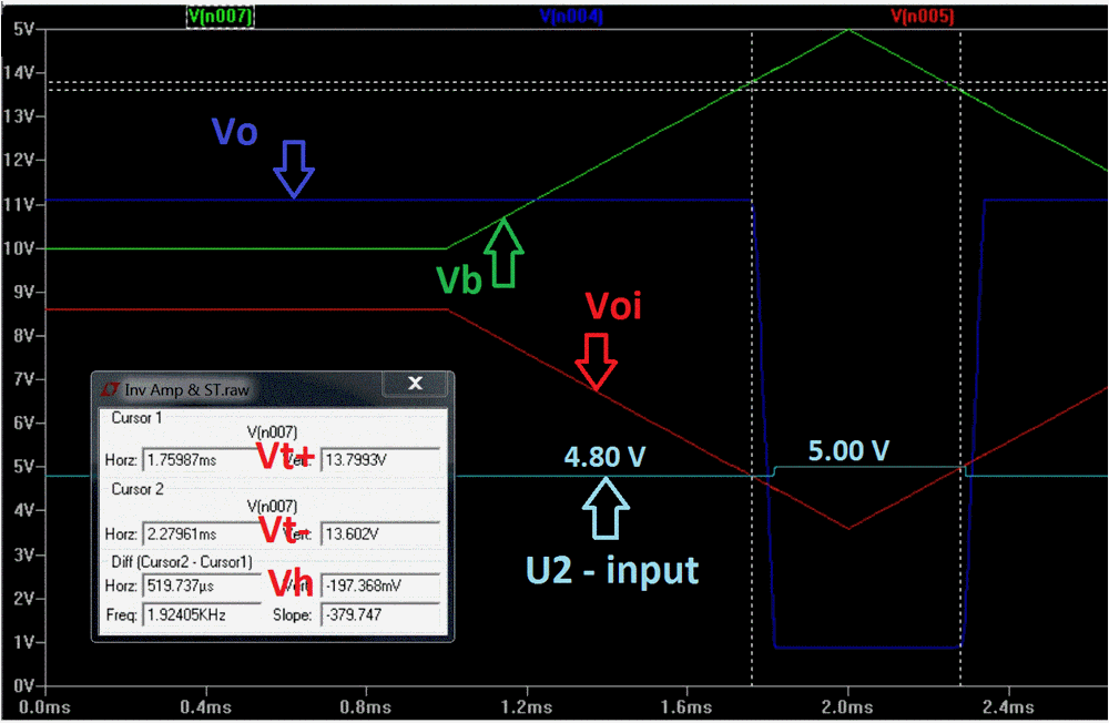

That's intereting. I did something similar last week.
It was before Jasper had given me the Model for the LM358 so I used two Op Amps from the LTSpice library.
The M1 MOSFET is to bypass the Voh issue & to make the Vt- (& therefore the hystersis) independent of the Vt+ setting.
I also thought about using a CMOS Schmitt Trigger package, but did not persue it much. I intend to consider the use of a CMOS inverter first, ie. configure one as a ST.

Len, that certainly solves the wobbly LM358 problem, and gives you some hard hysteresis numbers to work with.
That would be my approach, build a voltage comparator with well defined switching thresholds, then "tweak" the input voltage swing from the battery with an amplifier.
With a bit of numeric experimentation, almost any switching thresholds could be achieved fairly accurately with common resistor values.

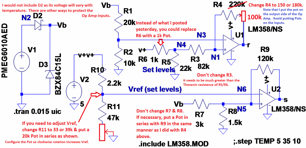

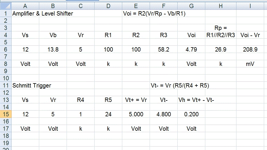

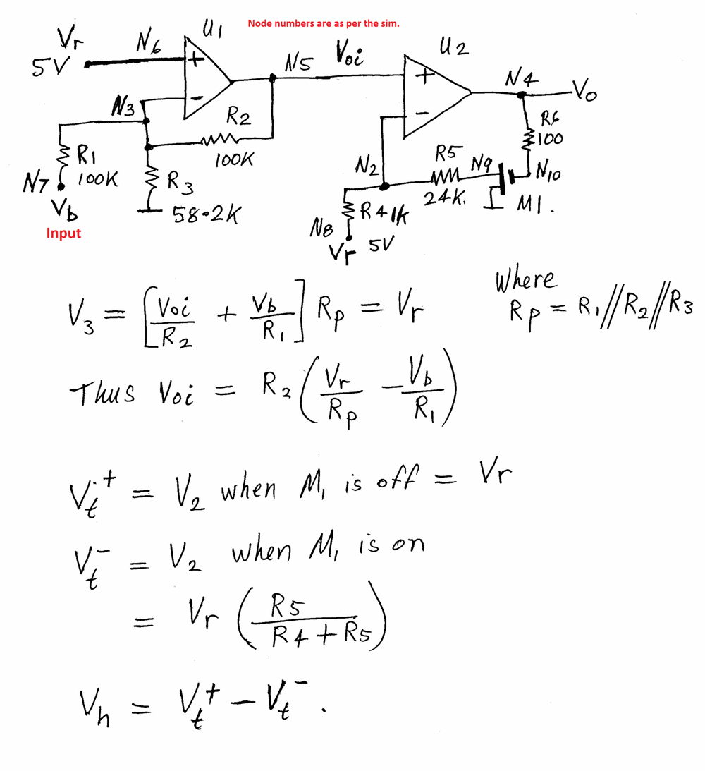

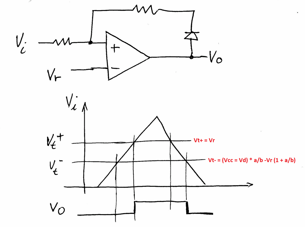

Here is another method that I have used to make the Hystersis independent. The diode is a simple alternative to the MOSFET. BUT, the diode will have a temperaturs coefficient that must be considered.
Len
EDIT.
The answer is in the maths.

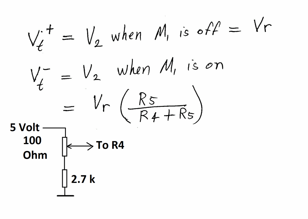

The Vt+ level is set by Vr, so use a pot to vary Vr as in the extract below.
R1 is accociated with the Level Shifting Amplifier. So don't touch it.

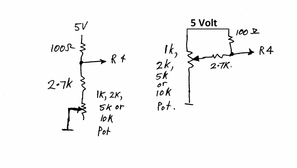

If you don't have a 100 Ohm pot, then consider one of the options below.
The important point is to keep the Thevenin resistance low.
I don't want it to exceed 100 Ohm otherwise it will affect the hystersis. It needs to be much less than R4.
Let me know how you go as we may have to change the Amplifier resitors bt=y a small amount in order to bring the level adjustment into the correct range.
Len
Edited by larny 2012-05-10

The pots mentioned in the circuit are the Vrefs as voltage dividers (not so bad) and the hysteresis selection which you had as an 82K resistor in a post on the previous page, this is the one that was causing problems.

I have attached a modified version of the Sim circuit that I think you're talking about with suggestions added.
Note that putting a Pot in series with a fixed resistor gives you a finer adjustment range & also avoids having the Pot connected to the Op Amp input.
Len

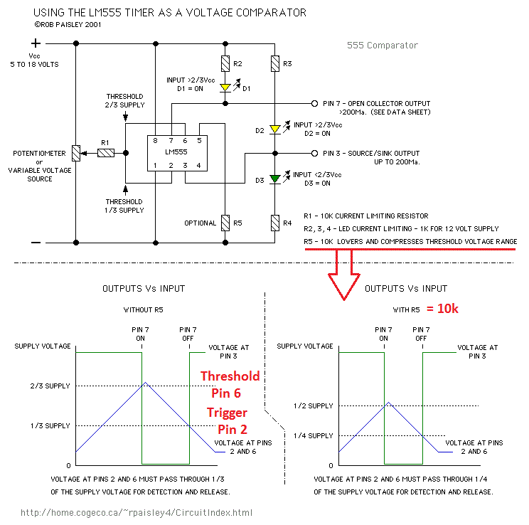

I have been thinking about the possibly using the 555 as a Schmitt Trigger.
I found the circuit below on an internet site that explains how it works as a ST.
I added some notes of explanation.
You should also look at the 555 Data Sheet.
Len

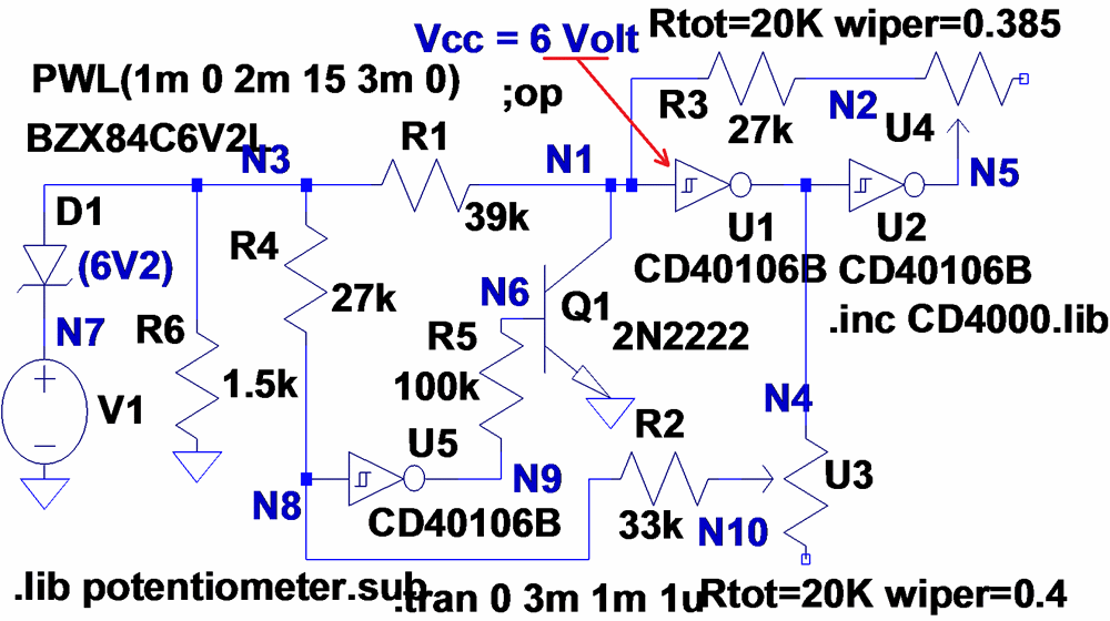

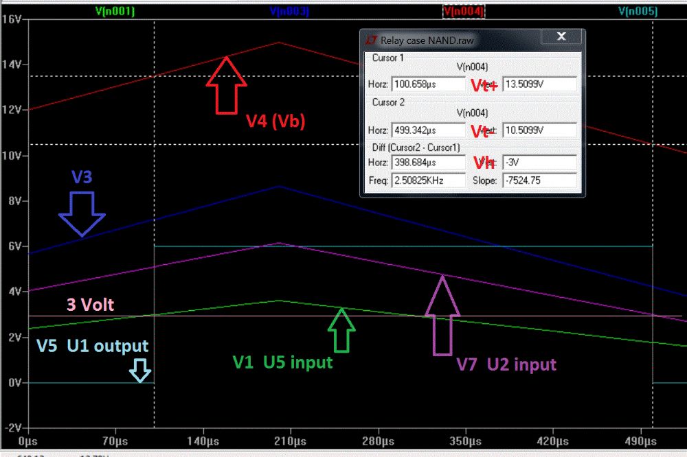

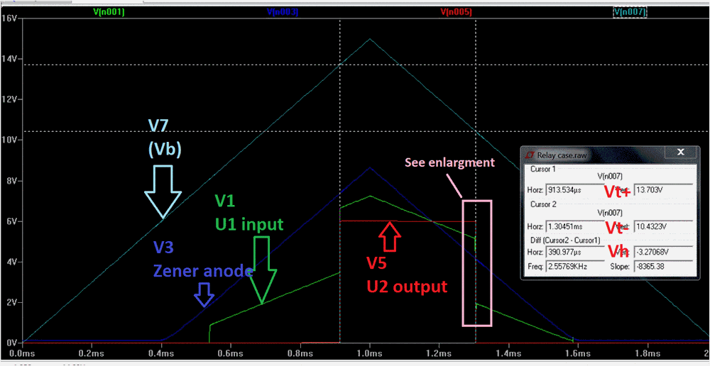

After considering numerous options, I have decided upon the one attached.
You can do both the shunt and relay cases with the one IC since the 40106 hex Schmitt Trigger has six STs in the one package.
There are other types of hex Schmitt trigger such as the 74C14 etc.
You don’t need any input protection, since they have internal protection diodes.
The relay case circuit will be very similar with only minor changes, I’ll post it either tomorrow or next day.
I have used a Zener diode to shift the level in order to reduce the attenuation that would occur had I used a resistive voltage divider.
Zener diodes have a low slope resistance so there is virtually no attenuation due to the Zener.
U1 and U2 are configured as a Set/Reset Flip Flop. It is Set when the voltage at N1 rises to the positive going threshold of U1.
The positive going threshold is determined by D1 & the R1/R3 + U4 voltage divider and the positive going trigger level of U1.
When the voltage at N1 rises to the positive threshold of U1, the output of U1 goes low thus causing the output of U2 to go high & consequently shift the voltage at N1 higher than the Schmitt Trigger’s positive threshold.
The negative going threshold is set by D1 & the R4/R5 + U3 voltage divider and the negative going trigger level of U5.
When the voltage at N8 decreases to the lower threshold of U5, the output of U5 will go high.
Transistor Q1 is turned on, this Resets the Flip Flop & so the output of U1 goes high which causes the output of U5 to go low so transistor Q1 turned off & so the circuit is thus returned to the initial state where it is waiting for the voltage to rise to the positive trigger level.

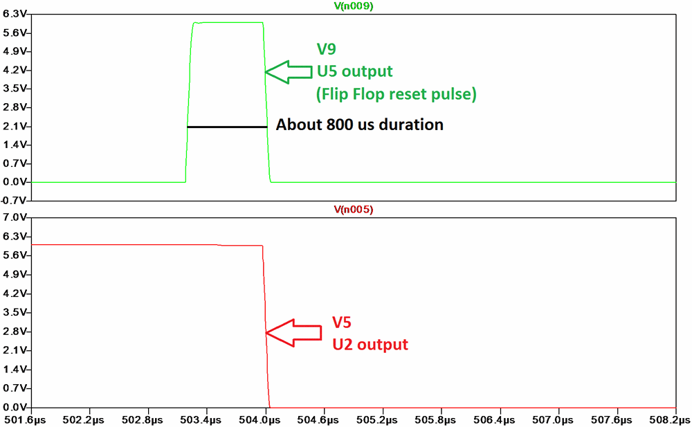

Therefore, Transistor Q1 is turned on a very short time, see the attachment below.
I’ll post an adjustment procedure tomorrow (the threshold adjustments are independent).
Edited by larny 2012-05-16

Jasper,
Here is a zip of the .asc so you can run it yourself.
Len
2012-05-16_133619_Simulation_zip.zip

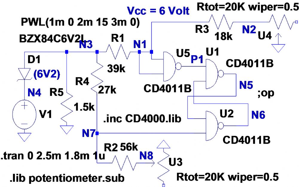

I have built the opamp circuit as at the top of page 5 (I have no comparators to work with atm), and have tested on breadboard, which is a PITA - re dodgy connections... and have the following observations and addendum:
V+ supplied by LM317T set to 7.5V (470/2k2)
With higher V+ Voh is a little higher, and to achieve a smaller hysteresis R9 is 220K.
With various PSU loads and 1.8ohm resistor as a shunt I confirmed that this works reliably... I have tried it with a panel, and it seems very easy to set threshold etc. Unfortunatly the totem pole driver (and direct o/p from the opamp is not driving the logic level fet hard on, so loads of heat)
Is the idea wrong, with ~6V out of the opamp, the totem pole is only giving 3.75V to the fet whether the top is connected to the rail (14.4V) or Vref (7.6V)? BC547B BC557B transistors, with 10ohm opamp to base(es)
The relay side with hysteresis seems unreliable, again this could be crap connections on the breadboard...
Will try more later - re fet on hard!
Jasper

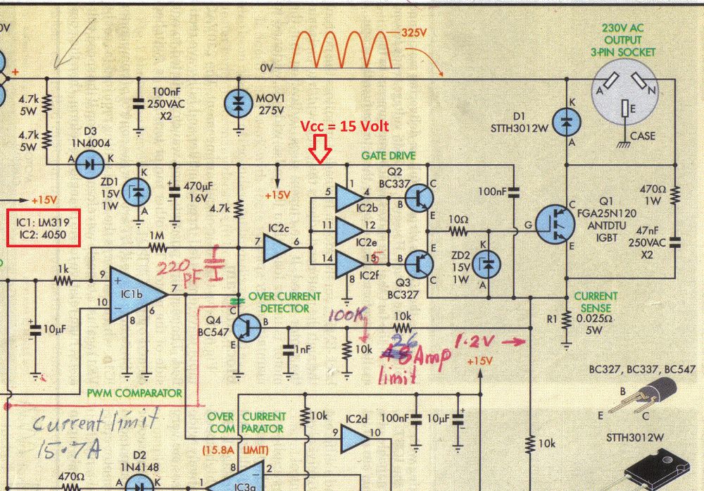

Yes, you need a better FET drive circuit.
I have attached an extract from a Silicon Chip Motor Control circuit that shows their IGBT driver.
Also note their Vcc is 15 Volt.
You are very optimistic expecting to make it work at 7.5 Volt.

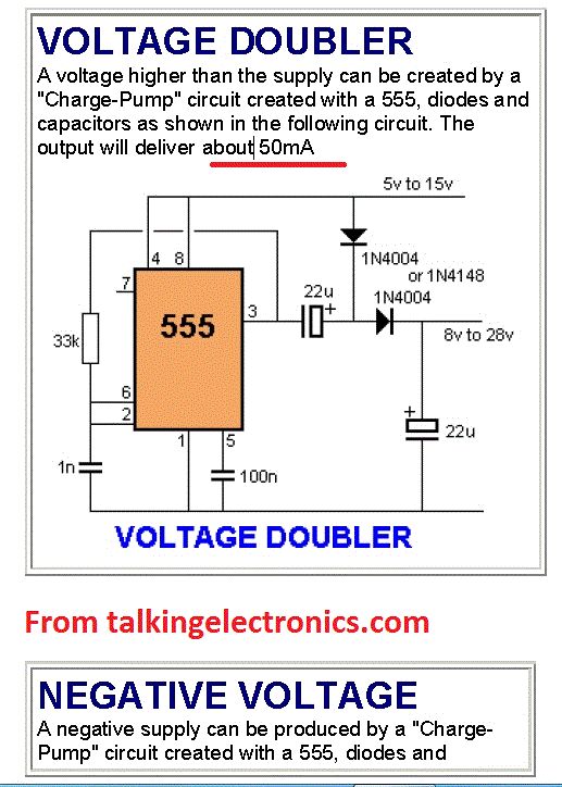

That is one reason why I suggested a DC-DC Converter or voltage doubler some time ago.

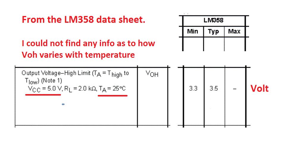

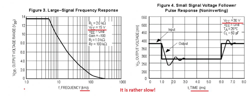

Also, the LM358 is slow.
My recollection is that you wanted the Shunt case to work in the kHz region.
Also, I could not find much info on the variation of the LM358 parameters with temperature in the data sheet.
See the extracts.
These are the types of reasons why I have been considering the use of CMOS.
Yesterday, I conceived a better version than the one I posted above.
Nevertheless, you still need to be able to drive the FET properly.
A 15 Volt supply would make a big difference.
It would also assist with the small hystersis you want for the Shunt case as:-
1. there would be no need to do much level shifting (if any).
2. there would less scope for temperature changes to upset the apple cart.
Len

Here is a simple voltage doubler from the 50-555 Circuits.pdf that I downloaded from talkingelectronics.com

OK, changing R4 to a 500K pot, and making sure all contacts were good, after a real PITA callibrating I found that the larger hysteresis/relay part of the circuit is indeed reliable! All good, so It all works. Need to find a semi dead battery to test it on now.Edited by SpmP 2012-05-22

I'm currently thinking about using 555 ICs.
It has well defined thresholds & looks promising. Also, it can drive the relay directly in the "Relay Case".
I agree with Tony re the CMOS Schmitt Triggers, they have a wide threshold spread.
That's why I started to think about using non Schmitt CMOS gates.
Here is a CMOS NAND gate option (it can also be done with NOR gates).
Note that the Schmitt Trigger action is done by the Flip Flop formed by U1 & U2.
So it switches very quickly.
You could use either a Quad 2 input NAND Package or a Triple 3 input one.

I rather like the 555 idea, very ingenious.
The 555 has rather a lot going for it, and it is a solution I had not thought of myself.
It's all there. Two proper voltage comparators, well defined switching thresholds, and a set/reset flip flop, plus reasonably high output current capacity.
