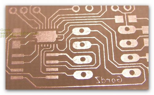

OK bit rushed for time this morning but got the Xerox P205 (1200 dpi) and did a quick test PCB using P 'n' P ( ragged etch when you rush ) and here is the result. Printer actualy cost $48 because the special is finished and I could not be bothered ordering one.

For a 'ragged" etch that looks pretty reasonable Gordon - those tracks look quite fine. The toner they use must be OK for our use too or you wouldn't have gotten that far with it. 1200 resolution isn't shabby either so I reckon it's a goer. Pity about the extra $18 but it's still really cheap - think I'll head out now and get one.
Thanks for getting it and doing the test for us all.
