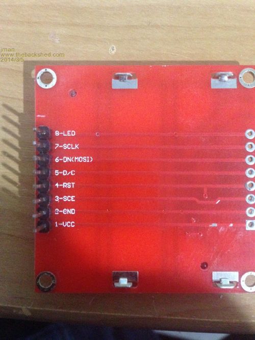

hmm i need a schemata , pin layout because my lcd looks different
jman
Joined: 12/06/2011
Posts: 711
Posted: 08:24pm 04 Mar 2014
  plasma said   hmm i need a schemata , pin layout because my lcd looks different
Hi
My LCD's look like this
Connect like this this for 28 Pin uMite
LCD uMite
7 SCLK (SPI Clock) Pin 25
6 D/C (data command) Pin 5
5 DN(mosi) SPI Out Pin 3
4 RST (Reset) Pin 4
3 SCE (Chip Select) Pin 2
2 Gnd -ve
1 Vcc +3.3V
Jman

Posted: 06:48am 05 Mar 2014
thx a lot jman , post my result later .
thx
plasma
Joined: 08/04/2012
Posts: 437
Posted: 05:13pm 05 Mar 2014
ive ordered 3 pieces but it looks like 2 are buggy !
booth shows some wandering bytes
the last is working finally
thanks jman

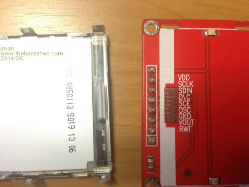

Hey Jman, Is it possible to get just the display units NOT mounted to a board so that you could design them onto your own..? I haven't spent time looking up some of the newer displays being offered yet... Hummm .. I'll do that...
jman
Joined: 12/06/2011
Posts: 711
Posted: 08:53pm 05 Mar 2014
It's real easy to take the LCD off the adapter PCB
They use a Elastomeric connector I have taken one apart to
