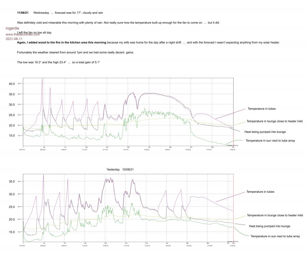

Here are today's results. Started off all drizzly, gray and raining until lunch time and then improved.
I was quite impressed that the output got as high as it did as quickly as it did, once conditions improved.
As mentioned below I did stoke the fire up again this morning at 9am  ...  but did not add any more until this evening

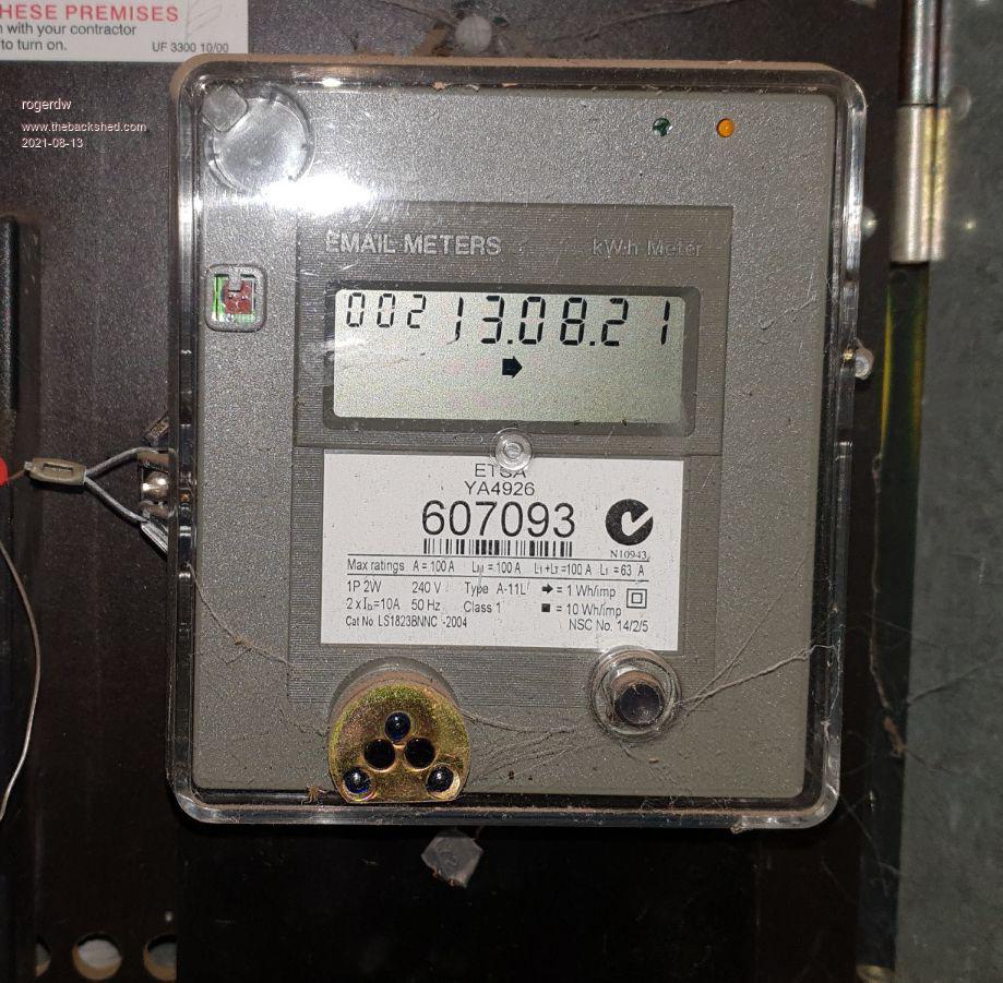

You said you had electronic Meter(s).  While they won't wind back, back feeding with a regular  GTI will  feed your demand and stop you paying for the power... with MOST meters.  Some will charge you no matter which way the power flows, I'm unfortunate enough to have one of those but you can easy look up what you have and test them anyway.
If your meter is within 10 Years, it should be fine, If it's older it -may-  record a charge bi directionally.
If you have the newer type, You can back feed to your hearts content and that will offset any usage at the time with power from the solar so it will still lower your bill. 5kw Inverter with 10 Kw of panels would probably cover all your Loads including welding on a sunny day.

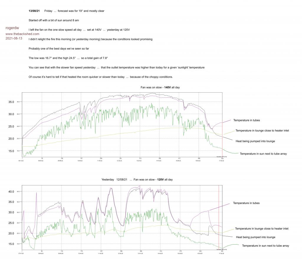

Thought I'd add today and yesterdays results together.
Was happy with yesterdays  ...  but elated with todays.
Cheers,  Roger

  Davo99 said  Something I clear forgot Roger....
I imagine it's still the one that was installed when the house was built about 15 years ago  ...  I'll have a look and see what type it is, though I have no idea how it would respond.

Here's a photo of my meter Dave  ...
...  and seeing the ETSA name reminded me I had thought of a name for my heater  ...  an ETSA  ...  Evacuated Tube Solar Amplifier  ...  or ETSAH  ...  Evacuated Tube Solar Air Heater

Couldn't Find much on that meter other than it's an Email/ Ampy/ Landis and Gyr ( they changed their Name then got bought out) model A-11.
By the directional Arrow on the thing I would suggest it's Bi directional... which is good.
Not hard to test them, hook up a GTI and see if the arrow Changes Direction and if the thing counts up or Down.

Your suggestion about the arrow made me wonder  ...  if you look on the front, after the arrow it shows 1 Wh/imp  ...  and then a square block with 10 Wh/imp. Any idea what those units are about?

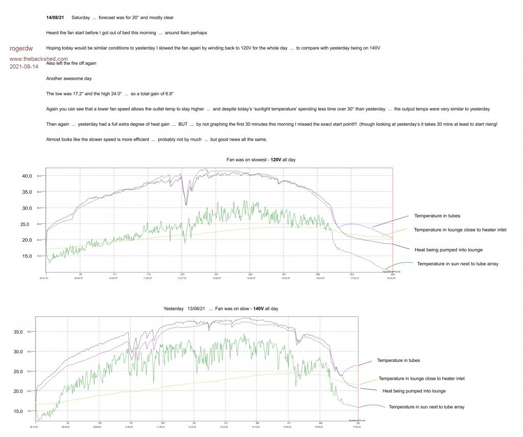

Well time for todays update.
Only thing different today was that I ran the fan slower than yesterday to see what happens  ...  on 120V instead of 140V.
And coz I slept in, I missed the first half hour of activity.
Another beautiful day and very happy with the results again.
Cheers,  Roger

The graphs are a bit difficult for me to clearly define but if the green and very squiggly line is the temp of the logger that is in the sun next to the tubes, why is it so erratic, showing swings of up to 5o if the day was clear?
I'd expect that to look like there was a constant shadowing and then full sunlight all day. Is it just a logger anomaly or something else I have missed?
Oddly, where there was an obvious dip due to a large cloud as I take it, the in sun temp  did not vary nearly as much as the tube and output temps.
The 6.8o temp rise is still significant but how did the higher output temp feel? were you in the house enough to make a judgement on comfort level?
I believe the arrow and the block on the meter indicate unit blocks of measurement now you come to mention it. I surmise that LED at the top right flashes with the power use.
More power the faster it flashes.... to a point.  The arrow is basicly the low range and the square is the high range.
You can count the flashes to determine the approx amount of power being consumed. Obviously of the flashing gets too  fast that's not possible so the meter switched to the high unit count so each flash represents 10x more power  when the block is shown than when the arrow is.
I have a meter in my collection that is probably s slightly newer meter that uses an arrow to show direction. It's quite handy actually for experimenting with IMAGS to see which way the current is flowing although an analogue meter would be better but yet to come across any.
