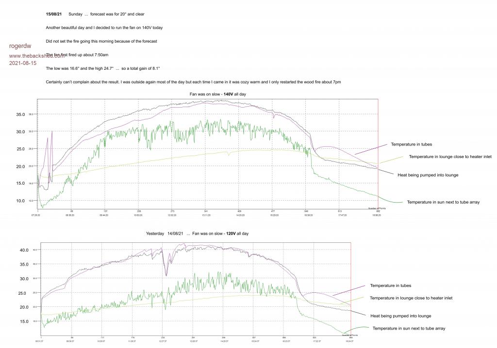

Here's todays results  ...  another high if I remember correctly  ...  8.1 degrees
Of course helped by the fact that it was a beautiful day.

  Quote  Here's todays results  ...  another high if I remember correctly  ...  8.1 degrees
I -THINK- you had an 8.2 one day but irrelevant.  With the high you are getting, you are approaching or at as high as you would want to go anyway.
You could get the place warmer for better heat soak but I see drawbacks in that... like the ones I am seeing.
Great to warm the place right up or even be out in the sun as I have been last few days actually working up a sweat.  Problem is, one comes in, Thinks it's Chilly in here then discovered it's warmer than what you have been running the place all winter and thought it was fine.
I was almost blinded yesterday when I went out and saw this intense Reflection.  Thought it was a Mirror fallen off a space craft or something that had landed in the yard but turned out just to be the Mrs and Daughter pretending to be Albino solar  panels laying on the lawn chairs.  Man they are pasty white!
Problem was they came in and were also complaining of the place being cold. Acclimatisation  can work for and against you.  You may get the place too warm through the day then that 8+ degree drop is going to feel icy. They will have you stoking the fire like the boiler on the Orient Express.
The temp rise curve on this heater seems pretty gradual ( can't make out the times on the graph) But you'll certainly hit that a lot sooner  with the big unit.  You may want then to speed up the fan so as to get the heating power without getting too much temp rise or use another damper to mix the air to maintain a set  temp.
This would help  heat soak the place without Slow roasting the Budgerigar and the Goldfish.

  Quote  The temp rise curve on this heater seems pretty gradual ( can't make out the times on the graph) But you'll certainly hit that a lot sooner  with the big unit.
Yes, it is a slow process and hopefully the big one will be a lot quicker.
Sorry about the time scale  ...  coz the loggers record every minute, it spits out the data as a number of 'points'  ...
The problem is that the related time scales aren't anything sensible like every 10 or 15 minutes  ...  so I have to physically type in the actual times for every chart  ...  just too time consuming to do.
I find that if I'm reading it on a pc  ...  I hold down the ctrl key and roll the mouse thumbwheel to zoom in so I can read it. It's a nuisance, but it works well enough.
Yes I tried that but it just goes all grainy due to lack of res.  Not to worry.

  Quote  Yes I tried that but it just goes all grainy due to lack of res.  Not to worry.
Yes, I'm sorry  ...  I think it used to be ok but as the image has got bigger the file size has too and it won't upload  ...  so I had to reduce the resolution for it to go through.
