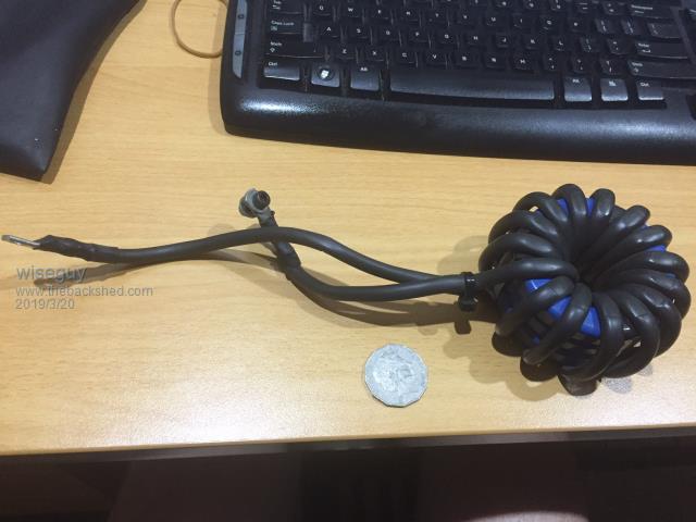

Hi Tony, I have been playing with a Toroid from a commercial 4KW inverter (possibly originated from Sola) 72VDC input Sinewave 240V output. The Toroid is a stack of 3, A-866142-2 Blue Toroids which I think were Arnold cores, it appears Micrometals number is MP-300125-2. The cores are each ~ 80mm OD, ~50mm ID and ~13mm High
This core has a total inductance of ~70uH with 15 Turns & has very low losses in the saturation tester to 60A, equating to ~ 900 Ampere Turns. Saturation is relatively soft to beyond 100A albeit with increasing losses. It is much better than the large 70-54-32 Ferrite cores I was investigating.
They are also dead silent unlike the gapped Ferrites which were more like a loudspeaker......

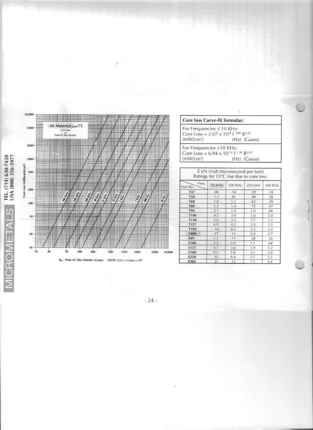

What information did you use to determine the temperature rise of the 26 & 52 material toroids - can you apply the same magic to these cores ? Data P64 Here
Also I have been considering a scheme not running 4 FETs in each bridge leg in parallel. Instead, run 4 separate bridges (1 FET each leg) from the same drive signals and drive 4 smaller (toroidal?) chokes in parallel and then re-sum them together at the main power toroid. Itopower has also mentioned a similar scheme for his 3 winding primary. It would appear to have a few benefits, solve the issue of 1 FET carrying too much current due to on or off speed mismatching when all in parallel. The chokes are also easier to wind and 4 smaller ones are simpler than 1 big choke. The oscillations from paralleled Mosfets should disappear also.
I look forward to your comments.

Micrometals publish loss curves for all their powdered iron grades, but it gives figures of milliwatts per CM cubed which is not very helpful as far as estimating temperature rise goes.
In the previous picture I posted (above ^), down in the bottom right hand corner are some figures for volt microseconds per turn ratings for 15C rise. That is for 26 material.
We can assume 48 volt square wave 23Khz which is 43.4uS per cycle. Maximum loss will be at 50% duty cycle or say 21uS. So the core sees 48v for 21uS in one direction, then 48v for 21uS in the other direction. That would be 1,008 volt microseconds.
Its not actually not going to be quite that bad, because the PWM is a modulated sine wave.
Anyhow we could say that the picture above tells us that a T400 core will rise by 15C at 50Khz at 17 volt microseconds per turn.
Our requirement has 1,008 volt microseconds.
So the minimum number of turns required for 15C rise would be 1008/17 or 59 turns (on one core at 50Khz).
Clearly we are not able to do that. But we could stack five cores and have 12 turns and be spot on for 15C rise. That may not suit our dc saturation requirements, but we can juggle turns and number of toroids to get a workable soloution.
Powdered iron is good material for very high dc current, but its lossy, and does not like high ac voltages or high frequencies. Temperature rise is always a concern.
Molypermalloy is a much better material in any grade, but its much more expensive than powdered iron. The ac losses will be very low in any choke application, and not even worth bothering with to work out in most applications, except at very high voltages and very high frequencies.
Ferrite has even lower losses still, but its hopeless for dc applications, it just saturates far too easily. Its much better for high frequency inductors and transformers where its all ac, with zero steady dc bias.
If you have molpermalloy or can get it free, you are in luck. If you have to buy it new in the larger sizes be prepared for a shock.

In my experience for given on and off times and reasonably matched inductors the currents will ramp/fall & generally share very well. Given the worst case of max output load and highest input voltage we just ensure the inductors dont saturate - that is the mechanism. Im sure you agree that for a given input voltage and on time and inductance value the current ramps should all be equal (ignoring tolerances).
In a recent (current fed topology) converter I designed, I had two EE55 transformers fed from the one bridge stage, FETs as output current doubling rectifiers (no TX centre tap) and 4 inductors. The output was 13V6 @ 60A from a 72VDC input, with ~ 95% efficiency at full load.
Current sensing was done just on one EE55 transformer leg and was essentially half the total. If we reduce the inverter choke to 4 smaller chokes, as the current is now a quarter of the original the choke cores can be shrunk & the inductance can also be increased accordingly.
The power PCB and heat-sink would not be a lot different to the current layout just re-distributing the connections on the PCB to be 2 3 or 4 separate bridges. In the case of separate power modules & heatsinks, the on resistance should only have a very minor contribution to the applied voltage / inductor / current ramp result. I would also expect that due to the positive temp coefficient of the FET resistance should help to ensure they share properly. Edited by wiseguy 2019-03-21
