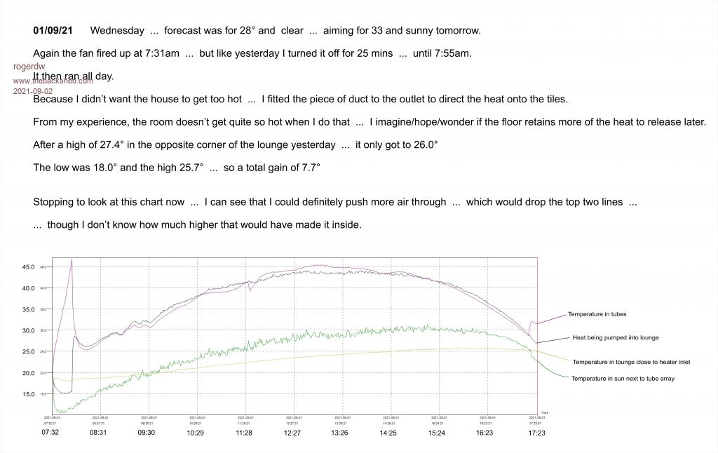

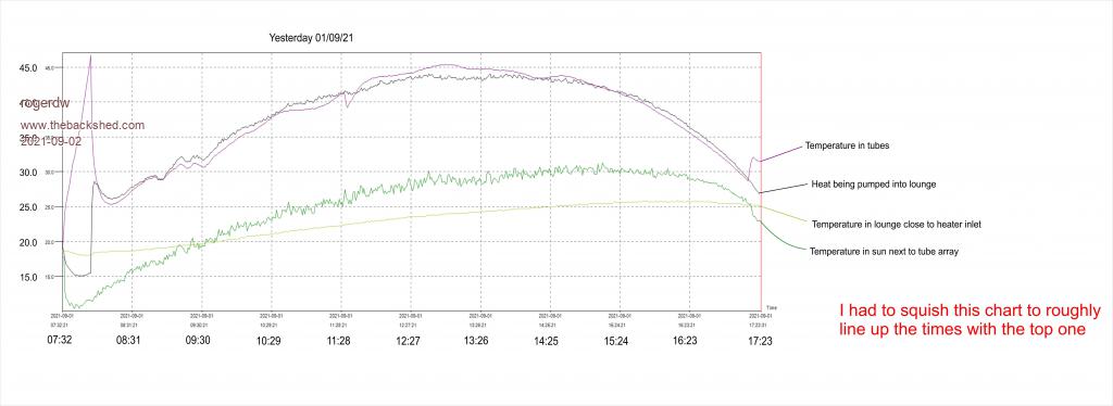

Morning all  ...  I forgot to post this last night.
Was certainly a very nice day here for the first day of spring.
I had put the extension duct on the outlet so the air blew straight onto the floor tiles for the day. The overall room temp max was a bit lower than the previous day.
Our forecast for the next few days are (today 33) then 17, 16, 16, 18  ...  so I'm keen to follow Dave's suggestion and get the place as hot as possible today to carry us through.
I didn't bother relighting the fire last night either for the first time in several months  ...  though I plan to tonight so we don't lose too much with this next cold spell.
I heard the fan fire up earlier again today at 7:22, so I got up and switched it off until I'd had my shower etc. Switched it back on at 7:48.
Cheers,  Roger

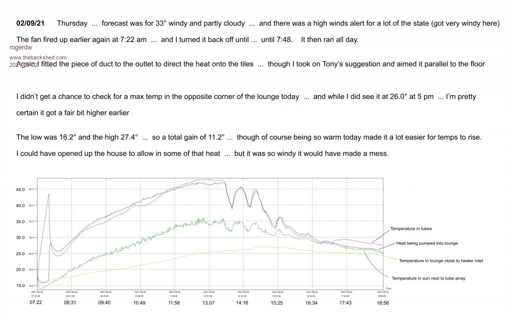

That is a very solid twenty degree rise, very impressive.
More air will always be better for heat transfer, especially so when the larger system is finally up and running.
Aiming the airflow down at the floor is o/k, but what you really want is for the air to blow horizontally right at floor level directly across the floor.
Cheers,  Tony.

  Warpspeed said  That is a very solid twenty degree rise, very impressive.
Thanks Tony.
Yes agreed about the airflow. Just at the moment the 50 watt fan is a bit light on, but the 400 watt one is overkill  ...  plus a lot noisier.
I just stretched out the piece of ducting some more  ...  and now I have it blowing horizontally across the floor. Thanks for the suggestion
I did measure the tile temps around 11pm last night  ..  and also did the bare feet test.
The tile in front of the heater was at 24  ...  though the heater had not been fed since 24 hrs before.
The tile that the hot air outlet blows on in the lounge was at 22.7  ...  while adjacent ones were at 21.3.
Very little difference from the hot air  ...  though it was 6 hours since the hot air shut off  ...  and believe it or not   ...  the 21.3 tiles felt cold to walk on  ...  but the 22.7 was quite comfortable to stand on.

Here's todays results after a forecast of 33, windy and partly cloudy.
It did get uncomfortably warm inside  ...  but being aware the cold change is due tonight meant it was easy to put up with  ...  plus all in the name of science.
I think I mentioned I didn't relight the fire last night either  ...  though I plan to do it soon, only because we know the temp is supposed to drop significantly for next 3 or 4 days.
EDIT: I should also mention that it's 10pm and still 23 degrees here in the kitchen.

So given the right Conditions, This setup still has more to give... albeit when you don't need it.
Maybe for the turn on You need something like a timer that doesn't allow the fans to turn on before say 8 am.  After that they could turn off and on much as they liked till say 5 or 6 pm where it reset.
I am still confident the new setup will have an exponential effect. if the system is 4 times bigger I'm still thinking you will get 4X+ more heat out of it.
Lets see how this goes the next few days when you will want it.

I should report on what the heater's been doing lately.
The weekend was pretty ordinary with 16 and 17 plus rain and cloud  ...  so nothing spectacular as far as results go  ...  though still effective to a degree.
Last couple days have been beautiful weather and the heat has been pouring in.
I came in at afternoon tea time today and couldn't believe it  ...  it was 29.0 degrees in the lounge. I asked my wife if she was hot yet  ...  and she pointed to her ugg boots and jacket and said well I'm not too warm.
I had to take my coffee back to the workshop to drink, too hot in there.
It went from a low of 19.0 to a high of 27.9 at the air intake in the lounge. The 29.0 was in the other corner adjacent the passage  ...  and is usually nearly 2 degrees warmer than over at the window.
It's been really cold in the workshop at least until after lunch. Beautiful outside, but just cold inside. In fact yesterday I came back in at morning tea time and put my long johns on.
I can see this heater being perfect for the workshop. It will turn on by 7.30 and even if it isn't much warmer than the inside temp, it won't matter coz I don't generally go out there until about 9  ...  and by then it's often pumping 35 degree air already  ...
...  and I can see I'd need to shut it down once it gets comfortable as the room retains the heat so well. In fact I'd probably get away with a system half the size  ...  but will still be handy to have the extra potential for those poor solar days.
EDIT: These last couple days are a perfect example of 'heat soaking' the house. While it was a bit over the top  ...  it certainly keeps the cold at bay far longer  ...  and using less and less wood.
Edited 2021-09-09 22:52 by rogerdw
Cheers,  Roger
