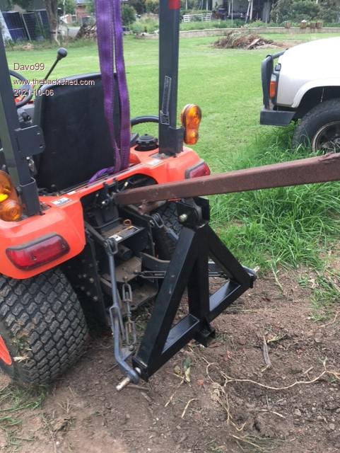

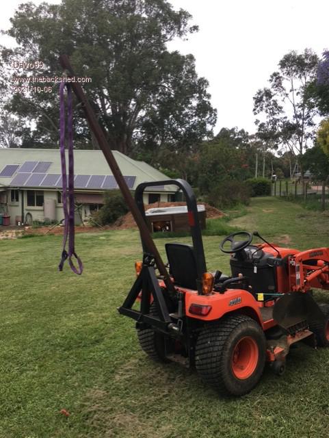

Yesterday I had a bit of a run around with am LPG Flame weeder. Same as your soldering Iron I think.  Had the thing cranked and it did a god Job although clearly goes through the gas.
I was thinking, I could do the same in an Oil burner and Mount it as a Unit on the back of the tractor. I haven't got THAT much to do but it would be good at dads or a larger property like yours.  I have seen huge boom flame weeders that carry an LPG tank about the Size you'd see at the local Servo for filling up cars but something more modest with a Single  outlet would be more appropriate for edges and fence lines rather than whole Fields.
I could run a Jumping castle blower off an Inverter Connected to the Tractor Battery.
No idea what the weed burner does flat out, maybe 20 KW but I could have 100-200 coming out an oil burner with no problems what so ever.  That would be thick enough to take out heavy green grass and do it a Reasonable pace I think. At the right time Fire would not be a problem. Where Dad is the rain has been coming every few days for months.  In any case, wouldn't be hard to put a small pump and a tank of water either on the burner setup or throw it in the tractor Bucket if it were needed.
Thought I might give it a go. It's really only a packaging setup.  Easy put a 60L Drum of fuel on a pallet with the burner, blower, fuel pump and inverter. The Americans might like it for Ice removal from pathways or something. Even at 200KW, 60L of oil would give a good 2.5Hrs run time with some to spare. In any case, if one needed more just throw on a 200L Drum and go out for the day or crank it up and Flame weed those pesky 100Ft Gum trees.
Speaking of which, also thought about something similar for a Stump remover.
I think a Burner could be adapted to work well.  People put oil and pile wood onto stumps to burn them but from what I see, that's pretty counter productive. They burn the Oil or the wood but that takes up Oxygen that stops the stump itself burning very much. All it really does is impart heat for most of the process and don't really do much till the additional fuel has burned away. The other thing is without forced air, the wood chars and insulates the wood underneath which further inhibits burning.  Extremely Inefficient. With forced air the wood would burn and have extra oxygen and the ash would be blown away so fresh fuel in the stump would be exposed.
Can't see why a Dry stump couldn't be burnt in hours.  Seen people trying to burn them out for weeks piling wood on top and the things are still far from gone.
With the air coming from above, the heat could also be recycled as it were back onto the stump so as to help drive out moisture they often suck up from the ground which makes them rot in 10 or 20 Years.  Only have to get an inch dry on the surface if that for the stump wood to burn.

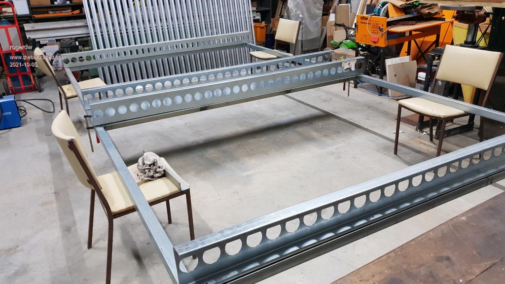

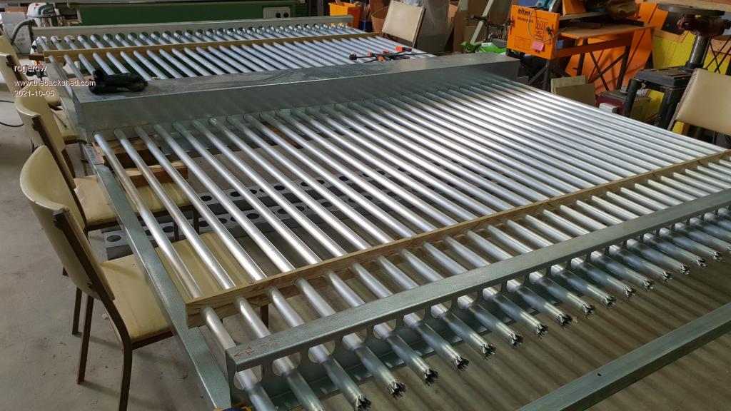

Well I finally did a bit more work on this device.
I marked out and drilled all the holes for the c-section beams to bolt to the main frame.

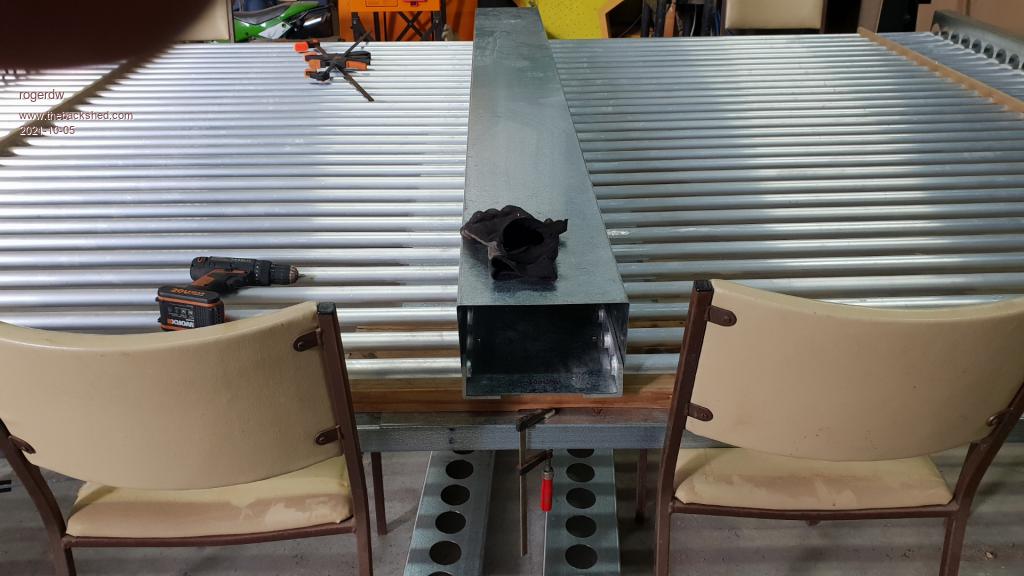

I lined up all the tubes and fitted the cold duct cover and in the process discovered that the angle had bowed up in the middle from overheating during welding.
So I braced it all with timber, put a block across the top  ...  and wacked it with the sledge hammer.
Whoops, a bit too much strength  ...  and it was then bent the opposite direction about an inch and a half. A bit of gentle levering with the crowbar soon had it staight.
Despite being 60 x 60 x 6mm angle, it is surprisingly easy to bend.
I drilled all the top cover holes which was difficult because I had to reach way over into the middle, but I got it done. I was nearly going to do it before I welded in the tubes, but a friend warned me that it was likely to warp  ...  so I'm glad I left it till after.
I have to chase up some foam suitable to insulate the inside of the outer, hot duct  ...  probably about 50mm thick  ...  and able to cope with lots of heat over summer. Anyone have any recommendations?

  Quote  Despite being 60 x 60 x 6mm angle, it is surprisingly easy to bend.
Heating it up to do the brazing has annealed the aluminium. It will be very soft and bendy, but over time it will very gradually recover and become stiff again.
Cheers,  Tony.
Davo99
Joined: 03/06/2019
Posts: 1586
Posted: 12:49pm 05 Oct 2021
Seeing it all laid out with the chairs for reference, really does put into perspective what a Sizeable project this is!
It's quite an undertaking Roger and a huge credit to your drive and ingenuity with it.
It certainly did get hot in the brazing process, so not surprised it affected it somehow.
It shouldn't be too much problem because they are all screwed together with the base and the duct cover  ...  and there's no weight or stress on the tubes hanging out. It will definitely continue to get hot, especially during our long summers.
  Davo99 said  Seeing it all laid out with the chairs for reference, really does put into perspective what a Sizeable project this is!
Thanks Dave, and you're right it is a big project. Certainly takes up a lot of room in the workshop.
I have been wondering if I should consider assembling it fully except for the glass tubes  ...  then hiring a crane to lift it on the roof. I have a friend with a telehandler that extends out about 50 feet  ...  except he's half an hour away.
Anyway, I still need to finish the assembly before I worry too much about it. And too many other jobs getting in the way. Now with daylight saving I already spent 2 hours on the tractor with the slasher after work last night.
Cheers,  Roger

May have mentioned it before and if so forgive my poor memory.
Could you make up a simple Jib Crane for your tractor? Really all you would need is a Good length of  square Tube or maybe even Timber.
You just replace the top Link on the 3 point hitch with the beam which extends out the back.
I think your tractor is a pretty decent size and the Frame for the heater would probably be under 100 Kg I'm guessing, so you should be able to hang it right out the back and get good lift and reach.
You can get the beam near Vertical so as long as you can get reasonably close to the house,  You should be able to get it well up there.  You would probably only need to get the front edge up then you could release the frame and just slide it over the edge and into position.
Some 40x40x3 or thicker should do it and you could go 3, maybe 4M long.  I put ball ends on mine for where the pins go but I wanted to use mine regularly where as you could just bore some holes  for the pins for an occasional one off.  You wouldn't need a frame like mine, probably just leave the slasher or blade on, whatever you have and replace the top link with the jib.
You might even just raise the jib then pull a rope though the end to manually lift the frame then you can release it to lower into position.
I'd use this for lifting solar panels only I can't get  very close to the house because of the retaining wall but it sure would make things easier!

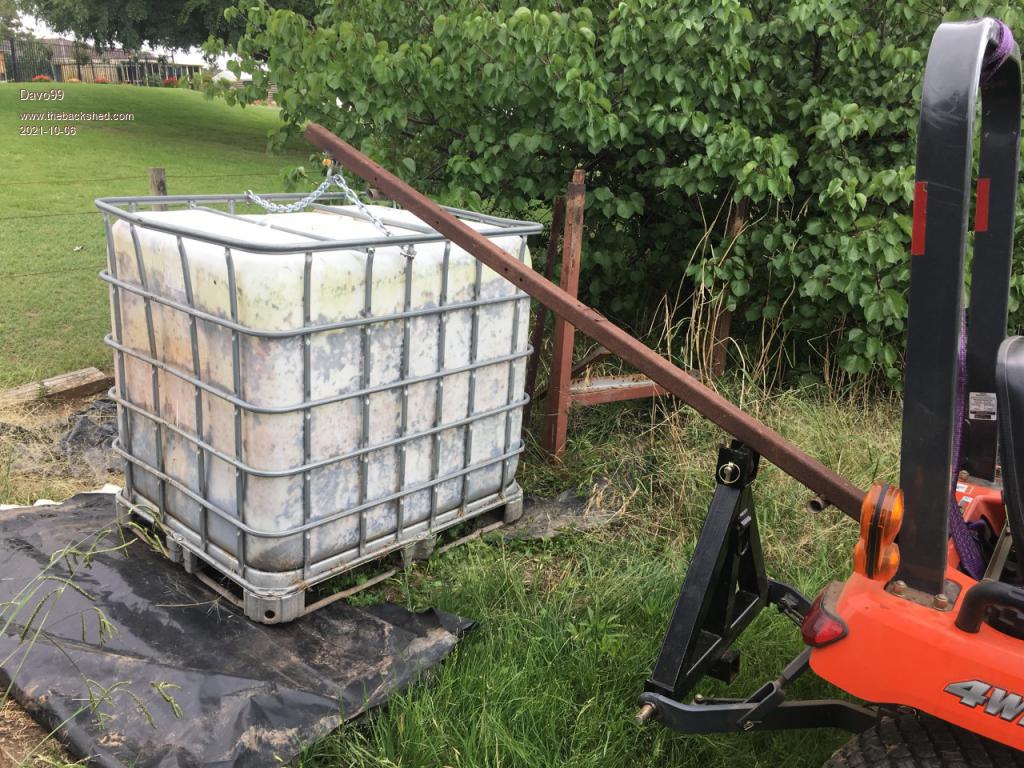

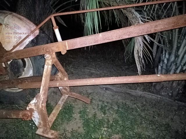

Revlac
Joined: 31/12/2016
Posts: 1309
Posted: 10:16am 06 Oct 2021
Its abit dark outside but this is a lifting jib made out of junk, it needed bracing for extra strength, its connected to a David Brown 990, hydraulics will cutout before bending something, post hole borer on at the moment.
BTW the hydraulics on the DB and other tractors are just on off when lifting, can be fast and violent at the end of the jib.
Used an Excavator to lift most of the things, made a forklift attachment onto a quick hitch.....lifted a lot of solar stuff on to the roof.
Cheers Aaron

Davo99
Joined: 03/06/2019
Posts: 1586
Posted: 01:50pm 06 Oct 2021
  Revlac said   it needed bracing for extra strength, its connected to a David Brown 990, hydraulics will cutout before bending something,
Mine is  about 5MM so pretty thick. Just what I had around at the time.  haven't bothered bracing it because like yours, My little toy tractor gives out before anything has bent.  At the end it will lift a full 240L plastic drum and maybe a little more but that is about it. I also have a lifting point about 2/3rd from the end and it lifts a lot more there of course.  The max I have picked up with it was about 400Kg and that's plenty of component loading for this little thing.
  Quote  BTW the hydraulics on the DB and other tractors are just on off when lifting, can be fast and violent at the end of the jib.
Yeah, that sounds hairy.  Dads new little JD 1025 has a height setting on it. You move the lever to a certain position which you can lock off and pull the lever back and that's where it goes and stays every time.  Mine is just an adjustable speed control. Keep going till you let it go unlike the JD ( and usually bigger tractors) where you pull the thing all the way back and it goes so far and stops.  Useful feature.
I have the 3 Pt lowering speed control.  Quite handy when I am picking up something like a load of solar panels.  Can screw the valve in and then hold the lowering control and crack the valve so the 3 Point is lowered slow and Gentle.
Of course the stupid people then go and try to lower a load a fraction of the weight and wonder why the thing isn't dropping at all or taking forever.  Glad I have never done that...... more than about 50 Times.  Just reach down and adjust the controls and all good. Wide open the thing will hit at the speed gravity takes it.
  Quote   made a forklift attachment onto a quick hitch.....lifted a lot of solar stuff on to the roof.
I made some forks for the 3 Point given it's far greater weight lifting.  Won't lift very high, maybe 400mm but plenty for a pallet or machinery.
I want to do some forks for the Bucket.  I'll do them clamp on style.  Won't lift much more than about 250KG on the front but that will do.
I am going to shim up the Hydraulics so I get  greater response with the loader and it should  lift another 100KG easy. That would be quite handy not that I will stress the machine with it too often.

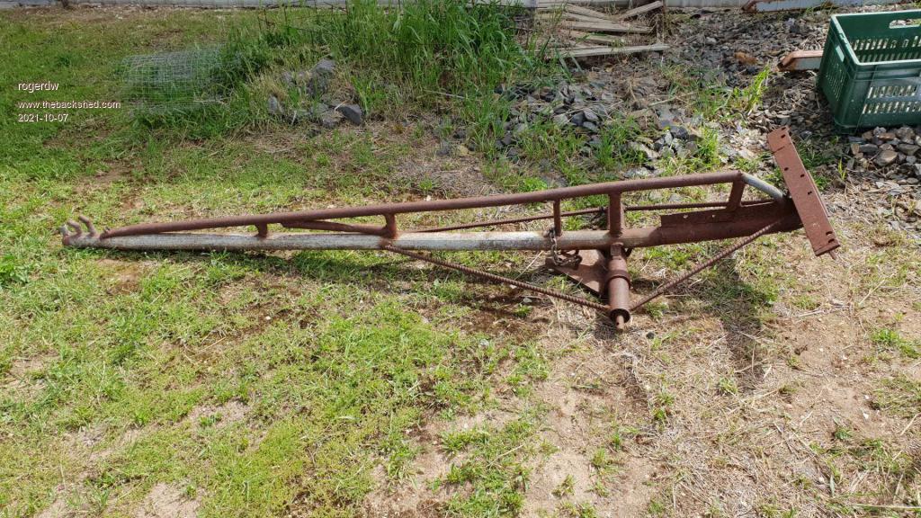

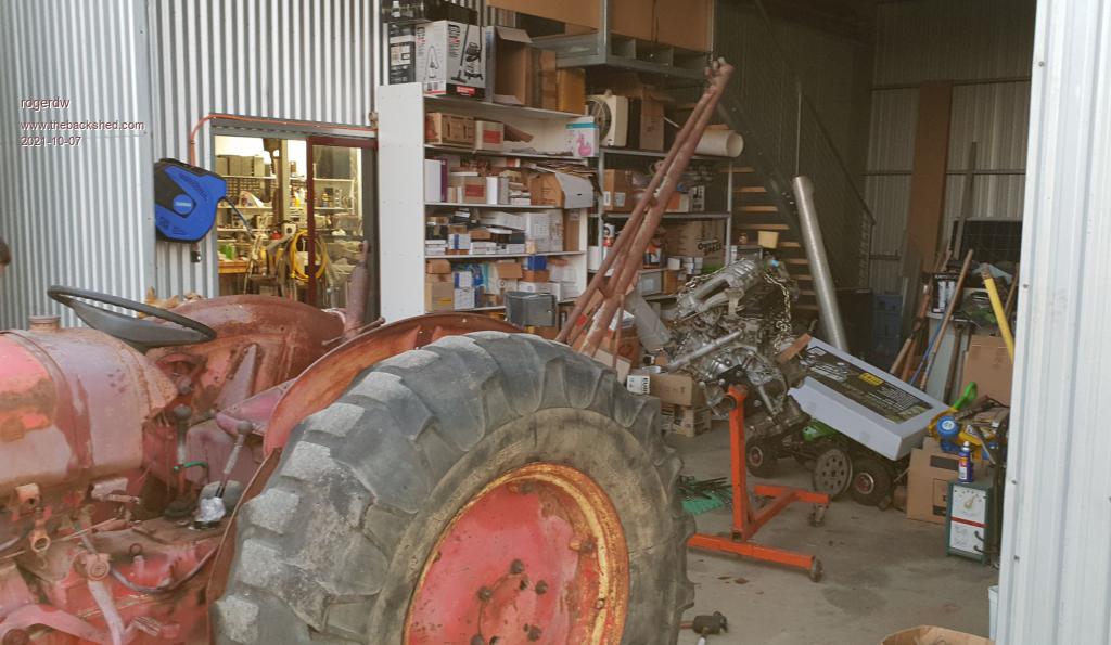

rogerdw
Joined: 22/10/2019
Posts: 957
Posted: 03:13am 07 Oct 2021

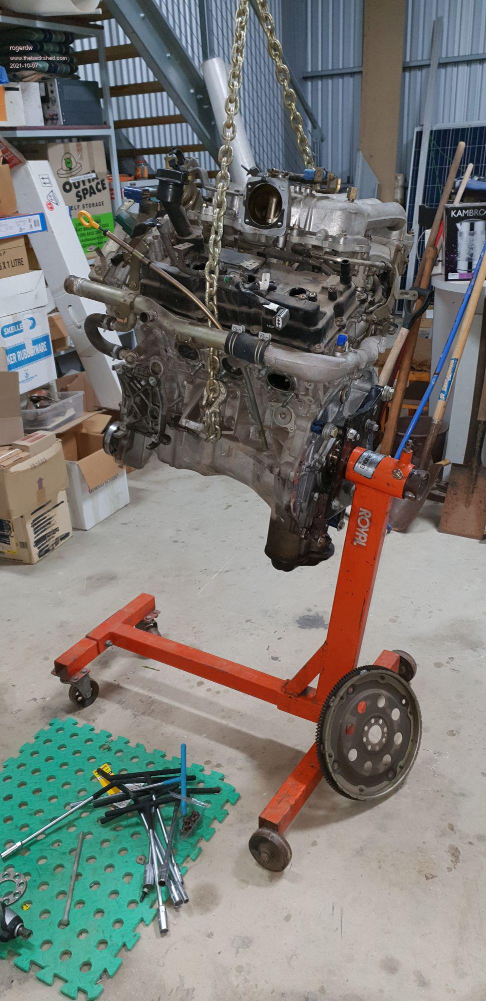

I do have a jib, but can't really get close enough to use it. There's a fence in the way and then not much room to the boundary.
Looking like I'll just slide it up bit by bit and with an extra hand or two should be easy enough. As long as I'm not silly enough to try and do it by myself.
All a bit old and decrepid (like me)  ...  but it still works ok.
I dunno what it weighs but the hydraulics lifted it ok. A V6 Nissan motor out of my wife's van.
Cheers,  Roger

Joined: 03/06/2019
Posts: 1586
Posted: 04:07am 07 Oct 2021
Did it get hot or did the oil light come on and she just wanted to get it home?
Would weigh about 200KG.
I imagine that old thing would lift easy double that, probably over 500 with no problem. The old tractors did what they could and far surpass the new ones of the same size that are severely restricted by all sorts of OH&BS.
Dads old tractor will lift over a tone in the bucket. We looked at a new one and  they are no where near as strong which was a big surprise. Would have to be nearly 3 times the machine  to lift the same which makes it a big and expensive unit.
Looks like a nice Classic Tractor!
