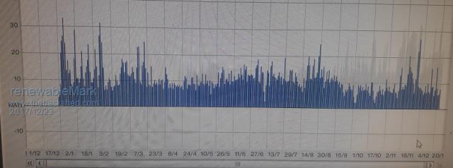

I bought a caravan recently and have been educating my wife on power usage. It's been quite an eye-opener. She normally has 10 lights on through the house and has recently made a real effort to reduce that habit, so I think our own behavior will, in fact, have a lot to do with the bill. Looking at the graph, that bloody old AC is clearly a culprit, once that is replaced with a new inverter unit, those big spikes should be curtailed.
One other thing that contributes a lot is the electric oven, and we use that pretty much every night, just outside the kitchen area is an outside deck which has a pergola over it, the BBQ is there, so that's another option for cooking. Going out there on a freezing Melbourne night wouldn't be appealing though.
Here is 1 year, the average is 10kwh but there are some pretty hefty spikes there.
You can see the last bit of the graph, that's around the time I started using the caravan. Those big spikes are from the AC which I have on solar/battery, but when I'm out I switch it back to mains so the wife doesn't draw the batteries down too much and destroy them. Having a decent battery bank with cut off device is needed.
So I have 7.5kw of solar to go up on the roof and space for another 2.5kw, could fit another 1-1.5kw south and 500w N on the shed if really needed.

Air conditioning is the big killer, because when required it usually must run for several hours continuously.
Other big loads such as electric jugs and kettles, (power tools) and microwave ovens are fairly heavy loads, but only actually on for very short times. Amazingly these use very little total power in the great scheme of things.
Doing an energy audit is for sure a real eye opener, with some BIG surprises.
The real energy suckers are the numerous unsuspected small loads that run 24 hours per day.
Those can often be eliminated or fitted with time switches, modified in some way, or some other strategy applied.
Something like a wall clock or garage door opener can draw 15 to 20 continuous watts, and that really adds up.
Cheers,  Tony.
