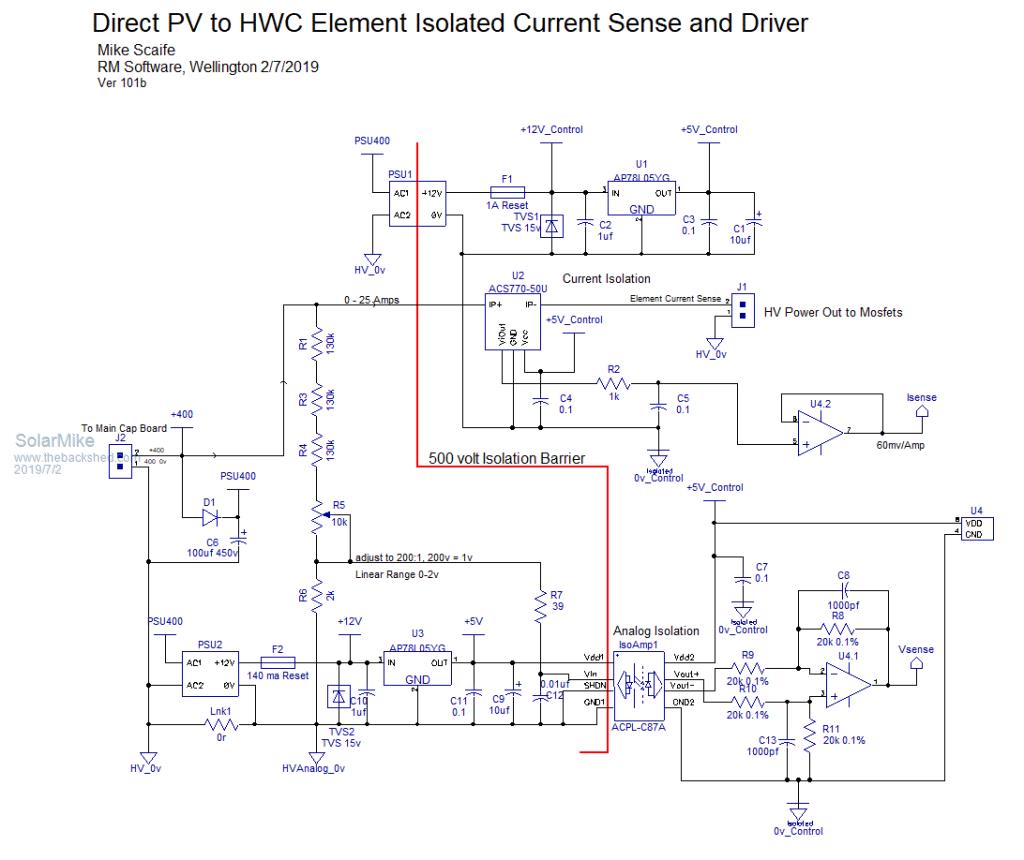

Quite a discussion going on there around the ultra simple circuit; unfortunately the version I'm building has to be semi-commercial in that its going into three sites, one being a community business. So the design has to be idiot proof safe and meet certain standards, any of the parts that users can play with have to be isolated from the 300-400 volts high voltage pv array; I also want it self adjusting to adapt to whatever panels are used without adjustment.
Isolation makes design slightly more complex, current is no problem with a standard sensor chip; analog voltage bit tricky, have used a linear isolation amp here, they have a 2 volt input range 0.5 to 1% linearity.
Proposed isolation stage shown here:

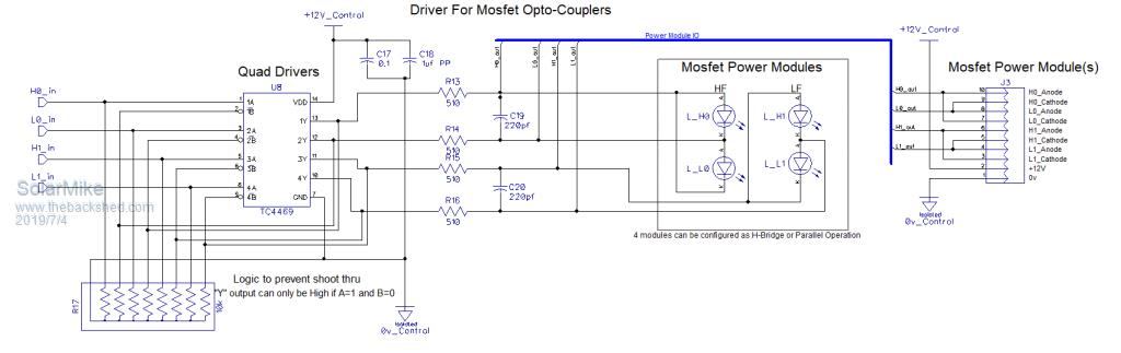

Part of the driver here:
The power module a few posts back already has on it an isolated DC supply and an opto mosfet driver, so four would be required + the above circuit to make it work. The quad driver chip being used TC4469 has four 1.2A cmos drivers on it each with dual inputs, so can be arranged to prevent two outputs becoming high at the same time, over kill for driving 10-15ma into an Led, but its all on one ic so more convenient.
Mike

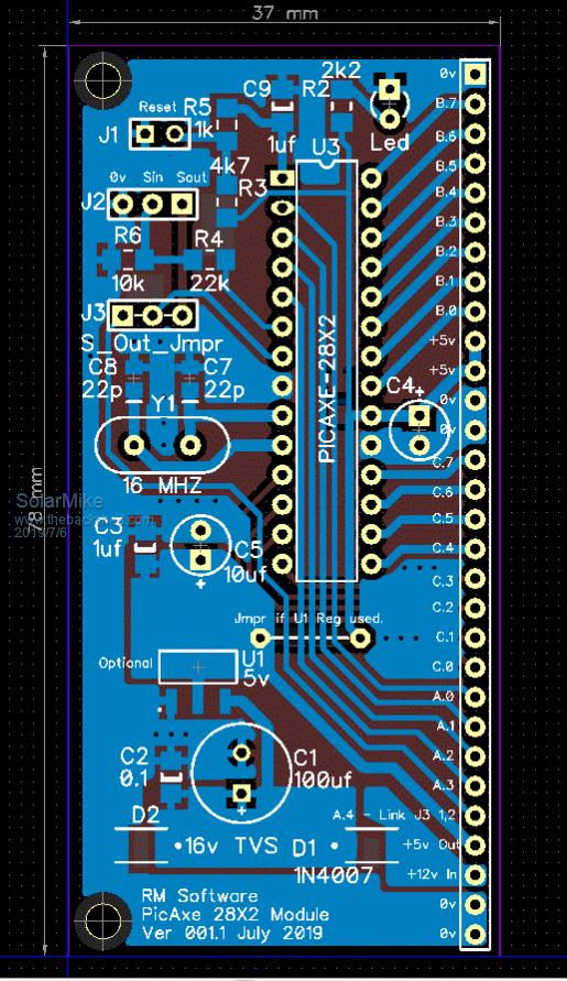

Have decided to use a PicAxe 28X2 cpu for testing this design, it has extra timers and interrupts along with the 64 MHZ speed, so should be fast enough. Once the circuit is working then a Arduino or similar could be substituted.
I also require a cpu for testing the MPPT controller, so have made a generic cpu board for this chip with board connections along one side, so it can be plugged into a 30pin header socket.
If anyone wants to make this generic CPU board, PM me and I will send you the Gerbers.
Mike.
