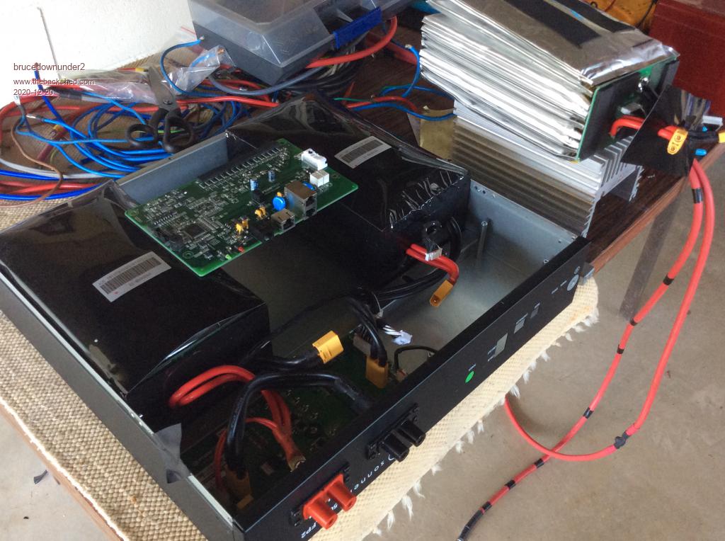

Thought I,d show what’s inside a Flat Pak battery pack .
Looks like the card of battery management control for equalising and 10 sacks of chemical consisting of the Lithium and other combining ore.
Each of 3.2 volts making 32 volts per battery pack ,'3 of these in series for a 48 volt battery.
This one is DEAD. .I think ?. The packs are very SWOLLEN aaaand unwrapping them just found each pouch connected to a PCB board which made up the negative and positive connections to the outside world. Not much else , so maybe ,when this is in good working order, it,s purely the container for the 2.5 Kw of battery power. Input and output cables are in parallel ,so maybe one set for charging and the other for powering A load.
Don,t know if I can buy the individual packs, will investigate that later.
Weighs in at 22 kg. So not very portable ,but for 2.5 Kw it,s probably around half the weight of gel cells or sla,s .
It,s a standard rack mount. Lovely connecting terminals and well made
SONNEN  2500 LFP2
Australian made.
Bruce

They look exactly like my RC aeroplane batteries, even down to the orange xt60 connector. Where can we buy them in Australia?

Just did a quick search, going by the size of the I think they are 25Ah each cell found these.
They are Lifepo4 not to be mistaken with li-polymer, different stuff as far as I'm aware.
There are other options, will have to look around some more.
@Haxby I have a few of those old flight packs, polymer type they have an enormous discharge rate,but short cycle life, my RC chopper had about a dozen successful flights, then after could only manage a hover.
Cheers Aaron

Thanks for the feedback, Aaron,
Yes,they certainly look the same as mine.
30 pouches won,t be cheap,so maybe if I can,t re charge these ,  then the only thing nice to reuse will be the big terminal posts.,,,,
And ,maybe a slim line rack unit for a new inverter,no, too narrow for our Torodials?.
Bruce

It might charge up ok, don't leave it unattended, there could be some bad cells and others good, will see.
I just pulled the solar panels out of all the SCC's they are      Too many SKY SPARKS ATM, some less than a second between the flash and bang.
I bet the grit power is out too.
Its heading your way Bruce,
Cheers Aaron
Off The Grid

How would I know If I have some bad cells
They all look like new ,like no discolouration, visual breaks , etc..
Lots of lightning and thunder towards Bris and Gold Coast,not much rain. Tanks are overflowing ,nowadays. Not been this way in ,possibly a year or more.
Bruce

The cell might heat up or expand a bit more, or once charged a cell will drop its voltage compared to others.
That's what I think anyway, perhaps the control system might not let it charge, don't know yet.
It would need the BMS connected by the looks of.

Very interesting tour, my cells or ,pouches, as I called them ,look very similar.
I was going to ask if anybody had dismantled one pouch to look at the chemical contents ,but now realise it would be foolish and dangerous .  The contents maybe toxic.
Would be interested in knowing what actually happens because of mis management in either the charging process or shorting out of the pouch .
But , I now realise that any physical or electrical cause would render that singular pouch to die or worse still effect the adajecent and other pouches that are in series. Just my ,Chain of events, thought on the destruction?.
Tanks Oreo,you have me much wiser , now.
Bruce
