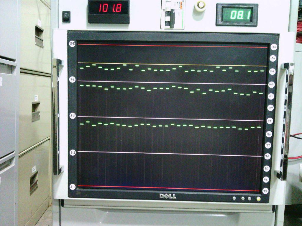

  Quote  Did you actually have a voltage mishap, that you know about?
No perfectly normal operation one day, the next day zero volts across one of the cells.
I mean truly zero, not even 0.1mV measurable.
This is an old picture from Jan 2019 showing how I monitor the voltage of each of the 30 cells continuously. Upper and lower readings are the max and min voltages ever reached. Middle trace is real time cell voltage.
One day perfect, next day middle and lower traces of one cell completely gone, right off the bottom of screen.
