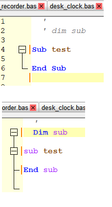

That is a strange one Bill.
Is it only one program that does it?
Start a new program
The top half is correct.
Then remove the rem from the dim line and 'format'
The second part of the image has the 'sub' highlighted as a user variable.
Ignore the orange line to the left - that's a new feature in the next release.
I expect that there might be (or was) a variable named 'sub'
You have to find it then close the program and reload to cleanse the user variable list.
The easiest way to find all 'sub' words is to highlight the word then F11 for a list of lines involved.
You can try the attached mmedit5.exe but I don't think the problem is in MMEdit (but I have been wrong before)

Thanks Jim, Sorry to bother you, I shut down MMEdit then reopened it, loaded the file again and the problem has disappeared.
Another thing I noticed was that a variable I had created was not colour coded even though I had used it a few times. "stats" in the picture that I uploaded. That is OK now too.
Just some strange glitch?

New words are added to the list when you press enter on a 'dim' line.
If you go back and add a new variable without pressing enter (a common thing to do), the new word is not added. "Format' scans the lot and picks up the leftovers, as does reloading.
Just switching tabs doesn't help.
If I try and test for new variables too often, things will get too slow.

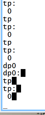

Not really an issue but just another FYI. I have the terminal using a white background.
When I reach the bottom of the window, causing in to scroll, I get these black characters after data entry and also from the ARMmite H7 PRINTs.
Characters with no following colon are typed. Those with a following colon are PRINTed by my program.
Posts: 6625
Posted: 08:10pm 26 Feb 2024
  PhenixRising said  Not really an issue but just another FYI. I have the terminal using a white background.
Definitely is an issue.
I have been working on that area so it is timely. I can repeat it and 'think' I have fixed it but now have to make sure I didn't upset something else.
