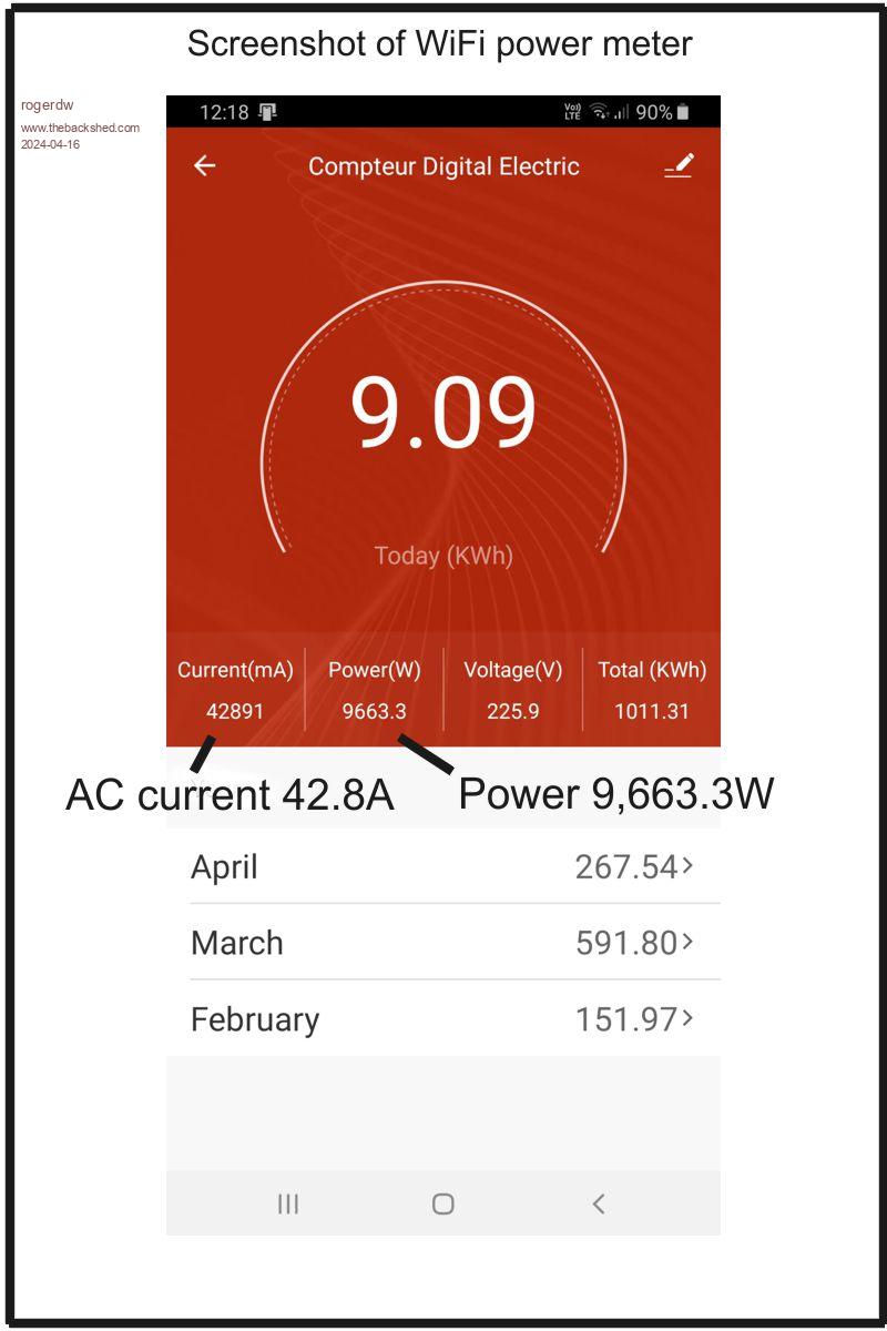

I'm slowly exploring the limits. Living dangerously.
Yesterday we had two segments of underfloor heating running (6,000w total) along with the normal house load for 4 and a half hours  ...  then turned half off and ran the other for an extra hour.
Seemed to handle it okay. The electronics stayed cool  ...  just a few degrees above ambient, but the larger two toroids started to warm up to around 50C  ...  so turned on a pedestal fan which brought them back down to lower 40's. I need to fit the barrel fan I have planned.
Today I'm running both heaters again and I happened to spot the total load right up at 9,663 watts at one stage. Gulp!!
The load pulled the output voltage down to 225.9v at the inverter  ...  and lower again up in the house at the heater connections  ...  so it's time to fit the "feed forward current correction" that Klaus used.
I have the current transformer on the input bus, so just need to find/work-out the rest of the process.

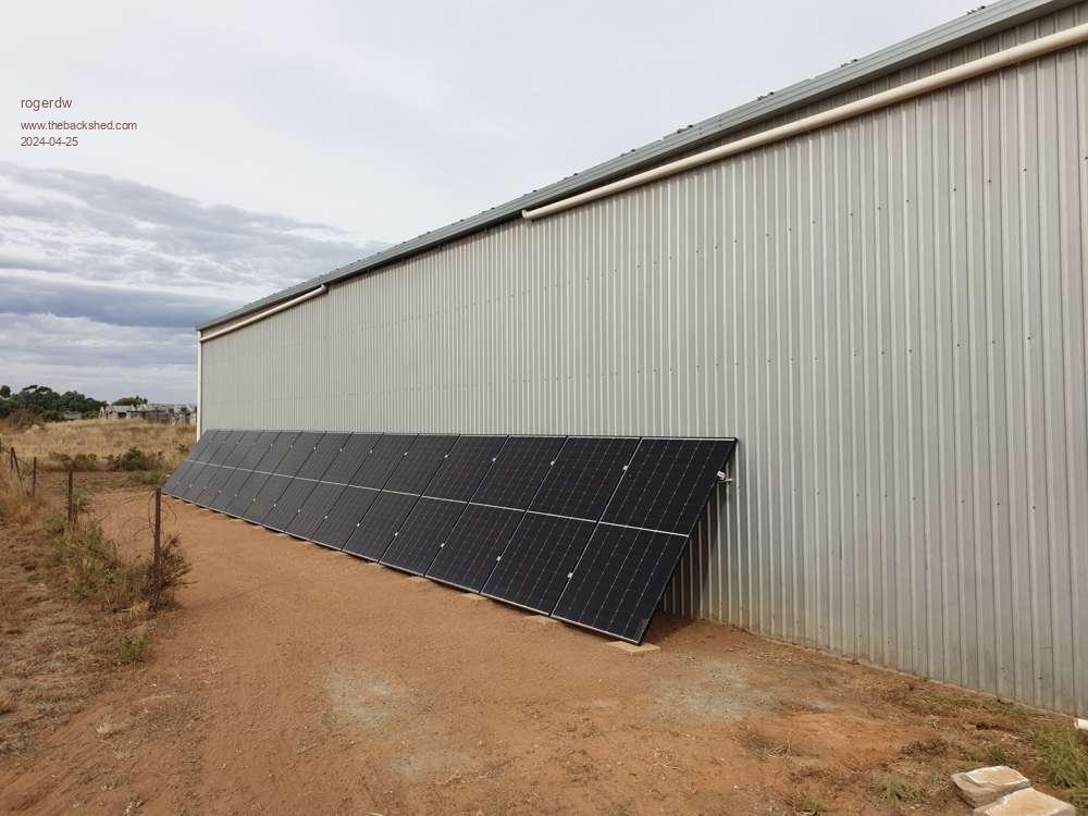

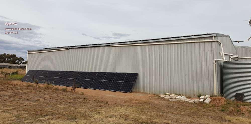

I picked up another batch of panels, rails and a 5kW Growatt GTI from Marketplace last weekend. 15 x 440w Jinko panels for an extra 6.6kW. It cost me $1,000 but I had to remove them from the house which is slated for demolition.
I've leaned them up against the north facing wall of the shed and fed them in two strings into the GTI. They are all clamped together with a rail all the way through and all the bottoms clamped together  ...  then tied to the shed.

Great idea with those solar panels, I assume they face North? Easy to clean too .

Yes it faces directly north  ...  very convenient layout. I was being lazy I suppose but the inverter is only a couple metres inside the shed from the right hand end of the panels, so it certainly saves in cable too.

Thanks Mike. Having these nice 440W panels makes me wish I'd chased bigger ones earlier. I have virtually filled that side of the roof now and would hate to have to undo all the work and fit bigger ones  ...  so I think they'll stay and I'll find somewhere else if I end up with more.
There's still 40 metres of fence in line with that shed wall  ...  so I could start filling that too. Haha
