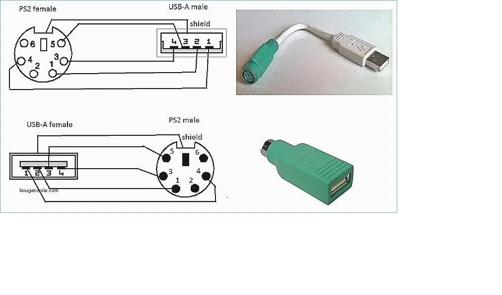

do usb to ps2 keyboard adaptors work? I got 3 from old pc days.
all I use usb vga for is a usb keyboard.

Wrong thread for this question, Stan.
It depends on the keyboard.
Early USB keyboards also supported PS2 protocol and would switch over if that's what the computer was expecting. Some later ones dropped this facility as there were fewer and fewer PCs with a PS2 socket, however a lot of Chinese manufacturers carried on using the old system so their keyboards often will work with an adapter.

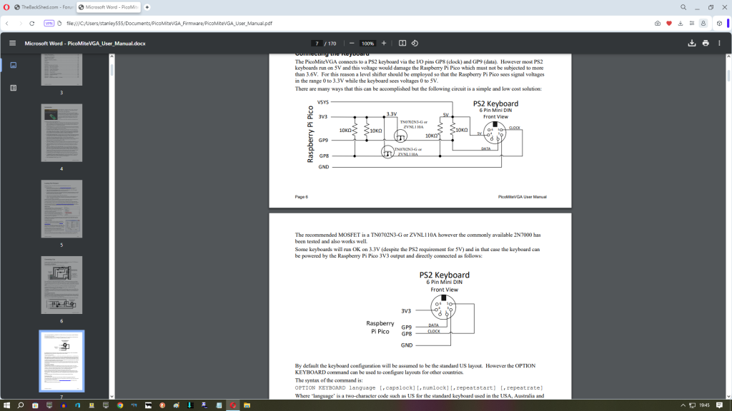

cheers Mick, I got 3.3v ps2 key board and rewired to molex pins but it's full size and usb keyboards can be mini. no ps2 sockets and not strip board  anyway so solder wires to usb adaptor

The keyboard is powered from what it's plugged into. If you power them from 3V3 some will work and some won't, but you don't need level shifters. If you power them from 5V then they all work but you do need level shifters for a RP2040 (you can get round it with RP2350s in some cases). USB keyboards always expect 5V and you shouldn't attempt to run a 3V3 USB system - there'll be tears if you do.
The hard wiring of the interfaces is only half the job. It doesn't work unless the firmware and keyboard hardware supports it.

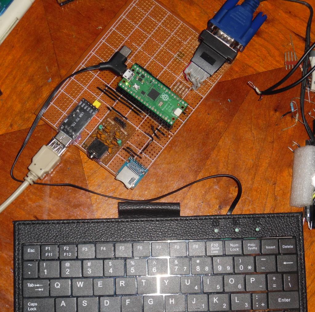

I have a usb vga pico 2 and it connects to pc through usb to ttl and same pins as ps2 keyboard. I just flashed non usb vga rc2 and thinking what would happen if I connected the usb keyboard to usb to ttl converter as it's 5v is wired to vbus as it powered the pico in usb mode.
now nonusb it connects to pc with micro usb but usb to ttl still connected. any harm?
need a usb female to usb female to connect kb to usb to ttl to test
this usb vga non vga connect to pc using micro pico2 usb but usb to ttl still connected to vbus ie pc usb 5v so usb to ttl got 5v to power usb keyboard

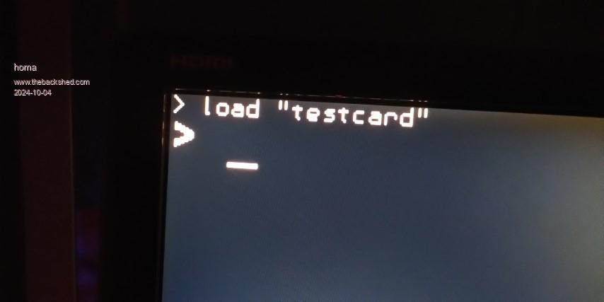

Posted: 03:02pm 03 Oct 2024
same version.
The font becomes larger after a LOAD, if not in MODE 1
> mode 1
> load "testcard"
> mode 3
> load "testcard"

mm.info() and mm.info$() are functionally the same. You can use either AFAIK. It will always be displayed as mm.info() though.
Mode 3 isn't always the same as Mode 1. It is in 640x480 but not in 1280x720 or 1024x768. The font size will change.

Mick, you didn't understand me. Try it out and you'll see the problem.

Load resets the font to the default for the resolution. You can change the default font using OPTION LCDPANEL CONSOLE. I'll look at the highlighting problem.

my english is too bad to describe the problem. Enclosed is a small video with the HDMI grabber as a ZIP file.
