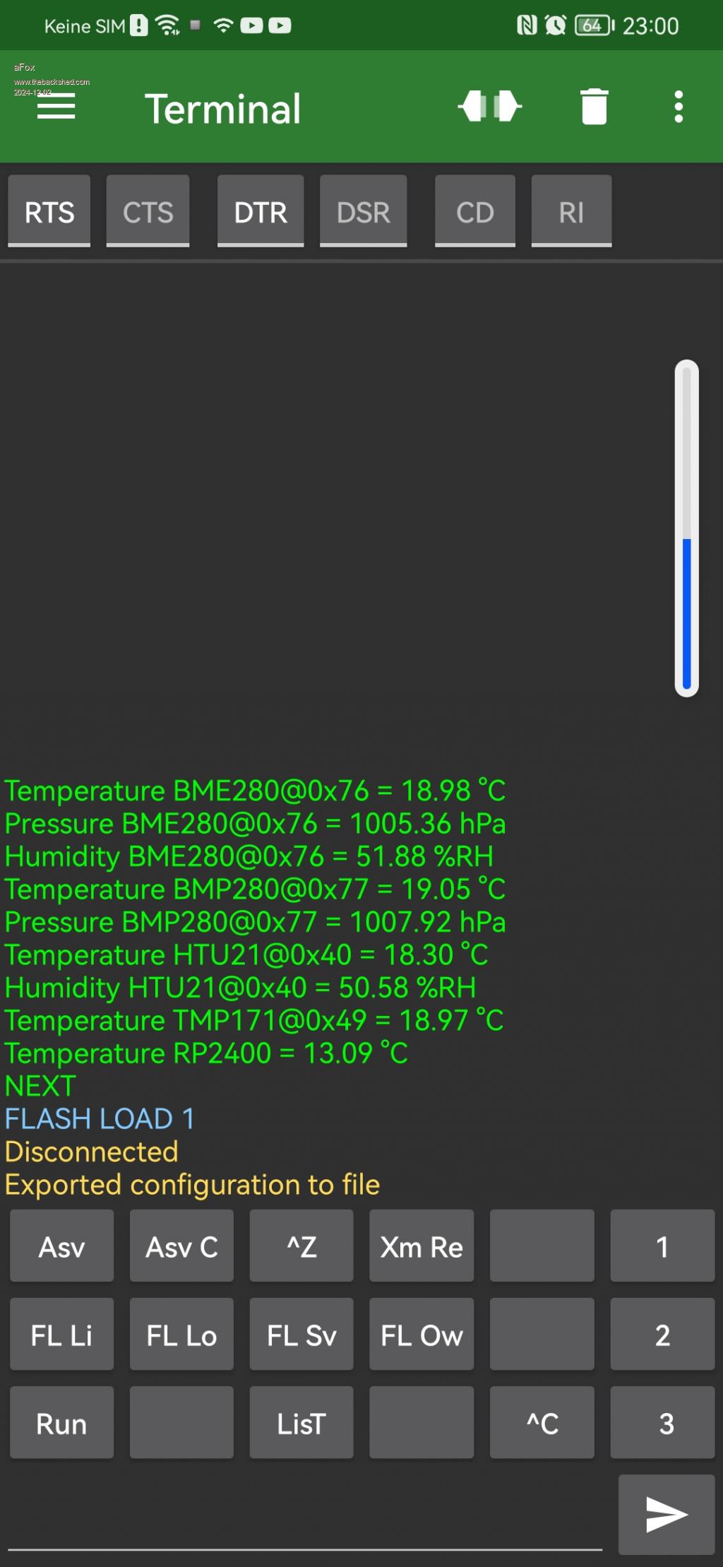

The configuration link in view of Android need an update.
After Linux at page 7
Android
Use the 'Serial USB Terminal' app.
Select Coniguration/Import from the right menu.
Save this as your coniguration file UsbConfig.txt into the Download folder.
 "package": "de.kai_morich.serial_usb_terminal",

The Result:
