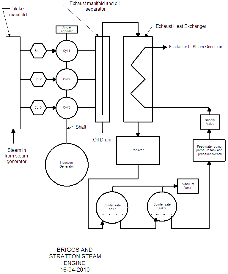

Hi to those following progress (or lack of) on the Briggs and Stratton steam engine on this thread, and particularly to those making helpful comments.
The engine project progresses slowly, but at least I now have most of the bits that I need to finish the engine. For those who are interested, I will try and attach a single line diagram of it. (Coises - foiled again - I drew it up on Visio, and the server doesn't like .vsd attachments) - I have now saved it as a gif file, and will try again!
Thanks for the advice re reducing the content of a photo so that it can be posted Pete. Somewhere in the process of cleaning some very unhelpful anti-virus software out of my computer, my photo editing software has dissappeared, and I have not yet msde the time to sort it out.
Apart from getting the timing right for operating the inlet solenoids, the control system needs to know the temperature and pressure at a number of points in the system. For temperature in particular, I am looking to monitor 7 points, including 2 at the solar collector. On the steam side, I need to be able to measure temperatures of up to 200C or more.
The problem with thermocouples is that you need proper compensating leads, ideally a cold junction, and you have to be careful with every connection to ensure that you are not introducing another bimetallic connection. I was therefore having a close look at resistance temperature devices (RTD's), which are just a temperature dependant resistance, and was attracted to the Pt100 type, made from platinum. These have a resistance of 100 ohms at 0 degrees C, and an almost linear temperature/resistance curve.
The problem is that they are about $50 and up each, and that is sterting to get expensive. Luckily, I ran across the site for Shanghai Feilong Meters and Electronics, which manufactures them, and sells them for a fraction of Australian list prices. The only worry for me was that you had to order via Alibaba Express, and it set me to wondering just what the 40 thieves were busy doing these days.
I therefore had a good look on the net, and found that Alibaba (the company, that is) even had an entry on Wikipedia, but for all the right reasons. Anyway, the RTD's arrived today, and the whole purchasing process was most professional.
Anyhow, hopefully by the end of the month or not long after, the three cylinder engine will be running on compressed air, and I can get on with building the solar collectors and tracking mechanism.
Thanks too for the comments re pic micros and picaxes, but I am going to rely on a bucket load of stone age electronics initially till I get the engine running. Maybe after that I can work out how to do an upgrade for the inlet solenoid controls with a suitably fast micro.

Hi Don
Glad to hear your progress and the diagram makes it a bit clearer.
All the best

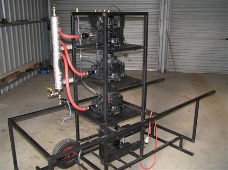

Steam Engine Photos
Hopefully this time I have been able to downsize the steam engine photos below 500k so that I can post them on the forum.
If the photo has posted as I believe it has (confusing system this, as all I can see in the draft box is text saying that an image upload has occurred), you should be seeing the three lawnmower engines mounted one above the other, with the 1 HP induction motor on the bottom. Just above the top engine is the angle encoder. You can also see the intake manifold, the intake solenoids, the crank case interconnection and breather tubing, and the 3 sump oil level and water drain tubes.
What you don't see as yet are the exhaust manifold/heat exchanger, radiator, condensate tanks, vacuum pump, feedwater pump, and the control electronics and wiring.
The control electronics are the really slow part at the moment. Because a picaxe is too slow to count and decode the 10 kHz pulses from the encoder, and I am still at the bottom of the pic or atmel learning curve, I have reverted to stone age electronics to count and decode the 18 or so angles that I need to control the solenoid opening and closing points for start up and governing.
I will have a shot at uploading a photo of the 4 boards that are completed so far and awaiting interconnection. These are the counter, decoder, angle selector, and solenoid control boards. Each solenoid has its own 8M picaxe for pulse width modulation control.
I need one more board with the power supply and picaxe 40X1 micro to be able to run the engine on compressed air, and, in future, a further 3 or so largely analogue boards to monitor and control steam pressures and temperatures and feedwater to the steam generator. Then there will be another board to control the solar collector tracking, but this will be mounted on the collector.
Despite the slow progress, I am still hoping to run the engine on compressed air later this month. Once this is completed, I can focus on the steam side of things.
