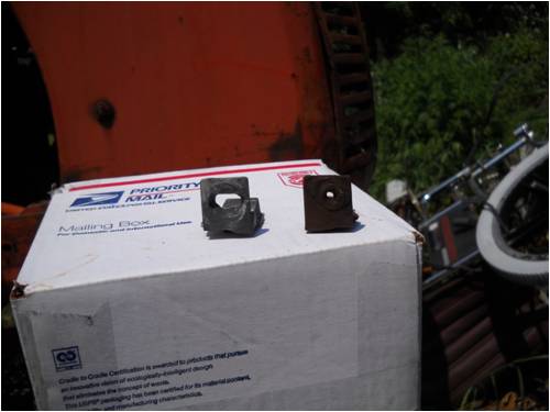

We are going too make a stab at the pictures.

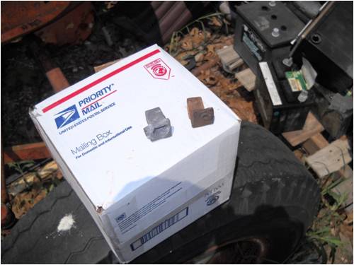

This picture shows a couple of the cell connector straps note the size of the contact spots,
This is another of the connector straps
This picture below shows the connector strap and where it connected to the next cell over. looks like a 1/4 pin coming through the cell wall.
Notice the amount of contact area.
Each cell has two of these connector straps one + and a - .
I just laid the strap on the separator so you can see the comparison.

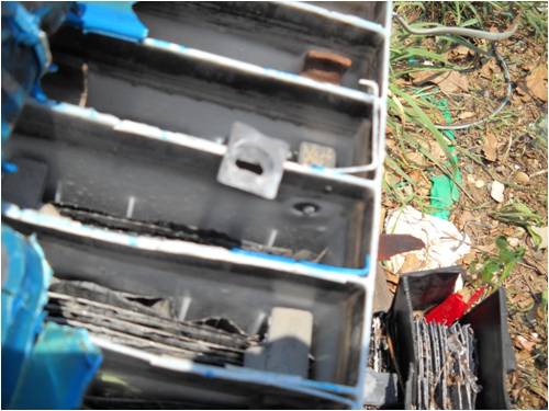

This picture below shows the inside of the battery and you can see some of the remaining connector straps.

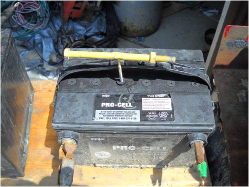

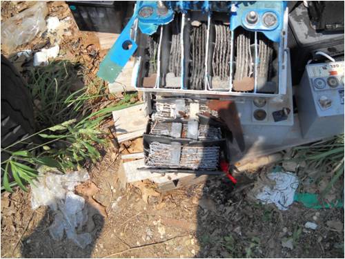

The top battery is the one that expired last week the one it is setting on is the one out of my dozer and it blew (the one that blew up in my face!)
the whole top off the top one didn't blow it all off I had to help it some to get the pictures we wanted.

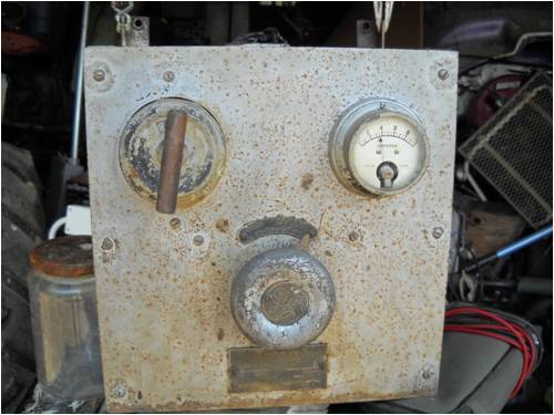

This is the last picture of the day and it is my old Tungar battery charger that used the old vacuum bulb rectifier and we updated it to solid state 70 amp rectifier.
this will charge up to 6 battery's at a time if you have enough connector straps.

Hey Bob you got any battery's like in picture 3 and 4?

I forgot mention that the Pro Cell battery in the picture above came through the treatment and now is ready to start a vehicle.

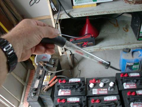

Rastus
What happened to the battery charger?
A lot of the older ones use a metal rectifier and with time they tend to break down. If this is the case and it didn't hurt anything else you can update the charger to solid state rectifiers. As Bob stated a few posts back a regular trickle charger is best for battery reclaiming, The new Smart Chargers I don't know what they are any good for. But If One posts his mishap or Mistake someone will be able to help you out,
This is the learning process.
The old Tungar charger in the pictures was originally a bulb rectifier and the bulb went bad and they haven't made them for years so we updated it to solid state and the first few rectifiers we knocked them and some fuses out , We all have problems and make mistakes.
Mac46 I thought you may have been going a bit to fast with the reclaiming.
Several weeks or more per battery.
Id go back and give them a longer run on the desulfitator and check the specific gravity of each cell.keep at it until that gravity cheeks good on all cells.
You can get a tester at tsc or Walmarts that just uses little balls like some if the antifreeze testers when it floats all the bulbs you should be good.

Isaiah,
Something like this one...
You can also see the desulphinator in the back ground...still doing its thing.
Thanks for all the help.
