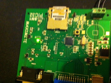

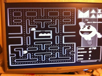

Woohoo
MaxMan running on Maximite SM1 with MMBasic 3.1 Firmware.
Sorry about fuzzy, shaky photo of Maximite I was too excited, I wanted to get back to the game.

Posted: 10:11am 28 Mar 2012
Well, that proves it. It *does* run on the SM1.
(on a wide LCD, looks stretched)
