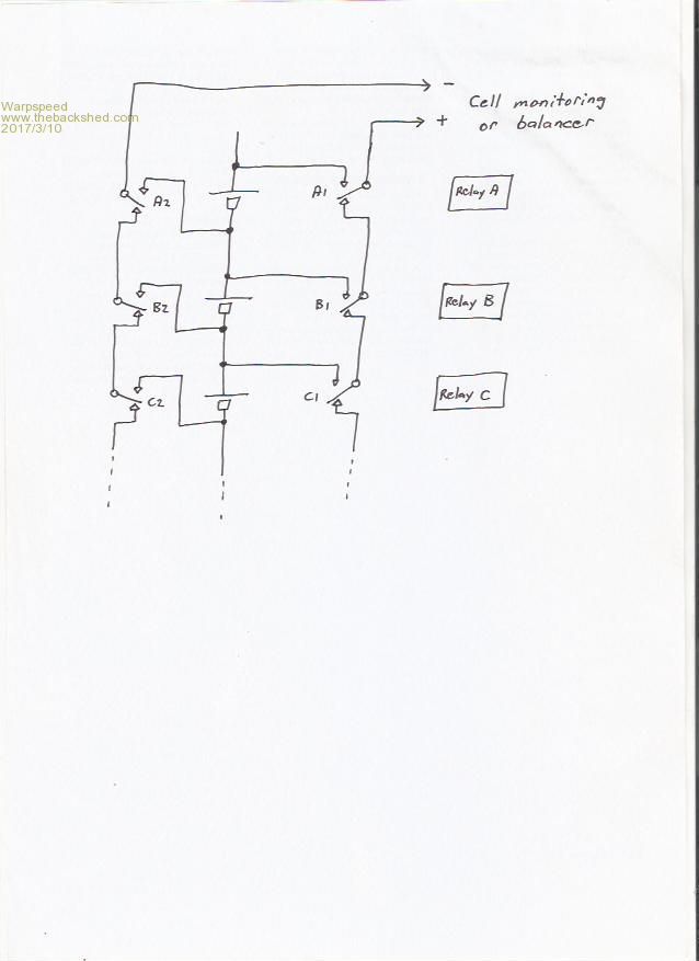

Posted: 06:38pm 09 Mar 2017
Now all this has had me ruminating and pondering for quite some time.
The unquestioned genius of Klaus is to blame for all of that.
I have now come up with a few assorted ideas that might be of general interest.
The first thing is how to connect up relays for cell monitoring/balancing in a fool proof way that cannot short out cells or misbehave, even if something goes desperately wrong with the relay sequencing.
So here is what I came up with:
It uses one double pole relay per cell to connect each cell across the output as required. But there are no constraints in relay operation. No need to release one relay before operating another. In fact even more than one rely operates or fails to release, nothing really terrible can happen.

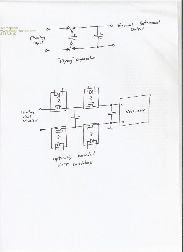

Next problem for individual cell voltage measurement requires a fully floating voltmeter. For accurate cell balance measurements the SAME voltmeter is really required so very small millivolt differences can be compared without introducing cumulative errors.
The best thing for that might be the "flying capacitor" method of voltage isolation.
The concept is to switch a capacitor directly across each battery cell so it charges to the exact cell voltage. Then disconnect it from the cell and connect it directly to a ground referenced voltmeter. By switching back and forth both capacitors rapidly assume full cell voltage with minimal error. Relay contacts could in theory be used to do this, but a much nicer solution, that is not going to mechanically fall apart would be some fully isolated optically driven fet switches.
The switching devices could be International Rectifier PVA33N.
http://www.irf.com/product-info/datasheets/data/pva33.pdf
These have 300v isolation when off, can carry 130mA when on, and have a resistance of less than 25 ohms when on. That is enough current rating and resistance to ensure no blow ups even under worst case conditions with the largest capacitors and cell voltage differences.
Switched at about 100 Hz (with non overlapping clocks) that should work well for both cell voltage monitoring, and I might even get a bit of "Klaus" full time cell equalisation for free thrown in, if my capacitors are made suitably large.
So my ground referenced voltmeter can monitor individual cell voltages with up to a 300v battery anywhere between 0v and +5v, and read every cell the same without requiring troublesome very carefully matched resistor networks or op amps.
By setting the A to D converter ref Lo and ref Hi voltages at say +3.0v and +3.6v I can fill the screen vertically with 256 bits over any desired voltage span up to +5v. That is about 2.3mV resolution which should be enough to clearly see any cell differences.
That would make a nice front end for a data logger or battery monitoring system, and its really simple.

I don't even have a Lithium battery yet to monitor.
Early days yet.
But I want to get all this going before I actually get the battery. My camera is FUBAR right now, and must buy another one with a good macro lens. So no pictures yet unfortunately.
Just though I would bring everyone up to date on my latest adventures.
Edited by Warpspeed 2017-03-11
Cheers,  Tony.

Tony, I'll take my hat off for coming up with your clever relay switching arrangement in that first sketch.
You have no idea how stupid I feel now , not having come up with this myself.
My excuse is, having started up with super capacitors to do the balancing, there were no reasonably priced relays available with that contact arrangement *and* a high current rating, as the inrush from these caps is quite big.
All I could find for an affordable price (remember, there are lots of relays involved) were automotive type relays and these do not have changeover contacts. The relays also had to be physically small to fit so many on a reasonable sized PCB.
Automotive relays were OK for the 24v battery bank but failed miserably with the 48V bank after I upgraded my system.
Now I'm using DPST relays with software control to prevent the wrong ones operating (which instantly blows fuses BTW ).
These relays are small enough and with a sufficient voltage rating but have only 2A max current rating.
As it is, they usually switch <0.5A while equalising from my isolated voltage source, set to 3.8V.
The system is now trouble free, it just gently clicks along after the battery bank reached the end of the absorbing state - the solar panel voltage reaching >80V wakes the equalising sequence up. Each of the 16 relays only comes on once in each minute.
With an operating life of a quoted 10 million mechanical cycles they should be good for a few years yet.
I do only visual monitoring of the cells now, during the equalising cycle a small DPM and a display of the cell # lets me know what's going on.
These lithium cells are so closely matched (within <5mV each)while there is no charging happening, any logging is only useful while the batteries are charging.
Sadly, the picaxe based logger I have only does 8 cells and its resolution was not that good anyway.
Klaus

Klaus, I have been thinking about this relay problem for quite a long time, and it was something I came up with only after looking at many other ways to go about it, all of which had many possible failure modes that I did not much like.
As you say, the relays will be pretty expensive as we need many for something like this.
I have ordered eight of those cheap Chinese relay boards from e-bay to try initially.
They only have single pole relays unfortunately, so I need to run two eight relay boards to monitor just eight cells. Its not a good solution, but its a low cost way to get started with a working prototype.
Doing it this way opens up a few problems. If one board stops working we are in trouble. Much better to use dual changeover contacts on the one relay, that way nothing destructive is really possible.
Your ultracapacitor cell balance idea is still a winner, and I had thought of placing an inductor in series with the ultracapacitor. That will limit the initial current inrush, the LC circuit will then ring at very low frequency with a decaying amplitude.
When the relay contacts for that cell finally open, there should be no stored inductive energy remaining. It should be very gentle on the relay contacts.
I still think your cell balancing idea can be combined with individual cell monitoring. If we switch to a different cell, there will be an initial energy interchange, but after a few seconds the capacitor voltage should settle at the actual steady cell voltage.
We can then read that cell voltage off, just before we switch our next relay to the next cell.
If the relays sit on a particular cell for several seconds we should be able to both shuffle some useful energy around for cell balance, AND do some cell voltage monitoring with the same system. If it all runs continuously, we may only need a fairly small balance capacitor.
I have absolutely no idea what the requirements are, but it may need very little to stay in excellent balance over very long periods.
Cheers,  Tony.
