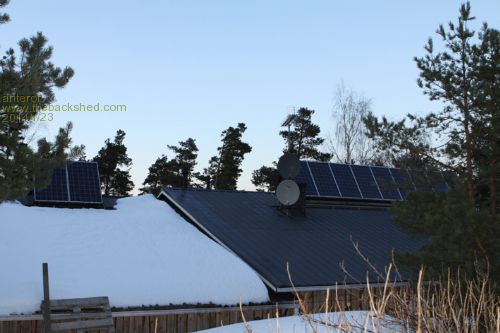

I have Schot Solar Perform 250W solar panels 11 units in my roof.
They really perform.
When I started this I wanted to have sun-tracking system, but wind conditions here
are very rough and 11 units in the roof, mission impossible.(picture)
My only option was to mount them on the roof, because the elevation of the terrain.
Now they are all at a steep angle, because snow falls from them very easily and
late in the autumn and early in the spring, the best angle is deep..
Short time sunlight and sun is shining from very low angle.
WE had winter solstice at 22.12-13 and now day is getting longer and sun
is getting higher and higher day after day.
Now we have temperature -26C that is -14,8 Fahrenheit.
There is now snow in my roof (picture is not from this winter) which acts as little mirrors and I get a lot of scattered radiation and also from surrounding terrain which is covered with snow.
The atmosphere is also particularly dry and clean, when there is so cold.
The amount of light is at maximum and very bright.
No wonder there is so called snow blindness among helicopter pilots
and hikers in snowy terrain with full sunshine.
I have got record high readings from my solar panels.
Also panels give their max power readings(and more with with snow blindnes..) without any heat loss, when weather is so cold.
Even when the sun is shining just a short time 4-5 hours a day now, I can get my batteries charged.
In the summertime I get 85-90 Amps from my panels, now I get 105-135amps,
with 24V system.
I have got 10-25Kwh daily now, when there is so cold and high pressure,
with full sunlight with just few hours.
You are so lucky ones
