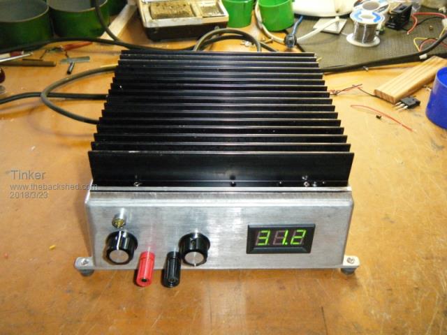

Found the problem at last, it sure gave me the run around.
It was the R47/5W resistor going open circuit for no reason at all bar bad manufacturing. I never before came across a 5W resistor going open without getting stinking hot beforehand. This one showed no signs of heat stress at all. It must have been on/off initially for the supply to work sometimes, thankfully it got o/c permanently so I could track it down.
Now the supply works fine, 50W is the most I get out of it (25V/2A) with a clean wave form. More load and the saw teeth start appearing, I already have doubled the main capacitor but think they should have left room to fit a 10000uF cap at least.
Noise is very low (<10mV) at the output up to that 50W load. It did require to fit a 0.47uF greencap across the output terminals for that, without that cap there is lots of noise.

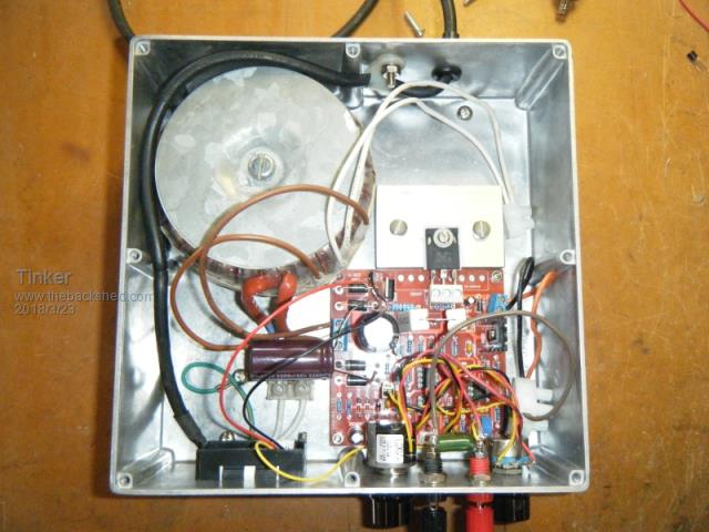

The pics below show the finished power supply, the voltage at the meter is the max. unloaded. This drops to around 27V flat out loaded.
And a pic of the inside:

Very impressive Klaus, yours is a lot simpler mechanically than the way I have constructed mine. Thermally it is very well thought out and it looks very efficient.

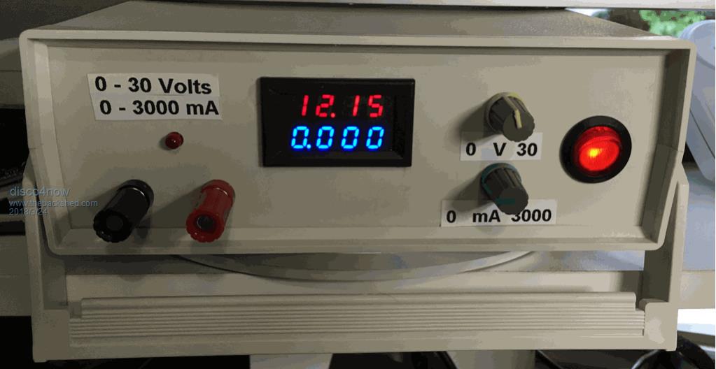

I built one from the Banggood kit. $6.00 at the time. Price seems to go down sometimes in you look at it more than once. Was $11.00 then after looking again was down to $8.00.
I used this case which is about $14.00 now.
I used this case
The Banggood item has a link to a manual which includes a circuit that matched the kit.
Bangood Kit
Bangood Manual
I also used their meter and heat sink.
