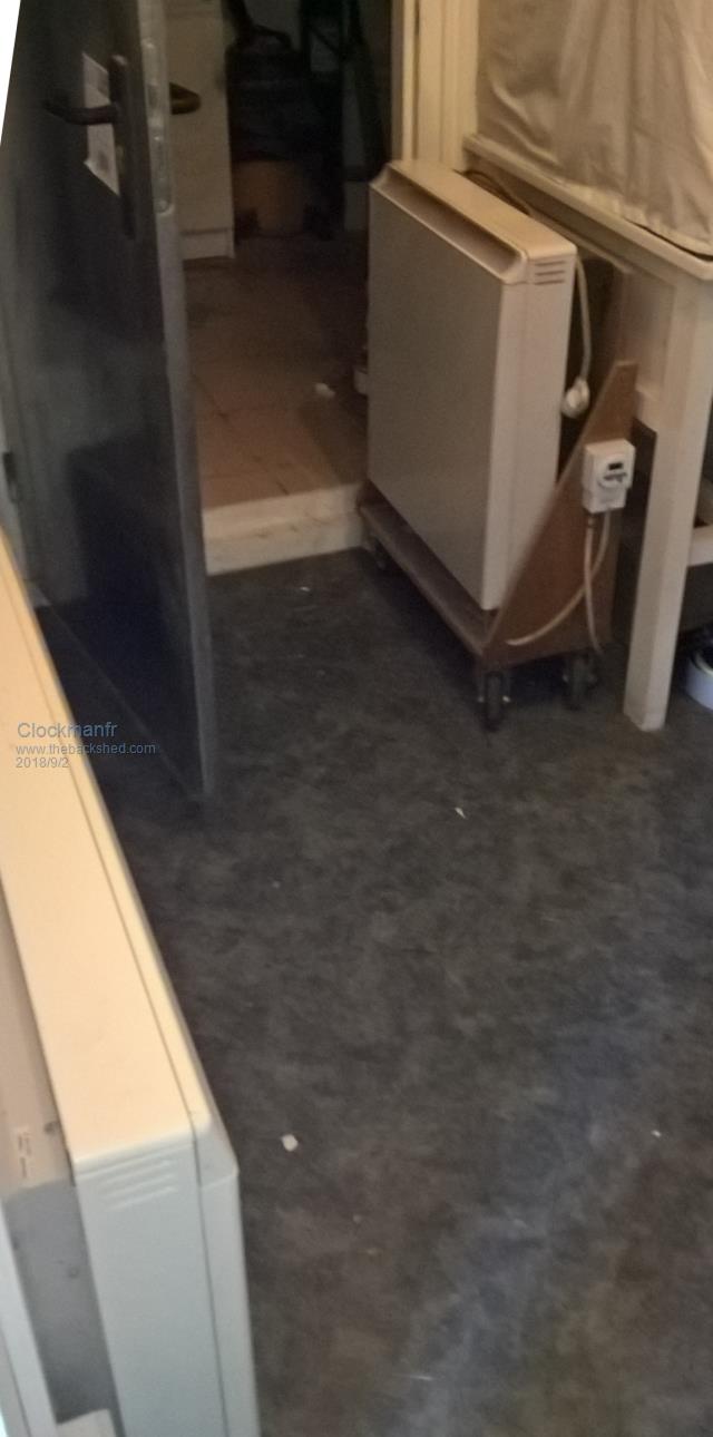

Firstly all my buildings and the 5 houses here are to Passive House standards, ie lots and lots of insulation and new interior walls with thermal blocks or masses of wall insulation.
Heating...... I use electric heater accumulators or what we call storage heaters.
In Europe at night when the Grid power stations are not at max loadings, then they sell electricity at a quarter of the price.
So the Grid connected storage heater is on a timer circuit, and when the Grid meter changes over to cheap rate, the storage heater switches on, and charges up the heat retaining bricks that are inside, then switches off early hours of the morning.
.... All I do here is to switch them on when the sun shines on my PV, give them a 7 hour charge, and they will give out there heat to the following sunrise, although the batteries always get priority first.
Normal storage heaters elements are about 800watt each, and the storage heaters just double up 1.6kw, 2.4kw etc. But the draw back is that storage heaters are heavy really heavy mass inside, and are normally a fixed appliance. Although I do have one on industrial castors.
Photo ........ On the left of the pic is a 3.2kw storage heater, far to hot for my workshop so I have safely disconnected 2 elements inside, it was a freebie. ..... the 1.8kW storage heater is on castors.
