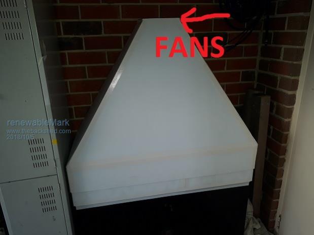

Above my fork battery it has a big rangehood thingy I made to extract the fumes out to above the garage roof. It's fitted with 120mm computer fans at the top of the hood to pump them out, problem is the bearings seem to be failing after 4 weeks or so. The fan still spins but loses most of it's power and barely turns.
The ones I used were $6 ebay crappo's can anyone suggest a better one that may be less prone to the acid mist?
(There is a pipe fitted to it at the top now btw)Edited by renewableMark 2018-10-06

Well Mark, cheap fans do not like sulfuric acid mist it seems .
If this was my set up I'd reverse the fan thing.
Seal the battery box and have the fan blow *in* fresh air and out at the top.
Sorry if this is a bit too obvious .
Keep in mind that mist will try to corrode anything metal in its path up that fancy hood and pipe. So, use plastic pipe and keep the exit away from your TV antenna on the roof.

Probably due to cheap crap fans and running 24/7 they soon came to the end of there life. I would try a local computer shop, they will have fans for around double what you paid that should give a year or 2 at least. The failure will be just due to the sleeve type bearings in the cheap fans and lack of lubrication.

Posted: 08:39am 05 Oct 2018
Thanks Klaus,
yeah the pipe is PVC too, that hood is made from coreflute.
I did think of blowing air in, but with the shape of the hood it will make a funny swirl, maybe if it got fitted to one side pointing up 20 deg it could make a upward cyclone effect??
Reckon I'll just try a better fan first, before cutting holes in the hood.
I know Mad vents his battery as it's in a container, never asked him about his setup though.
Edit, And thanks Gary, you posted while I was typing.
I replaced one today with one from a dead pc at home, I'll get two different brands tomorrow and fit them then see which one lasts longer.Edited by renewableMark 2018-10-06

I use a 240-volt squirrel cage type fan from a kitchen under bench extractor fan. The air does not flow through the motor. It has been running a couple years now and is controlled by a Solid State Relay connected to my charge regulator. When battery volts are above 51 it turns on and below 5.5 it turns off.

OK, bit like a car heater fan, that might be an idea, the fan blades could be at the top of the hood and the motor on the outside.
I'll see how a better fan goes first.

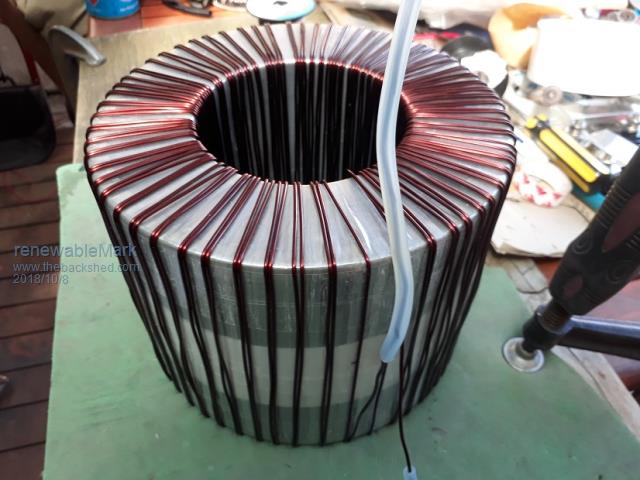

Just can't help myself, lets see how long this one takes to build, last one was 8 months, reckon this will be done in 8 weeks or under.
Challenge is on to see if it gets running by xmas, I'm 100% confident on that.
Maybe the TAB should start taking bets on it??
Now I have a proper CRO and a bit of knowledge this should be a walk in the park compared to the first one.
