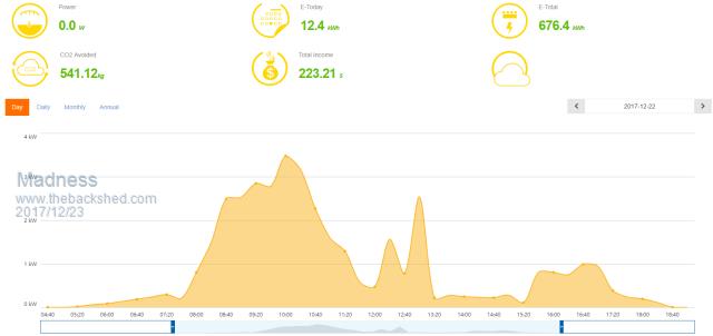

The image below is from my 5KW GTI for yesterday, it is only half of the picture as there is another 4.5KW as well not shown. Power kept increasing up to 10 AM with the sun then the regulator started throttling it back as the battery had reached Absorb volts. Total solar energy generated for the day was 22.2KWH, it was mostly clear skies, due to the regulation it holds it back, I have had around 40KWH in one day. This was after a few days of very cloudy weather so battery needed a lot of charging and hot water was right down as well. I divert power to the HWS when the battery reaches absorb, it can take 2400W most of the day when the temperature is down.

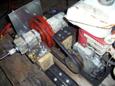

I was going to build one like this Higlander did
here
I have an older 42 stator and just recently scored a newer 36, I'll add that to the list of projects.
