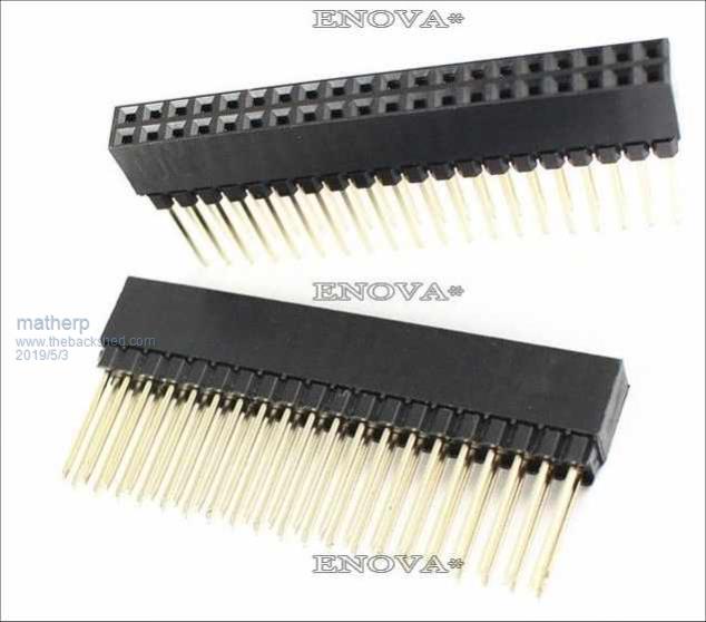

  Quote  I also put an extra long 3 pin connector on the console port so that I could connect to it from both sides of the PCB - very handy when the display is attached.
I use 2 tricks for this. One is to use right angle headers for the console, but the best is to stand the display off using these.
I cut the pins so they sit flush into the existing 40 pin socket on the backpack. Then you can get connectors to all the backpack pins with no issue

Hi Peter.
I followed your suggestion and used the extended headers. I did not cut the legs and used 23mm stand-offs (an 8mm and 15mm together using a 15mm and 6mm screw). This gave plenty of room for all the other connections - though I still connect the console cable to the back...
