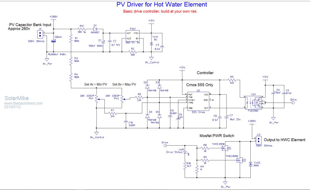

For Dave and others whom want to build the most basic version, I have drawn up a circuit and despite some reservations on how dangerous it is, will also make a pcb design to match. So it is strictly build at your own risk.
If anyone sees any obvious errors please let me know.
Note this circuit has not been tested live; I have stipulated a Cmos 555 timer chip here as it has a much higher input resistance, it wont work if a normal 555 is used. The optical mosfet driver can be substituted for others of similar spec.
Mike

I am a bit lost, will assume it is my lack of understanding of the solar cell behavior.
The input to the circuit, the approx 260 V is used to set the min 4V and max 8V points for the 555 it is here I get lost. the 260V is that not floating "slightly" up and down depending on solar irradiation?
OR
Is the circuit actually working in a way that it stabilizes the input to approximately 260 V with the shown values.
For the pcb: would there be enough room to also replace the potentiometers with say a combination of 3 or 4 selected resistors. For long term use I have from my industrial work time become suspect of such devices.
Nice for quickly set up final tuning, but as I was on the receiving end of being called 3 am to come and fix the !@#$ thing I became a convert to fixed resistors. My boss had a laugh, even we had picked mil spec pots. I learnt something the hard way.
Again since I do not entirely understand if the pots will be used 'frequently' the fixed resistors may be a dumb idea.

Pots typically adjusted once or twice then left, should be reliable, the ones specified are completely enclosed by a plastic housing, ie safer, because someone will zap themselves setting it up, unless you have a ceramic shaft tipped screwdriver set. once setup by all means replace them with fixed values.
The switch voltage points are set by the 555, 1/3 and 2/3 supply voltage, adjust the pots to set correct resistance ratio to suit whatever PV mppt voltage you are using. Upper limit trips mosfets on, dumping element across the 10,000uf cap bank, lower limit turns them off at some lower discharge voltage; enabling a recharge and cycle repeats; pumping high current pulses into the element.
Note this is a "poor mans" mppt, the correct set points are for one mppt setting, in reality this setting varies around with temperature and sunlight level, so it doesn't track. The other version I'm building does track and so will be a true mppt, but needs cpu etc so is more complex.
No I don't know if a true mppt would be much better and worth the added complexity..possibly not.
Mike

  plover said   I am a bit lost, will assume it is my lack of understanding of the solar cell behavior.
OR
Is the circuit actually working in a way that it stabilizes the input to approximately 260 V with the shown values.[/quote]
The upper and lower voltage thresholds depend on how many series connected solar panels you plan to use, and the maximum power voltage of the combined solar array.
The upper threshold is set just above the max power voltage, and the lower threshold just below the max power voltage. The system then ramps up and down alternately between the two set points, keeping the voltage on the solar panels swinging up and down THROUGH the most efficient operating voltage.
[quote]
For the pcb: would there be enough room to also replace the potentiometers with say a combination of 3 or 4 selected resistors. For long term use I have from my industrial work time become suspect of such devices. [/quote]
Yes, once you have decided on appropriate voltage set points, you can either tweak a pair of potentiometers, or just fit some calculated resistor values.
A few volts either way are not going to make much difference, its not that critical an adjustment.

For simplicity I would use fixed resistors. I did that for my single solar panel prototype and the voltage thresholds ended up within less than 100mV of the theoretical voltage. Biggest error was the 5v regulator that was 5.06v instead of being exactly 5.0v
If it already has been explained clearly in previous posts, just tell me so, I have read all the pages over time but forget too easily.
I don't see why this is supposed to be so very dangerous. You don't start soldering in parts with the power connected ! Many circuits such as motor speed controllers and light dimmers are connected direct to the mains with live components inside.
Only potential risk area are the potentiometers, assuming there are any, and you can buy potentiometers with a plastic shaft for this exact purpose. I would rather have no potentiometers and problem solved.
The other area of concern might be an exposed metal heatsink. Several ways around that too.
Things like high power variable speed motor drives have heatsinks fully enclosed in a plastic box with a computer fan.

OK, will allow room on the pcb for a pot with extended plastic shaft, and some extra holes to insert a couple of fixed resistors.
Any more ideas....

You have it all covered Mike.
Cheers,  Tony.
