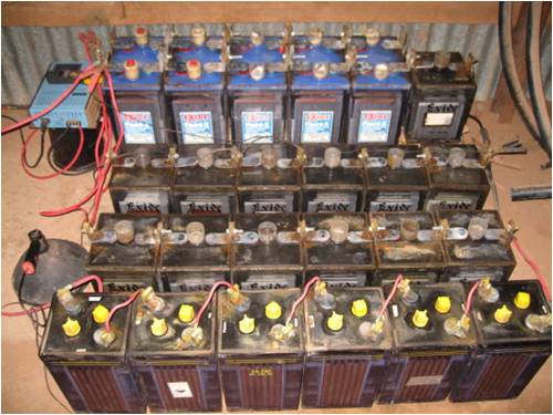

I have had this bank of Batteries on the charger here for for two months now, the only ones that are in good nick are the back row and I am one short of the set( they are 2 volt jobbies).
The GREAT thing about these is, they ALL have clear cases!
If anyone is interested I can post some photo's of classic battery damage, its a lot easier to see and I don't have to cut the top off.

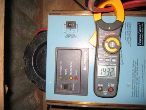

I would also be happy to review to pro's and con's of the new cheap clamp meters that have a DC current function. This one is less than $100, its saved my bacon a number of times.

It would be very interesting to see the start to finish of the desulphating process as a picture is worth a thousand words.
I like your clamp meter, I bought one but it was useless, it continually cycles the display.
