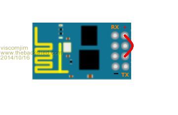

Hi Viscomjim
Could you please outline the process to upgrade the modules. Mine finally arrived.
I can connect to them with Teraterm but XTCOM cannot find the module
(com port and speed are set correctly)
Jman

viscomjim
Joined: 08/01/2014
Posts: 925
Posted: 05:32pm 15 Oct 2014
HERE is the wiring diagram I used for updating.
The only difference from the regular wiring that you have in the instructable is that you have to bring gpio 0 low while programming. After programming, unhook gpio 0 and then I just power cycled the unit. I wired the unit directly to the usb to ttl serial board as described on that page - just don't do any of the steps listed on that page other than the wiring.
Then this...
Firmware uploading tool
File:XTCOM UTIL.zip
How to use
Download the bin file
Set the module to update mode (by tying gpio0 low),
connect the module : choose "tools" - "configure device"
Upload bin file: API Test - Flash image download, upload the bin file at 0x0000
This picture is the wiring for "normal" use. Courtesy of OBC's instructable.
Going to get some sleep now. Good luck!!!
