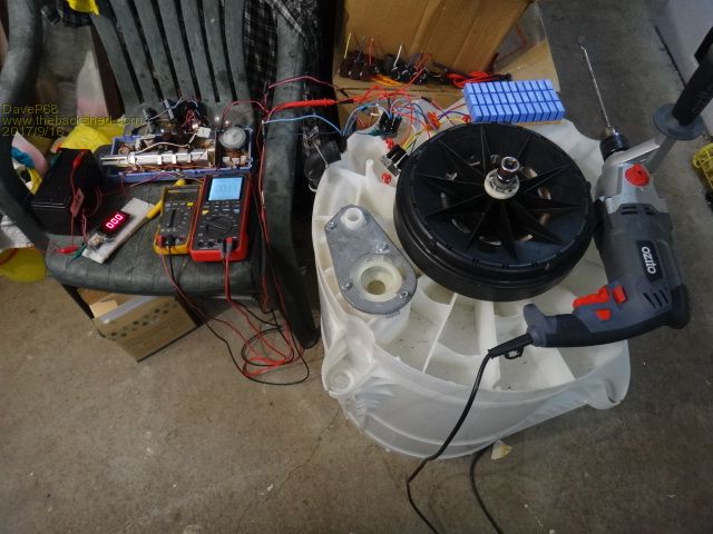

Just thought I'd post a photo of my crude but very effective F&P stator test rig.
That 5 kW/h performance that you've got, has been partly proven on this very same test rig. Most of parts acquired for free (multimeters already had) and the largest expense was for the $99 Ozito 1200 W drill.
Just goes to show what can be achieved with the most basic of test setups and hundreds of hours spent proving it will work correctly. This was to try out various configurations to chooser which would work in the real world on a wind turbine.
Have learnt so much in the last 2 years and it's great that I've been able to help out on your wind turbine, as I still haven't got one of my own.
Thanks again Fred for allowing me to be involved, as started off with very little knowledge as of only 2 years ago.

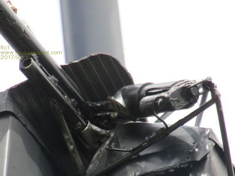

furling actuator

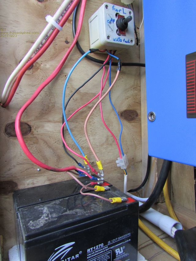

furling switch- with manual and auto settings ,connected to 2x 12 volt 7 ah batterys,
they are charged by connecting there charge controller to a 100w gridtie solar setup that is mounted on the windturbine inverter box. just waiting for Dave to send back the auto furl switch so I can reconnect it and tidy up some of that wireing .
The actuator works well, it can push the tail up to full furl without to much struggle, its rated to 150kg,
I covered all the joints of the actuator with silicon and then painted it to keep the rain out,
the end of the actuator that extends out sits inside a sliding sleeve that is connected to the tail and the other end of the actuator which has the drive motor is connected to the frame on the turbine body.so the actuator is not connected to the tail,but the sleeve is,
so it can still furl on its own in high winds.Edited by flc1 2017-09-24

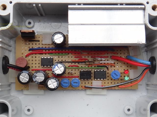

Hi ks, well spotted re no fuse on 12 VDC system, which I thought Fred was going to add in at the battery end. I'm about to send the switch back to him as it needed a modification to add opto isolation that wasn't required for the original specification. Have also a added a 4 A slow blow fuse, but this will only protect the electronics, as it can be manually bypassed.

The safety aspect only became an issue when the auto furling actuator switch was changed to get it's input from the high voltage system. On the origonal set up it was lower voltage and fully isolated so didn't pose a problem.
Anyway the opto isolator that has now been added sorts that problem out and keeps things safe on the 12 VDC side in case it needs to be disconnected for any reason.
For those interested here is a close up photo of completed board showing opto isolator installed at bottom center.

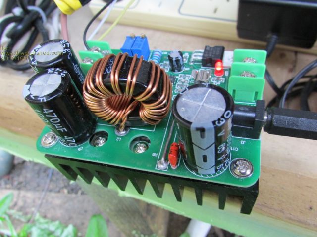

I installed a small dc-dc converter to set the high voltage inverter at 52 volts input standby,
Because with the 100vdc startup it would somtimes not get to the 100v to start in light winds, but would get to 80 or 90v alot of the time ,
once it reaches 100v dc it then starts operating from about 50-500vdc untill the wind drops off again to let the voltage go below about 40, then it has to start again at 100v, but with the dc converter installed it does not drop to 40 ,it stays at 52v, so no restart at 100v is needed,
its making power from about 53v-500 all the time now.
Its powered by a ac 230v isolated transformer(same size as a cell phone adapter)which puts out 12vdc and 0.3 amp.
I added a diode to the positive outlet of the converter, because I don't think it will like getting 400vdc back into it lol.
Edited by flc1 2017-10-12

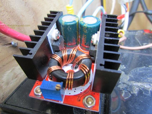

Fitted a 5 amp fuse and this 150w dc-dc boost converter to the power output to the furling actuator,
and set the output voltage to 18v,
Now the actuator works alot better than before,faster and does not sound like its laboring so much at the end of its stroke.
This converter cost $10nzd including postage.
