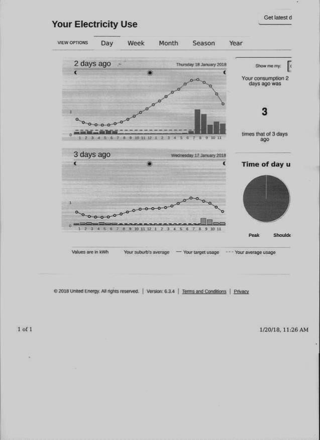

My energy supplier makes hourly blocks available via the internet.
Wednesday was pretty typical, but Thursday was serious airconditioner weather, and after the sun set my grid consumption soared to just over 1Kw, so I could get a decent sleep.
The upper curve with the blobs is the average household consumption in my suburb.
You can see during daylight my grid consumption drops to zero 7am to 7pm, and at night there is not usually much running, only the refrigerator.

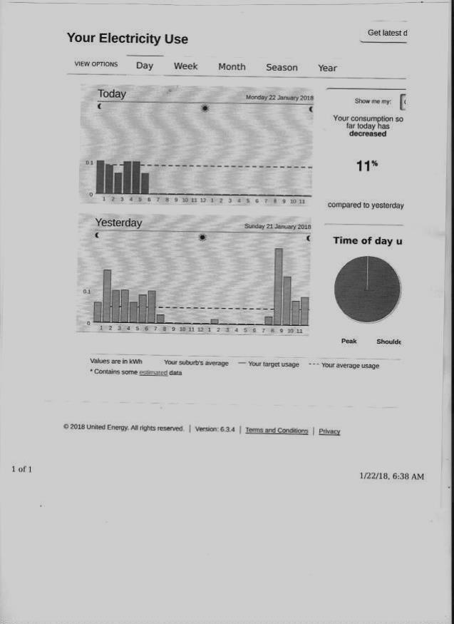

[quote]I don't understand how so many other people can have such low consumption as that they say. Maybe being out all day has a lot to do with it but working from home does bump up the power you use I suppose. [/quote]
I cut my consumption by more than half by simply doing a power audit, and replacing inefficient appliances with something better. Out with the old fridge, my CRT computer monitor, and all my 60 watt fluorescent tubes.
I modified other things such as my garage door opener, and tumble dryer (which is now heated by natural gas). I use gas for heating, hot water, and cooking.
And being retired I am home all day. Here are the numbers from my smart meter right up to this very minute. About 100 watts at night typical, and almost nothing during the day. If its cloudy sometimes just a tiny bit during the day like yesterday.
At this time of year its about 50 watts average per day {1.2Kwh)
Cheers,  Tony.
