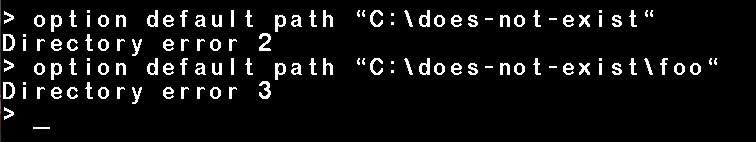

3. OPTION DEFAULT PATH error handling would benefit from improvement:

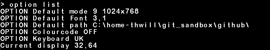

4. OPTION LIST uses an exciting mixture of cases :

  Quote  OPTION DEFAULT PATH error handling would benefit from improvement:
Done
