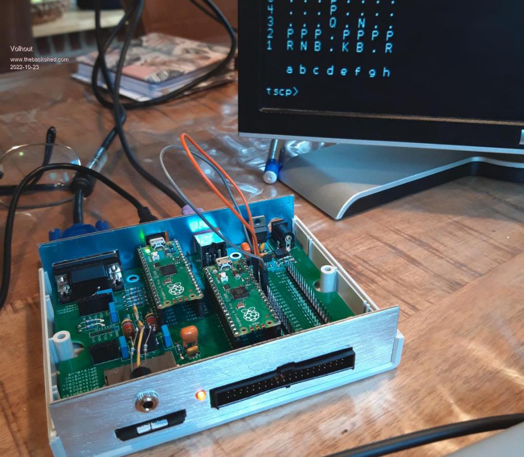

@Peter,
The basis is working: 2 pico's (one with your chess engine, the other a VGA picomite) on the 1.7 board. On the 3'rd socket I have connected COM1 of the chess module to COM2 of the picomite.
I use a small terminal program to route COM2 on the picomite to the console.
'setup COM2 to communicate with chess module
SetPin gp5,gp4,COM2
Open "COM2:115200" As #1
'keyboard text to chess module
 a$=Inkey$
 If a$<>"" Then Print #1,a$;:Print a$;
 If a$=Chr$(13) Then Print
'feedback from chess module
 l=Loc(#1)
 If l>1 Then Print Input$(l,1);
Loop Until a$=Chr$(27) 'stop when <ESC>
The christmas project is to show the ASCII board (command "d") in graphics on the VGA screen, and provide a command interface for the player.
It plays fast.... reponse in seconds, versus minutes...
Thanks, and I'll post my progress on this thread.

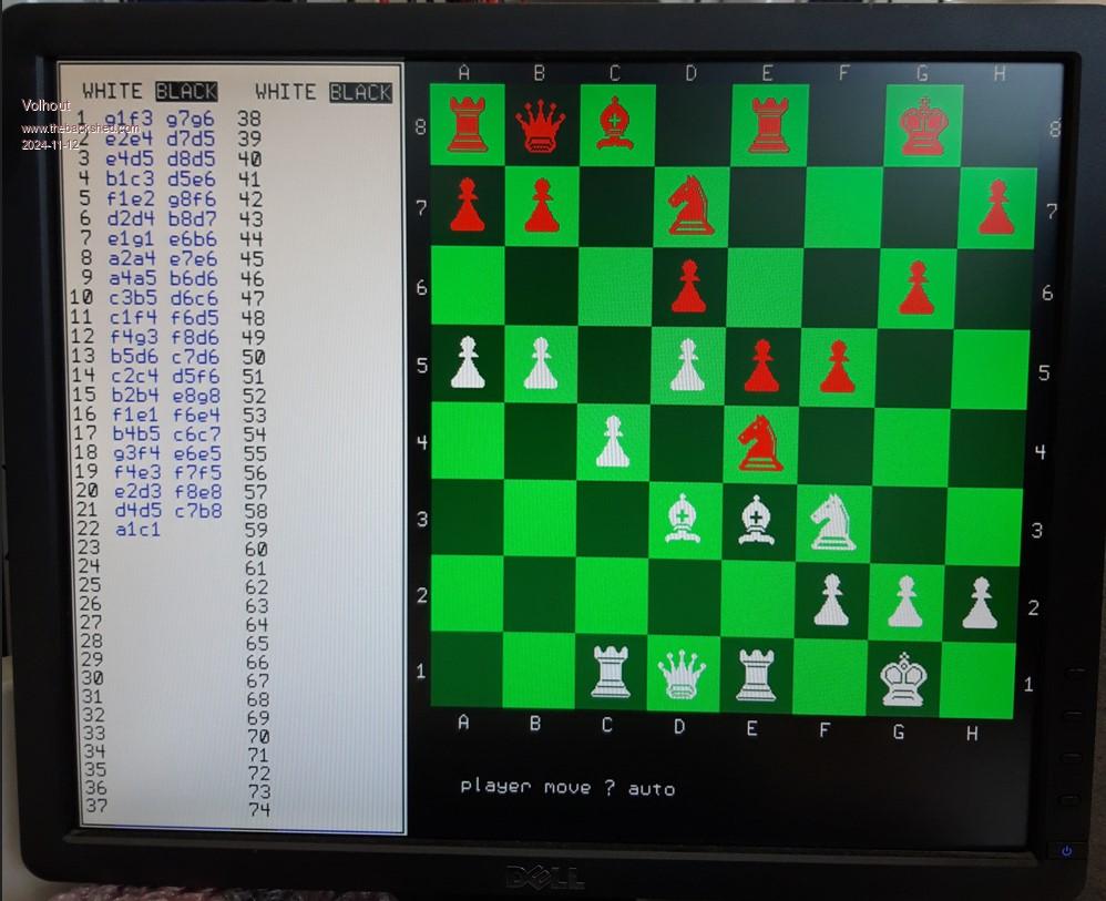

Kevin,
Finally picked up the dual pico chess project again.
It is far from finished, but can play a decent match already. Runs in 640x480 on the PRP2040 VGA.
The second pico runs Peters compiled TSCP (2 posts back). Its useds UART at GP0/GP1, and is wired to the UART on the first pico at GP4/GP5. Since this TSCP pico is very sensitive to typing errors I pre-process every command in the first pico.
In auto mode it plays itself.
Edited 2024-11-12 19:45 by Volhout

Posts: 6184
Posted: 06:48am 13 Nov 2024
Peter,
The earlier code does not echo.
When I get home this weekend I will have access to a pico2 again. I will try it.
500 MHz…?
But honestly, the earlier version was pretty fast already, a 70 move game lasted 2 minutes, that is 1,7 seconds per 2 moves (black and white). I may have trouble keeping up with displaying the board, which is quite clumsy currently, because the sprites are smaller than shown.
