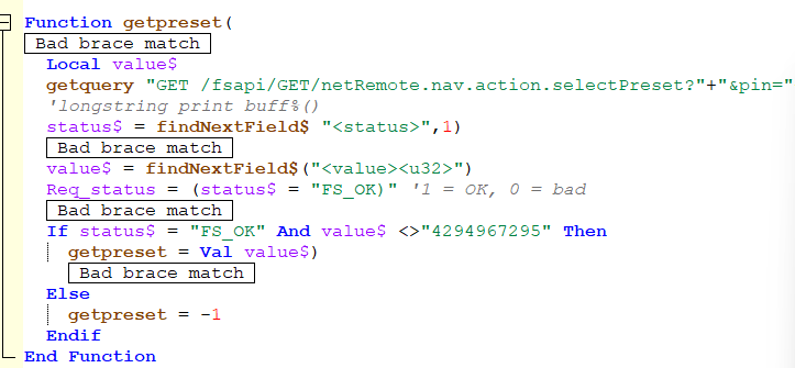

MMEdit V5.2.8 has been uploaded to my website.
I have tidied up the matching brace/bracket code.
When you enter the opening bracket '(', the matching closing bracket is added and the cursor between the brackets.
This only happens for '(' and not the other pairs '{}', '[]' and '<>'
You can turn this behavior off in Preferences.
When you place the cursor beside a brace of any kind it's match is highlighted. I chose red because I think it stands out the most but you can edit the inf file if you want a different colour.
When you leave a line, the while line is checked for '()' pairs that are not in strings or comments and advises you if there is a miss-match. The other styles of braces are not checked.
This check is also done when 'formatting' the code.

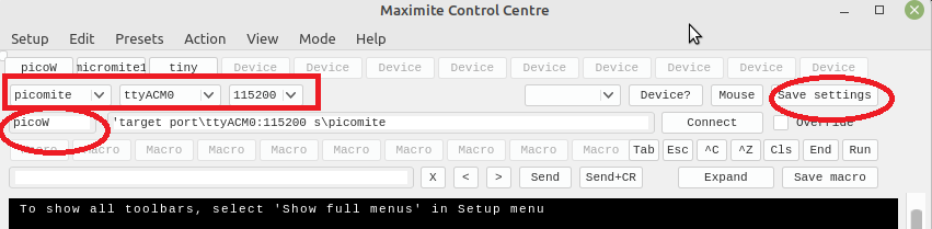

Posted: 08:01am 25 Apr 2024
To set a default device.
Start with showing full menus (first item in setup)
set the type, port and speed.
Give it a name
Save settings.
You can now go back to short menus if desired.
I usually have MMCC open and connected before I send uploads to it but that shouldn't matter.

I have done such, and have stored only 1 device, the PicoVGA.
Then I return to the short menu's.
When I close MMCC and re-open, it uses /dev/ttyACM0 and 115200 baud. But it is still uses Maximite. (Not PicoVGA). And this is already existing from earlier versions. I change Maximite to PicoMite manually every time, otherwise the file manager will not work correctly.

In MMCC
The Setup menu has the option to set terminal size.
If you change it to 100x40 that will save you changing it every time.
You could also choose a larger font size and that will also make the window larger.
You will still have the problem when programs automatically change the terminal size but then choosing "default terminal size will restore it to your setting.
I will try and work out why your system isn't saving the device type. It works here in my virtual machine.
Can you send me a copy of your MMCC.inf file? It should help me sort it out.

Thanks for the file.
It all looks OK and you should be seeing the picoVGA when you restart.
There were a few 'mistakes' introduced when the short menus were added.
I have made a few changes which will help when presets are not set.
The Linux version lists ttyACM before ttyUSB now so the default will be ttyACM0
This suits most new users.
The default speed will be 115200 to keep away from 1200 accidents.
The default new system device will be picomite. There is no difference between picomite and picoVGA as far as MMCC is concerned.
Now, when you restart the last used setting will (hopefully) reappear.
I will update the main download tomorrow.
