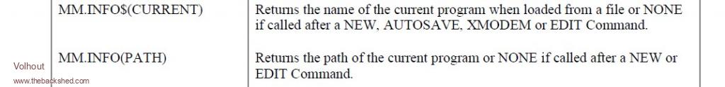

Hi Geoff,
I suggested this before, but there is an inconsistency in MM.INFO.
Some line use MM.INFO(xxx) and some use MM.INFO$(xxx). And this is not related to the response type (string or number or boolean) as in below example (both respond with a string).
And you can absolutely use either (MM.INFO and MM.INFO$) for every line I checked. Maybe the $ should be omitted -or- the use of the $ should have a relation to the response type.
In latter case, following need the $ added:
SYSTEM I2C
OPTION option
IP ADDRESS
PATH
Edited 2024-12-10 22:35 by Volhout
Posts: 3369
Posted: 12:43pm 10 Dec 2024
You are quite right, MM.INFO$ should be used when a string is returned,
I will fix it.
